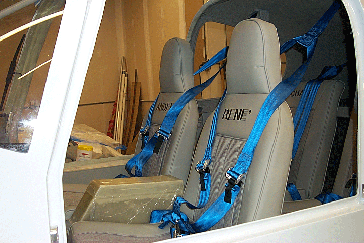

PostPosted: Mon Dec 01, 2008 7:26 pm    Post subject: Seat Belts Reply with quote
" I like 5 point harnesses when the shoulder straps are not mounted to an
inertia reel. "
I went with inertia reels and removed the 5 point from the back seat...see
attached picture.
http://www.inertialbelts.com/
I know...not much help with what you are asking, but I do like my belts.
Rene'
