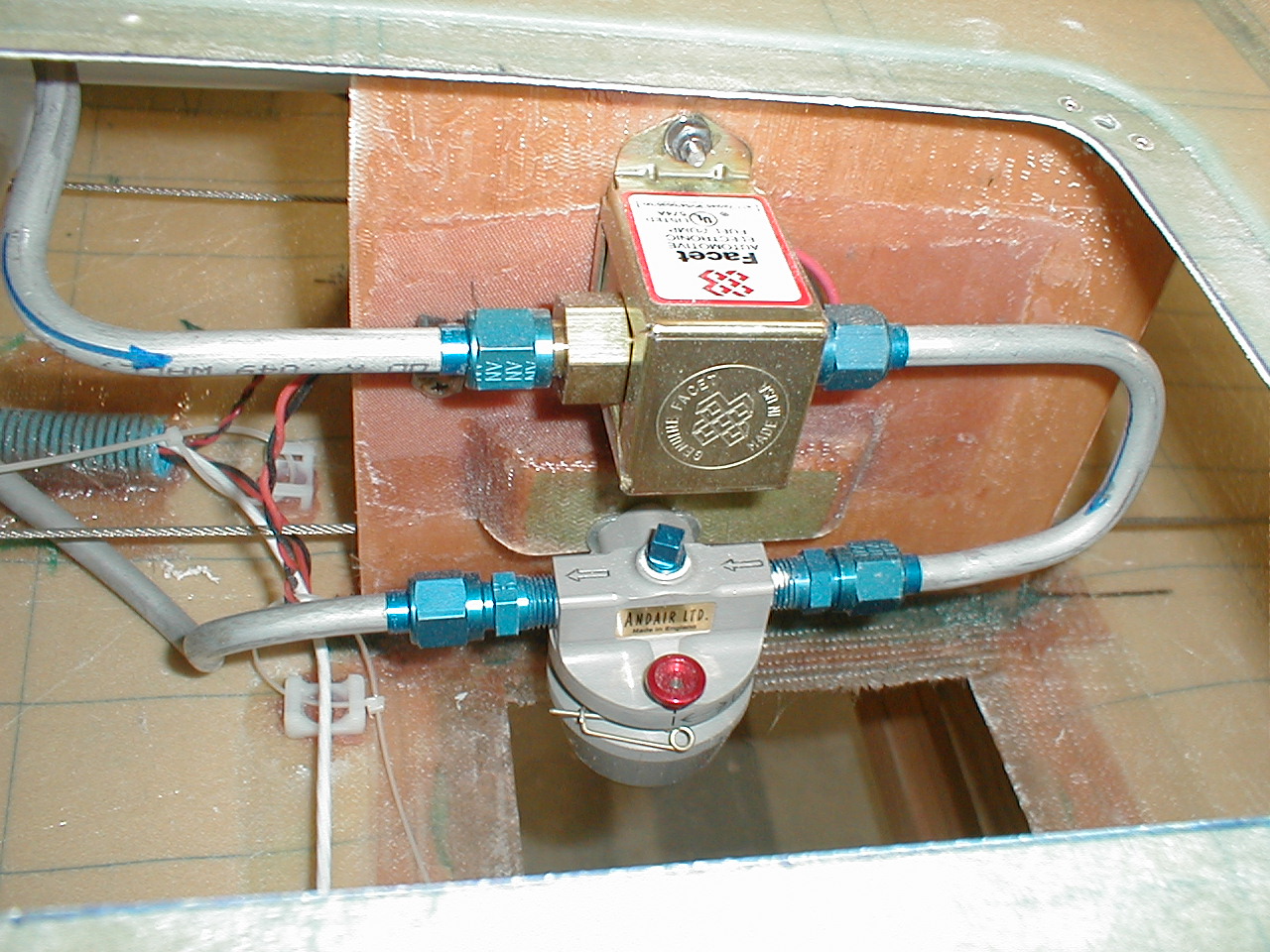

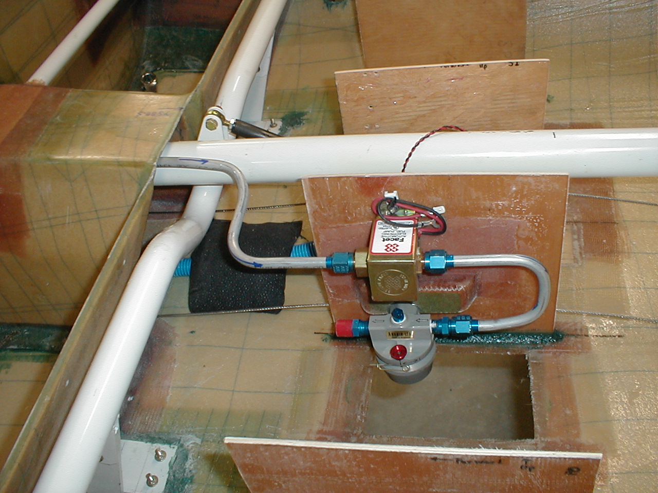

DuaneFamly(at)aol.com Guest
Posted: Sun Oct 26, 2008 4:33 pm Post subject: fuel pump etc |
This is what I did.....
A Good00075x1211625659x1200715650/aol?redir=http://www.freecreditreport.com/pm/default.aspx?sc=668072&hmpgID=82&bcd=emailfooter"> See yours in just 2 easy steps!
| | - The Matronics Europa-List Email Forum - | | | Use the List Feature Navigator to browse the many List utilities available such as the Email Subscriptions page, Archive Search & Download, 7-Day Browse, Chat, FAQ, Photoshare, and much more:
http://www.matronics.com/Navigator?Europa-List |

At 2008-10-26 20:29 -0400 DuaneFamly(at)aol.com wrote:
| Quote: | This is what I did.....
Mike - thanks for the nice pictures. The layout looks neat ....
But shouldn't the gascolator be ahead of the fuel pump in the sequence?
And all the advice I've seen is that the pump wants to be mounted at
45 degrees, or at least have its inlet lower than its outlet.
regards
Rowland

ptag.dev(at)tiscali.co.uk Guest
Posted: Mon Nov 03, 2008 1:55 am Post subject: fuel pump etc |
Hi! Rowland
Don't know about "ahead" of fuel pump for gascolator. But IMHO in
direction of flow terms the gascolator needs to be between tank and pump
(Of course in this context "ahead" may be the same). The last thing you
need in the pump is unfiltered fuel.
Bob H G-PTAG

Rowland_Carson
Joined: 04 Jul 2008 Posts: 155 Location: Cheltenham, England
Posted: Tue Nov 04, 2008 3:54 pm Post subject: fuel pump etc |
At 2008-11-04 02:42 -0800 Greg Fuchs wrote:
| Quote: | If anyone has produced a table, or schematic, or drawing of
all the different fittings sizes, and where they were used, it would be oh
so most helpful to me
Greg - here's the list I have prepared so far, for a 912S installation.
Port outlet, tank fitting A, side 1/4" NPT
AN822-6D elbow
AN819-6D sleeve & AN818-6D nut
3/8" OD aluminium tube
AN822-6D elbow
FS20x7F Andair left inlet
Starboard outlet, tank fitting B, side 1/4" NPT
AN822-6D elbow
AN822-6D elbow
FS20x7F Andair right inlet
FS20x7F Andair bottom outlet
GAS375 Andair gascolator inlet
GAS375 Andair gascolator drain
DV125 Andair drain valve
GAS375 Andair gascolator primer port
NP125 Andair 1/8" NPT plug (AN913-1D)
GAS375 Andair gascolator outlet
AN6 to 1/8" NPT straight or elbow?
Fuel pump inlet
Fuel pump outlet
AN6 to 1/8"NPT straight or elbow
AN832-6D bulkhead union & AN924-6D nut
101-06 aluminium hose-end straight
100-06 SS braided nitrile hose
Engine-driven pump inlet - 8mm - Speedflow hose finisher clamp
Engine-driven pump outlet - 6mm - what? - to carbs
Carbs fuel return through restrictor + 6mm adaptor?
AN823-6D elbow
Vent, tank fitting C, side 1/4" NPT
Port outlet, tank fitting A, end 1/8" NPT
AN914-1D elbow
Starboard outlet, tank fitting B, end 1/8" NPT
AN914-1D elbow
Andair drain valve
Port outlet, tank fitting A, side 1/8" NPT
AN842-4D elbow
Restrictor
TU23RM 6mm polyurethane sight tube
AN838-4D bulkhead elbow & AN924-4D nut
Filler moulding top end
Vent, tank fitting C, end 1/4" NPT
AN823-6D elbow
AN833-6D elbow & AN924-6D nut
AN833-4D elbow & AN924-4D nut
AN819-4D sleeve & AN818-4D nut
1/4" OD aluminium tube to atmosphere
This is still subject to editing in the light of experience - but I
hope it will be of some use.
Note that I am planning to leave out the factory-supplied glass
filters which are intended to be fitted upstream of the selector. My
thinking is that the filter area in the Andair gascolator is so much
bigger than the factory ones, and it will be so much easier to check,
that having 1 filter instead of 2 will not increase risk of fuel
starvation significantly.
I am also planning to modify Graham Singleton's sight gauge
modification, by taking the upper end to the filler moulding instead
of the top tank vent. I've heard reports of fuel coming back down
from the vent when the tank is filled and causing airlocks in the
sight gauge.
BTW, apologies for my late responses to the original replies to my
posting. The Matronics list server suddenly decided to reject my
messages, thanks to a badly-configured spam filter, and it was
several days before i could get through again.
regards
Rowland
