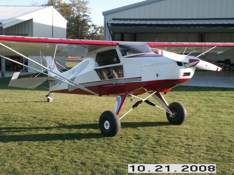

Do you have a part number? Is it a 3and a 1/8 inch? UMA redid this one and it works sort of,, well it dies at 750 RPM but any thing above that works great. Flew it yesterday for the first time.
