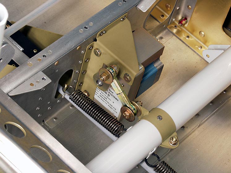

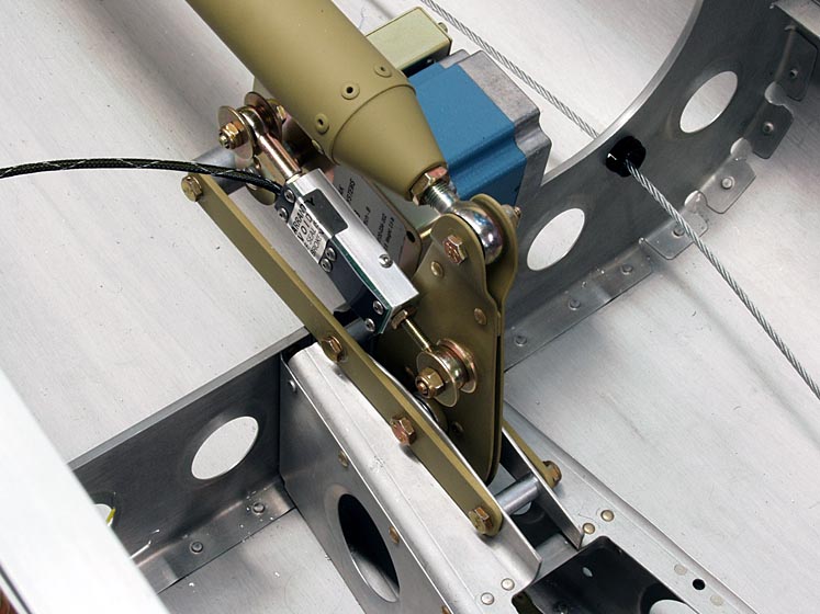

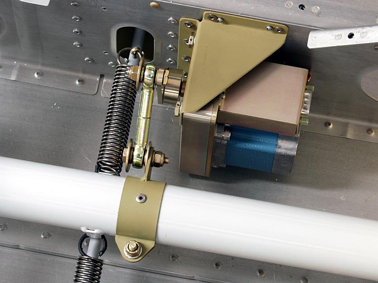

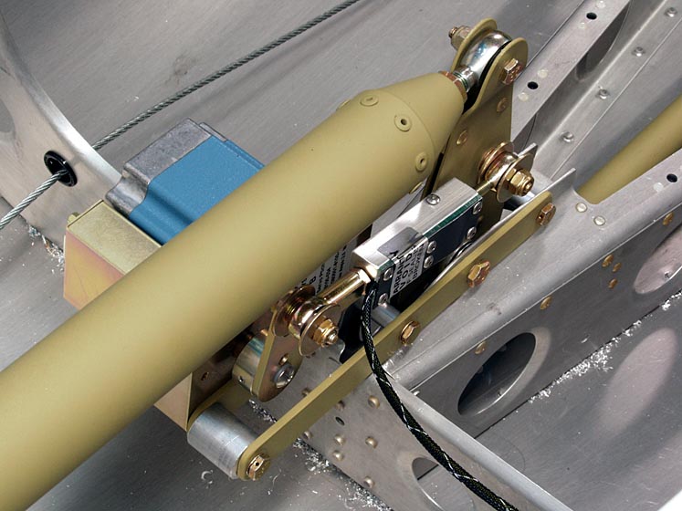

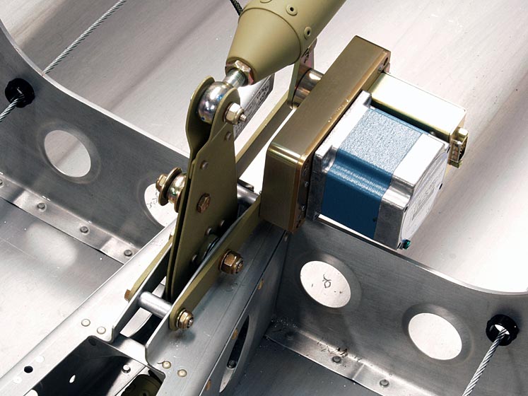

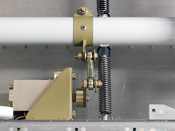

Based on feedback from the List, I made some minor modifications to the TruTrak servo installation for both the Pitch and Roll axis, primarily having to do with making sure that there was at least a thread or two sticking outside the nylon insert side of the lock nuts. I also removed one of the fender washers from the Roll servo on the arm side which pushed the alignment of the pushrod to nearly perfectly perpendicular to the control column horn.

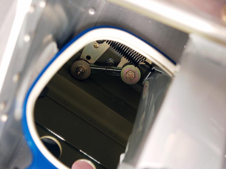

I also installed the front seat pan skin and put all of my weight on it and the grabbed a picture using a mirror. There is a good 1/8" of clearance with full weight applied AND full right stick applied which puts the arm at the high point. There was no interference with any of the stiffeners on the underside of the seat pan fortunately.
Thanks for all the great feedback!
Matt

Also, Matt, what's that gizmo attached to your pitch servo? I have a TT
system as well, but don't have that rectangular thing with a wire for my
control arm ...
-- Don
N8RV
