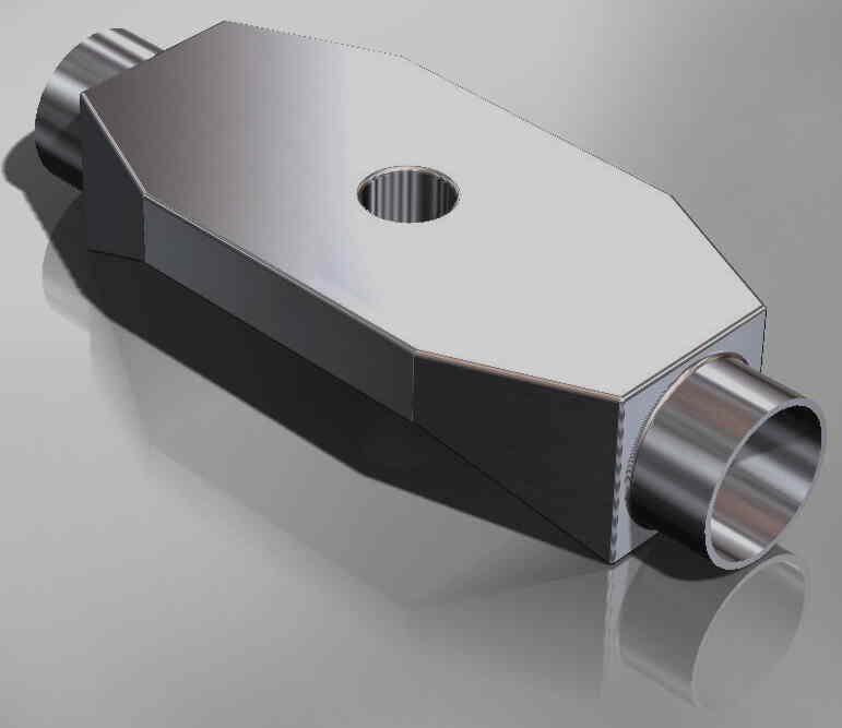

On Wed, Oct 8, 2008 at 1:27 PM, Don McDonald <building_partner(at)yahoo.com> wrote:
OK, guys, this is Don, the harness and headset bracket guy.... anyone
interested in the perfect solution to this problem. My brother is designing
and then will make a plenim type system that will slip right over the fuel
selector valve on both sides, then convert back to the 2" round to match up
to the scat tubing. The total area will be slightly more than the original
scat.... not counting if you do it like Van's suggest, and smash it. A
little rubber on the bottom and top, and it will be held perfectly in
place. Just let me know how many would be interested. Will have pictures
of a completed part within a week or so.
Don

OK guys here it is. Still not sure of the cost/price. It has about 40 minutes of welding, not counting any time for shearing, and the brake work. Definitely over $50, but certainly under $100. We'll do the best we can..promise.. but boy is that a nice piece!
If we get one done, I'll bring it to Copperstate.
Don McDonald
If interested make sure I get your mailing address.
and..... I'm so sorry if the file is too big.... get a bigger computer. I did compress it.

Whew, that much welding and throwing in bending for under $100 out the door!?! I need to get me some of the fabricators you have access to for that price!

The price is smokin if anyone knows what this type of work costs...I can't use it though, I used the standard Andair mounted to the top of the tunnel with braided lines run to one side of the tunnel and the scat run to the other side. If it is designed to use the standard Vans CRAPPO valve, (I know some love that boiler equipment) or the Andair with the handle extension it looks like the way to go...

Do you have a drawing showing how the fuel valve fits into the picture?
Does this require the Andair valve or the standard valve or either?
If it's the andair valve, I can see that the stem fits through the hole
and I think with some shielding you can keep the heat off the valve,
BUT you're probably going to want to wrap the whole plenum in the
reflective insulation. If it's for the standard valve I can't see
exactly how the heat is kept away. I found a significant amount of
heat is spread to the seat area through the tunnel when the rear
heat was turned on...and that it was significantly lessened once I
wrapped completely my SCAT tubing and the aluminum T's with the
reflective insulation. So having an aluminum plenum might make it
easy to direct airflow, but it may become a very large heat box
to heat the fuel valve and tunnel unless the builder takes the
precaution to insulate the plenum.
I know personally that the whole tunnel top will get pretty warm
with the rear heat on with an uninsulated SCAT tube. I also know
that from talking to a couple other builders with lots of hours
on their planes like I have, that during extended climbs there is
some sort of issue going on with the fuel system...probably vapor
in the system, that causes reduced fuel pressure. Climbs of
maybe 6000' or more. I haven't figured out if this is on the
forward side of the firewall, or the aft, but keeping the entire
fuel system as cool as possible is an important thing. Just would
like to get an idea how this fits around the valve, to know if
it has any need for added heat shielding.
