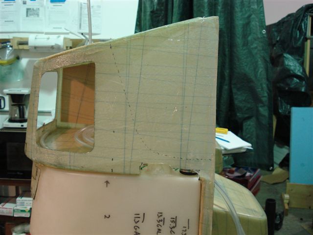

When I was marking the cockpit module for cutting a long time ago, it seemed
like the scribe lines at the sides of the module (near the back end) went up
in an angled, circular fashion as seen in the picture. I assume that most
people cut the scribe line parallel to the (already cut)opening. Did anyone
see it like I did, and cut the way I have it marked? An advantage of cutting
it that way would be that it would give more surface area for the glue to
hold the CP module to the fuselage, in that area.
Greg

Hi Greg
I didn’t bother cutting it down at all, A good clean up and a dose of redux gives a substantial increase in body strength right beside the main Tri-Gear legs,
But then that is probably why my Europa is heavy!Smile
regards
Ivor

Greg,
I went back to my build site to refresh my memory on how I trimmed
that part of the CM.
Year #2, Q4 2003, pics 6 & 7 show the CM ready to bond in place. You
can get a good idea how I trimmed my CM there.
You certainly can trim it as you indicate and provide additional
bonding area and strength, but understand that it will be at a weight
penalty.

Thanks Ivor,
It is good to know that it won't get in the way of anything (or be too
thick). It leaves all of the options on the table.
I too, like the idea of strengthening that area a bit.
How heavy did your Europa come in at?
What would you attribute most of the extra weight to?
~Greg

Bob,
Thanks for the picture reference. It looks like you followed the text
religiously. I can swear that my (almost imperceptible) scribe line follows
the dotted line in my picture. Well, based on everyone's responses, it
appears that the sky is the limit on the cutting. Though any will work, I
think I will choose a hybrid. Not quite like the manual, and not quite no
cutting at all. A little increase in strength in this area couldn't hurt too
much, especially to support the future bed......and sink.
