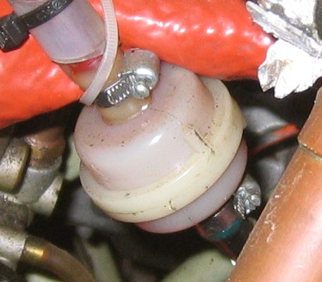

Ok - showing my ignorance here...

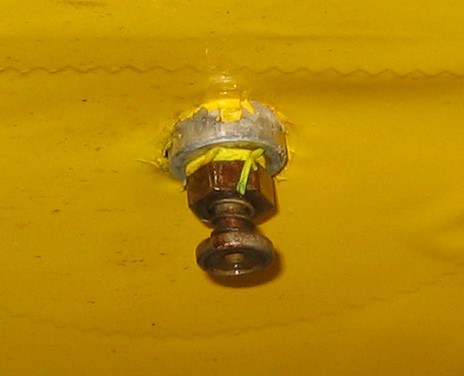

The first picture is of the fuel drain for the wing tank which tends to leak and needs replacing. I got as far as http://www.aircraftspruce.com/catalog/appages/safair.php but the CAV-110, 160, 170, and 180 all look a lot like it. I know what an NPT thread is but where is the 1/4" or 1/8" measurement taken? Or the other measurements?
Second picture is my fuel filter. Any suggestions on a replacement? Advance Auto Parts or Manny Moe &Jack ok?

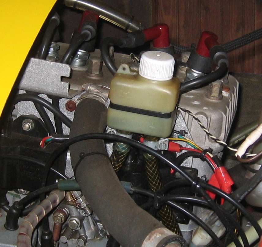

Third picture is the whats-it. Obviously a reservoir with some sort of lubricant which hasn't gone down since I have owned the plane. Obviously something I need to know about and service.

The measurement won't mean a lot to a person new to pipe threads.
The easiest way to become familiar with the various sizes of NPT
threads is to visit the hardware store and buy one each of 1/8, 1/4,
3/8 and 1/2...you won't use the 1/2 or 3/8 much in our aircraft, I
hope, except for the header tank, I think...take 'em home, and
compare the sizes to what you need to order. That's cheating, but
it'll get you to recognize the various sizes. Oh, yeah, get males and
females as well. Some places have a label wrapped around the part, so
I'd leave them right on the part until you learn to just spot the
size from experience. Eventually you'll use the samples fixing the
ol' house up. : )
measurements?

You remove the fuel drain to measure it. The size refers to the part that screws into the bottom of your tank.
I don’t use any “filters” on my fuel supply they are too easy to block. I use finger strainers in the tanks ( no sloshing compound to come free) and a gascolator with a fuel screen.. I drip my gascolator before every flight and clean it every 25 hr. 50 hr. Would be ok. My father had a much larger engine in his C170B/LA-4 and they only got cleaned on the annual.
The other little reservoir is for the water pump/rotary valve shaft. If you haven’t noticed it going down then all is well. If the oil in it turns milky your RV shaft seal is toast. There are specific instructions for bleeding the injector pump and the RV shaft in the Rotax Manuals available from http://www.rotax-owner.com/  Check the tabs for engine manuals and download your manual in pdf format for your engine.

I like NAPA 3095 for just ahead of the fuel pump on my 912S. I also use 2 NAPA 3011 filters at the exits of each wing tank.
I don’t know if these work for your tubing.
As far as the fittings. I think that that is a 1/8 “ fitting. You measure the inside of the pipe, but that is largely irrelevant because that depends upon the wall thickness. Get a 1/8 “ fitting and compare them to be sure.
I am waiting to learn what your reservoir is.

The fuel tank drains (at least the ones I’ve taken apart in the last 40 years) have a small “O” ring on them that is under constant compression. That “O” ring is notorious for deforming, especially if they have are made of nitrile or buna rubber and exposed to auto gas. I buy replacement “O” rings made of viton at a gasket supply house for about 10 cents each and just replace them rather than buying new drains. The viton materiel resists the effects of auto gas better than any other material I have tried. It’s a lot less expensive.

I didn't see your original post but the (Whatsit) sounds like the oil reservoir for your Rotary Valve lubrication.
Is it the small plastic bottle mounted on the aluminum angle above your CDI units?
If so this is a circulating lube system supplying a flow of oil to the rotary valve. If everything is in good order you shouldn't see the level drop. Also the cap has a rubber seal in it wit a small slit cut to allow pressure relief. Make sure you never replace this with a full seal as it will cause you some real pain.
I used to just take out the oil from the reservoir with a syringe about every 50 hrs and replace it - probably overkill but for a couple of ounces of two stroke oil I figured it was cheap insurance.

My brain must be rusting out!!! I completely forgot about the O-rings in the drip valves. Butyl rings may work better now that there is ethanol in a lot of the fuel. I think the butyl is supposed to be more resistant to the ravages of ethanol.

NPT - National Pipe Thread uses nominal dimensions based in ID of the fittings.

Mine had the # 110 on the end of the drain.

The drains in my plane are 18 years old now, and besides the slight leaks they're just not PRETTY anymore Wink
I will consider replacing parts, especially in the expensive gascolator, periodically once I put in some spanking new ones. Also a good opportunity to replace hoses with ethanol-resistant ones, even my local Turkey Hill station is "blending" now. I spoke to the station owner and even he doesn't know what gets delivered each day - but he knows the mix depends *entirely* on the daily price of ethanol vs gas. With oil prices dropping (I paid $2.99 for regular just yesterday) I may start to see ethanol blending reduced. Ethanol prices are not as volatile (pun definitely intended) as gas.

Noel - "finger strainers"? Where does one get those? I had to throw out what I think you are talking about on the outlet of my wing tank - I foolishly sloshed with it in and the Kreem did a great job of sealing the whole thing water-tight. Live and learn.

PostPosted: Mon Oct 06, 2008 6:26 pm    Post subject: Fuel drain, fuel filter, and a whatsit Reply with quote
A number of replies agree that it is the supply of oil to the "rotary valve". So it takes normal 2 stroke oil? Mine is closer to the MIN mark than the MAX so I was thinking I should top it off.

PostPosted: Mon Oct 06, 2008 6:57 pm    Post subject: Fuel drain, fuel filter, and a whatsit Reply with quote
Yes Bob
The same 2 stroke oil that you run in your fuel mix (I used Pennzoil for air-cooled engines).
I don't think the level is that critical but I kept mine to the upper mark

Mine came in the plane. I expect you can get them through Aviall , Leavens (in Canada), Wicks Or even ACS. The reason I mentioned my tanks are not sloshed is because it has happened that sloshing compound has separated in the tank and blocked finger strainers.
Noel

PostPosted: Tue Oct 07, 2008 8:21 am    Post subject: Fuel drain, fuel filter, and a whatsit Reply with quote
Try to keep it above the min. The idea of syringing it out every once in a while and replacing with new oil is a good one. Somewhere I read you should use the same oil as what is in your main reservoir but I know of at least one guy who uses a different 2 stroke oil that is easier to see in the small reservoir.

matronics(at)bob.brennan.
PostPosted: Tue Oct 07, 2008 8:29 am    Post subject: Fuel drain, fuel filter, and a whatsit Reply with quote
My wing tank is simply for reserve, so a blocked strainer is much better than letting objects go further into the system. I replaced the tubing from the wing tank with clear so I can see the flow when on turn the petcock. My procedure is that when the Reserve warning light comes on (1.5 gals / 45 mins remaining in the main tank) or before if I notice, I dump the 6 gallon wing tank into the main. Doing that with any more than 4 gallons in the main tank is a "bad idea" since it only holds 9.45 gals...
I found "finger strainers" on ACS and have ordered, thanks for the input Noel.
