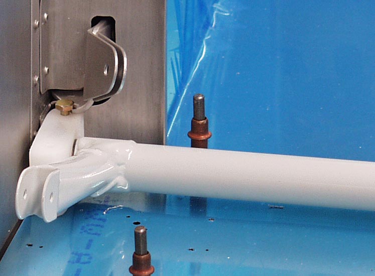

Dear Listers,
Have a look at the attached photo. The rear predrilled holes for
mounting the flap weldment nylon blocks seems to interfere with the
seatbelt attachment. Am I missing something here? The blocks are
drilled according to the plans and the rear holes are already drilled
and have the platenut installed. Do I just added some washers above
and below and call it good? Seems hokey. Notching the belt attach
also seems like a poor idea.

No washers.
You may need to trim the nylon block corners a little to get a more snug fit
into the corner so that you clear the seatbelt attachment.
