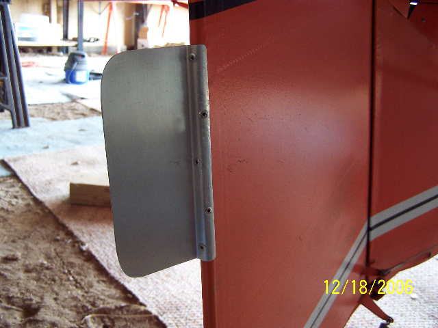

Michel, from personal experience with a rudder trim tab that is set for hands/feet of in a cruise condition exhibits no need for "other foot" correction in descent. I am not sure how to explain the phenomon but maybe it has to do with or the absence of swirling currents off the propeller.
John

PostPosted: Mon Aug 25, 2008 1:49 pm    Post subject: Rudder Trim Tab Reply with quote
If you think a bit about the need for right rudder, which is to
compensate for the left-turning tendency under precession and torque
reaction, and then think about there being no torque, and no
precession during slow flight, I think you'll see there is no need
for the "other foot" correction. Of course, I'm talking about a
clockwise-turning (as seen from the pilots' point of view) engine.
Lynn Matteson
Kitfox IV Speedster
Jabiru 2200, 562 hrs and holding for repairs
Status: "Condition grounded, but determined to try." (Pink
Floyd..."Learning to Fly")
John

PostPosted: Wed Aug 27, 2008 10:38 am    Post subject: Rudder Trim Tab Reply with quote
Lynn and John, I am not sure I understand that about the rudder trim tab. If it corrects for the prop under WOT, then it must induce yaw in the other direction at idle, rigth? Did I miss something?
Anyway, I think I'll do like Gary; I'll use a balsa wedge under the left flaperon.

Lynn Matteson
Posts: 2778
PostPosted: Wed Aug 27, 2008 11:14 am    Post subject: Rudder Trim Tab Reply with quote
It always corrects in the same direction regardless of throttle
position...that is, fast engine speed or idle. If you stick your hand
out the window of your car (are the docs letting you drive a car, by
the way? I was kept from driving for about 3 weeks, as I recall after
a 5-way bypass surgery in year 2000), it won't make any difference
how fast you go, the hand will always deflect up, if you hold it
slightly up, (or down, if you hold it down) no matter how fast you
go....except at really slow speeds, where the wind against it won't
make it change.
Think of a sail...NOW I'm talkin' your language....I'm no sailor, but
it seems if the sail is set to blow you in one direction in a strong
wind, and the wind dies down, you don't really change direction, do
you? That may not be a good example. Ok, try this....your rudder is
straight ahead (or behind, actually), and you stick something on one
side of it which catches the air. This will make it push the rudder
to the other side *slightly*....this is all you are doing with a
rudder, or any other "trim tab." That little tab that is attached to
the rudder, elevator, flap, or aileron, is taking the place of you
exerting a slight pressure on the control of that flight surface (the
rudder, elevator, flap, or aileron) and lets you remove your foot or
hand from that control. The more effort you had to exert to keep the
plane flying straight, level or yawed correctly, the larger the tab
surface needs to be, or it needs to be bent into the airstream more
to correct for larger errors in flight direction.
And don't forget....the attached tab, bent into the airstream will
only correct for one speed, or limited range of speeds...like say
75-85 knots,or 50-60 knots...and above or below that it corrects too
much, or not enough. That's the beauty of having an in-cockpit
adjustable trim tab...you can go a little faster or slower, and
compensate for any misalignment of flight direction with the trim tab.
And when I say "bent into the airstream" I mean maybe 5-10 degrees in
a trailing direction...the tail end of the tab will stick out into
the airstream, not the front of the tab. Look around your airport,
Michel, and you'll see lots of examples of trim tabs, some ground
adjustable some cockpit-controlled...some with mechanical linkages,
some with electrical servos.
Lynn Matteson

57_kid
Joined: 27 Aug 2006
Posts: 50
PostPosted: Wed Aug 27, 2008 11:58 am    Post subject: Rudder Trim Tab Reply with quote
Michael
while you are just flying along when you apply just a bit of rudder does the
heavy wing go away or do you still have to correct with the ailerons? just
curious because my model 5 had the same problem and no matter what I did it
would not straighten out UNTIL I installed the rudder trim tab, once that
was adjusted for the yaw correction everything was fine ..
just another opinion
Steve

The tab...unless it is adjustable from the cockpit...won't compensate
for any in-flight abnormalities (read: changes of speed or throttle
setting) besides the one speed that it is set for. Let me give you an
example of what I encountered, and what I did to take care of it: My
plane wanted to drift to the left, so I installed a tab on the
rudder, with the deflection of the tab going to the left. When the
air hits the left-bent tab, it pushes it to the right, and this in
turn pushes the rudder to the right. When the rudder goes *slightly*
right due to this tab-induced deflection, the plane goes slightly
right and compensates for the here-to-fore normal left turning
tendency. Because my tab was a ground-adjustable tab, I had to fly at
x-speed, sense the turning of the plane, land and adjust the tab, fly
again at x-speed and see if I did any good, or if I'd have to land
and adjust it again. I did this a couple of times, and finally got
it, but it was only good for that one x-speed, give or take a few
miles per hour. That's why it is best to have a cockpit adjustable
tab, so that at whatever speed you choose to fly, you can control any
tendency that the plane has *at that speed*. If you change speed, you
will have to change the trim tab setting as well....within reason.
When you say "a rudder trim tab would be self-adjusting to different
air speed", I don't think we're talking about the same type of trim
tab. The tab that I use, pictured, is fixed, and the only self-
adjusting that it does is if the plane goes slower, the tab is less
effective, so I'm guessing that's what you mean?
