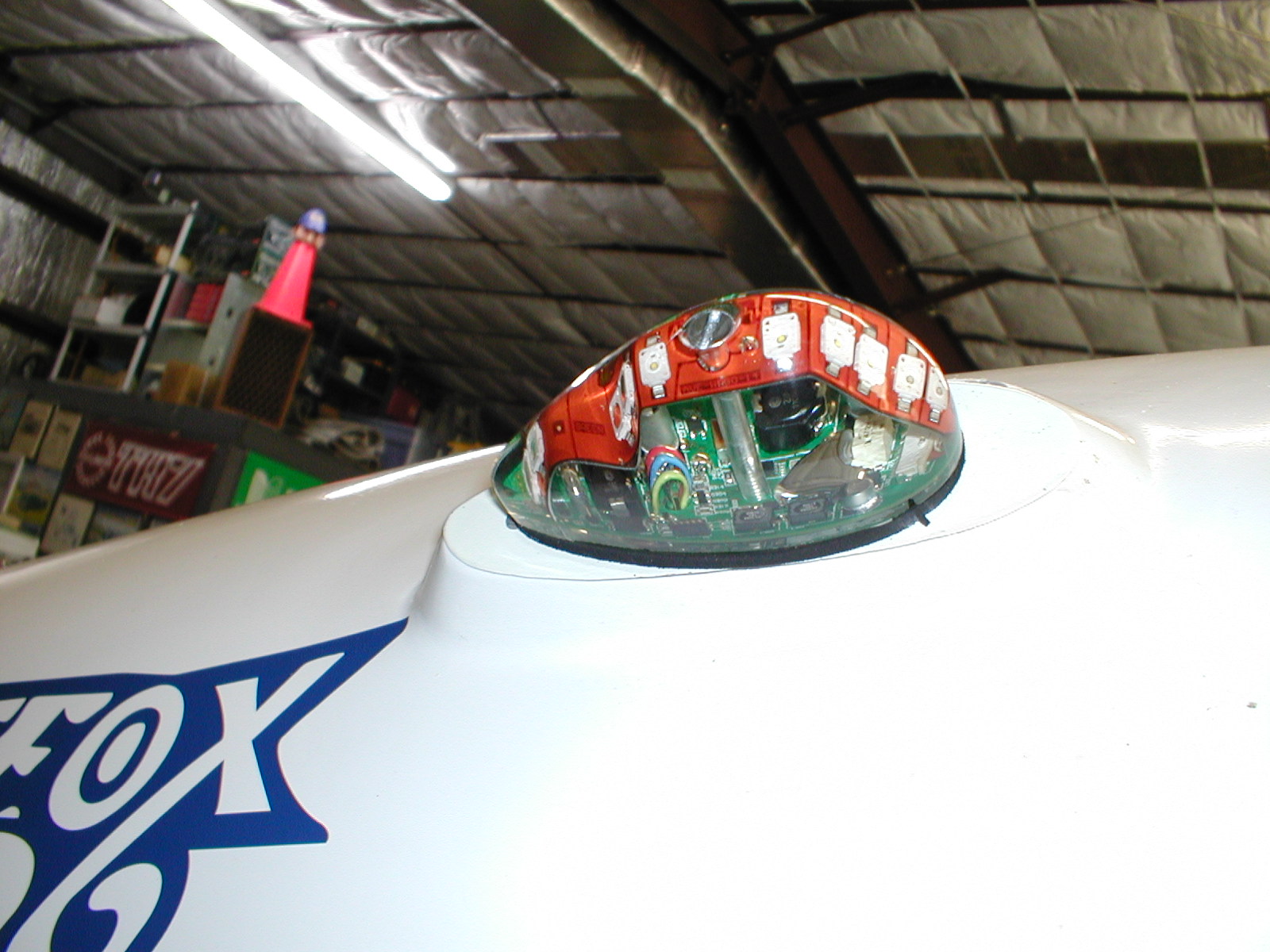

Well, I installed my strobes today and am very happy with them!
I got rid of the power pack, wiring and lights and saved myself almost 4 lbs. The biggest benefit is the power draw. These buggers only draw 250 milliamps for the pair !! Now that is nothing!
If you want to read about these go to http://kitplanesmag.blogspot.com Here's a picture. I could not capture the strobe flash although I tried. Are these neat looking or what. " The visible strobe"

PostPosted: Sun Aug 17, 2008 11:32 am    Post subject: Aveoflash strobe lights Reply with quote
Dick-
Try setting the film speed real slow...ASA 80 or lower, or try
setting the camera on manual and set it for maybe 1 or 2 seconds.
Then, using a tripod, make your shot without the on-camera flash...it
looks like you used flash in this shot...did you? Can you set the
flashing rate of those strobes?

PostPosted: Mon Aug 18, 2008 3:59 am    Post subject: Aveoflash strobe lights Reply with quote
Lynn-
I have a basic camera (handheld) with no tripod. Take a look at the Aug 1 Kitplanes blog site.They have a nice picture and a nice article. The strobes are adjustable for the flash pattern.
