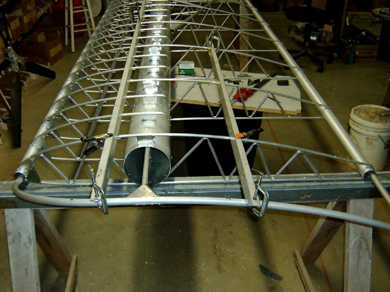

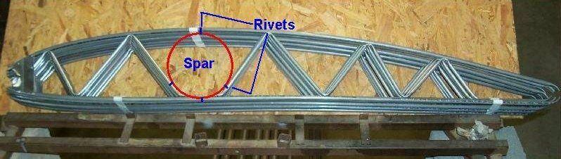

PostPosted: Fri Aug 08, 2008 2:06 pm    Post subject: Kolb Design Reply with quote
At 02:58 PM 8/8/2008, you wrote:
I agree with Homer. The old airfoil is appropriate for the old planes but with the lower drag of the xtra,
a wing drag reduction should be in the works.
I guess I had always thought that if I were to build another set of wings I would do some research in raising the leading edge tube an inch to an inch and half. By doing this I would think that you could decrease the wing incidence in flight with near the same lift. Making it a bit faster,,, moving the leading edge up would give it a profile more like the super cub. Anyone smarter than I know what effect it would have?
These ribs maybe more what he is talking about. Thinner & not flat bottomed.

PostPosted: Fri Aug 08, 2008 7:22 pm    Post subject: Kolb Design Reply with quote
Possums
That was the nose profile I was thinking about…. But the convex bottom was not in my mental snapshot.
