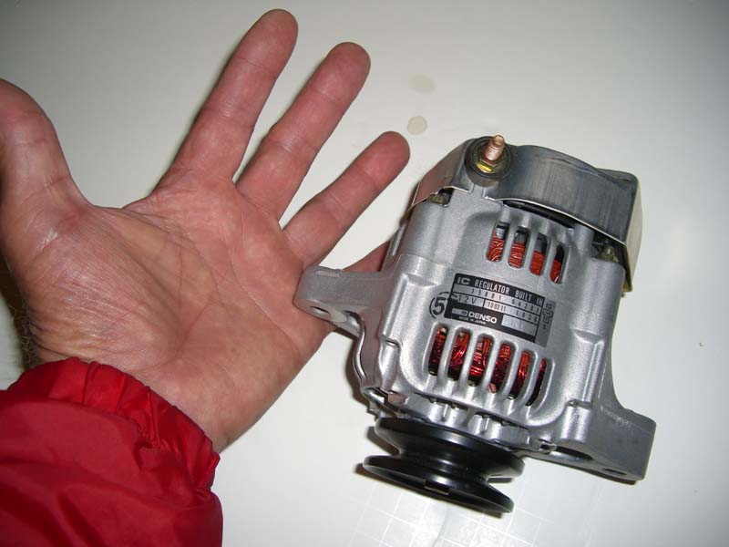

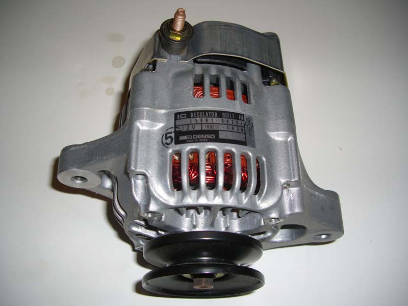

PostPosted: Sat Aug 02, 2008 9:19 am    Post subject: Alternator for NSI EA81 Reply with quote
Here are a couple pictures.  Neat alternator.

Clem Nichols
Posts: 88
Location: Munfordville, Ky
PostPosted: Sat Aug 02, 2008 10:53 am    Post subject: Alternator for NSI EA81 Reply with quote
Certainly a nice size, no question about that. The most obvious problem I see is that the alternator and water pump on the Subaru are run by two belts which obviously requires a double pulley, and the shaft on your alternator doesn't stick out far enough to accomodate a double pulley. Thanks anyway.
