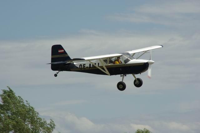

The S5 I helped build first flew a couple of hours a year or so ago - with another pilot - but then engine problems, work and life got in the way.
This week, all problems resolved, I flew it for the first time and yes, it was like a first solo. Exhilarating : Very Happy It has the 912S and Grove gear - see attachment.
I have no choice but to do the test flying (50 hours required here) from a narrow paved runway so I am a bit nervous about the ground behaviour. The plane tracks straight but is very sensitive to rudder pedal input and quickly develops a swing. The first landing was done with very tight spring tension in the springs between rudder and tail wheel and I felt this was just too direct to be safe. I've now put in an extra link and have some slack in the springs and chain link. It feels better but I will need a few more landings to become confident. It's a maule tail wheel by the way.

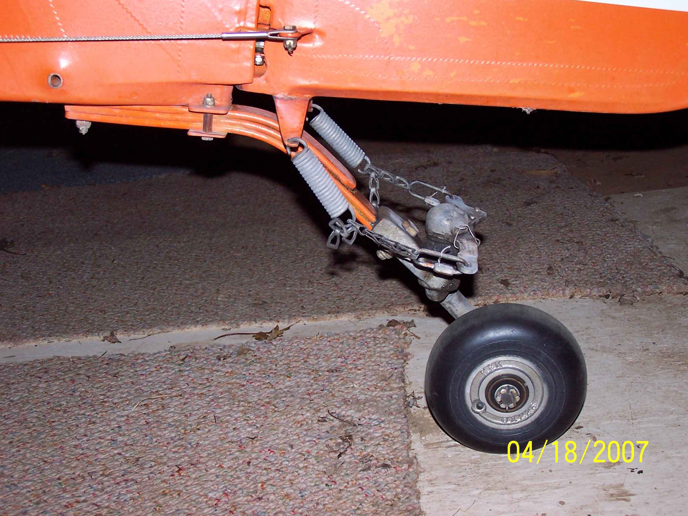

Any tips on tail wheel steering spring tension?

My total tail wheel time when I first flew my Kitfox was 20 hours dual instruction. My first flight was from a 150 foot wide runway and I used most of that width on take off. It is very easy to over control by inputing too much rudder. My prop turns left so the airplane went right when the tail came up, I pushed too much left rudder and swerved back accross the centerline.
The second flight I used a lot less width because I could anticipate how the plane would react and how much rudder to input.
About the first five hours I limited myself to flying in no wind conditions only. Not even wind aligned with the runway. Then I graduated to five mph with no cross wind then five mph cross wind etc.
To answer your question about tail wheel spring tension. My tail wheel is a Maul. The chains are adjusted just loose enough so that there is no tension on the springs but not loose enough that the chains sag. It handles really well.

Hi Tom and Pete, thanks for the input. It matches what I am experiencing. I have about 500 hours on tail draggers but the Kitfox, at least the way this one is configured, is the most directionally sensitive I have flown.
It has helped by putting a bit of slack into the spring and chain. This seems to allow some directional control with rudder before the tailwheel starts to become the main steering method (with tail on the ground).
I think I'm just used to a much looser/slacker tail wheel set up. The aeroplane actually tracks perfectly - it's only when I start the "tailwheel" tap dance that things get a bit lively.

PostPosted: Thu Jul 31, 2008 8:53 am    Post subject: First flight Reply with quote
Be careful with the slack springs. You need to bend them to make sure they
won't come loose. If they do come loose you will have NO control at slow
speed.

rjdaugh
Joined: 30 Aug 2006
Posts: 195
PostPosted: Thu Jul 31, 2008 5:38 pm    Post subject: First flight Reply with quote
Kerry,
First, Congratulations! And hang in there, be safe and have fun.
Also, what is it that appears to be hanging below your cockpit?
Randy
Series 5/ 7 firewall forward
912S WarpDrive taper tip.
Just passed 200 hours and it is a great plane.

PostPosted: Fri Aug 01, 2008 10:29 am    Post subject: First flight Reply with quote
A bit sloppy works well for me....see picture.

Lynn,
Is that a pneumatic tire?
Pete
Pete
Leander, TX
Kitfox III, 912ul, Grove
Lynn Matteson
Posts: 2778
PostPosted: Fri Aug 01, 2008 2:19 pm    Post subject: First flight Reply with quote
No, it's the Homebuilder's Special from Aircraft Spruce....it's soft,
measures about 6", and works quite well. Part #06-03600...about $30

PostPosted: Sat Aug 02, 2008 11:38 am    Post subject: Re: First flight Reply with quote
Randy
Hi Randy - that's a big venturi tube for the gyro driven direction indicator and artificial horizon.
And I am trying very hard to stay safe. Life`s too much fun to take the early exit. Kerry.

Hi Lynn,
That's about how my tail wheel springs now look and I am quite happy with it. We've wired up everything so the springs can't jump out etc.
I think it was just that I am used to giving big boot fulls of rudder in my Auster to stay straight and the kitfox needs just a little toe pressure to create a major change in direction.
Having the springs a bit loose brings it more back to what I am used to but I will report in again when I have a few more landings under my belt. The plane is wonderful in the air and the performance off the ground is terrific.

PostPosted: Sat Aug 02, 2008 11:52 am    Post subject: Re: First flight Reply with quote
speed.
Hi Pete, this is good advice. We've used lock wire to try and make sure the springs don't jump out of the eyelets. I was a bit worried about this but think the brakes are good enough to keep things under control should one chain or spring ever let go. But I'm open to suggestions on this and hope I haven't overlooked potential trouble... kerry.
