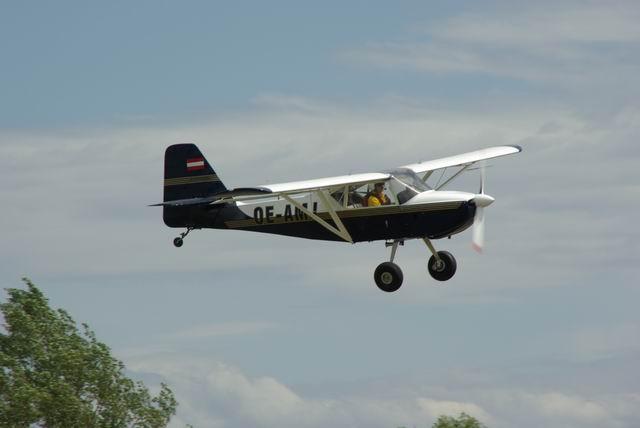

The S5 I helped build first flew a couple of hours a year or so ago - with another pilot - but then engine problems, work and life got in the way.
This week, all problems resolved, I flew it for the first time and yes, it was like a first solo. Exhilarating : It has the 912S and Grove gear - see attachment.
I have no choice but to do the test flying (50 hours required here) from a narrow paved runway so I am a bit nervous about the ground behaviour. The plane tracks straight but is very sensitive to rudder pedal input and quickly develops a swing. The first landing was done with very tight spring tension in the springs between rudder and tail wheel and I felt this was just too direct to be safe. I've now put in an extra link and have some slack in the springs and chain link. It feels better but I will need a few more landings to become confident. It's a maule tail wheel by the way.
Any tips on tail wheel steering spring tension?

Kerry,
First, Congratulations! And hang in there, be safe and have fun.
Also, what is it that appears to be hanging below your cockpit?
Randy
Hi Randy - that's a big venturi tube for the gyro driven direction indicator and artificial horizon.
And I am trying very hard to stay safe. Life`s too much fun to take the early exit. Kerry.
