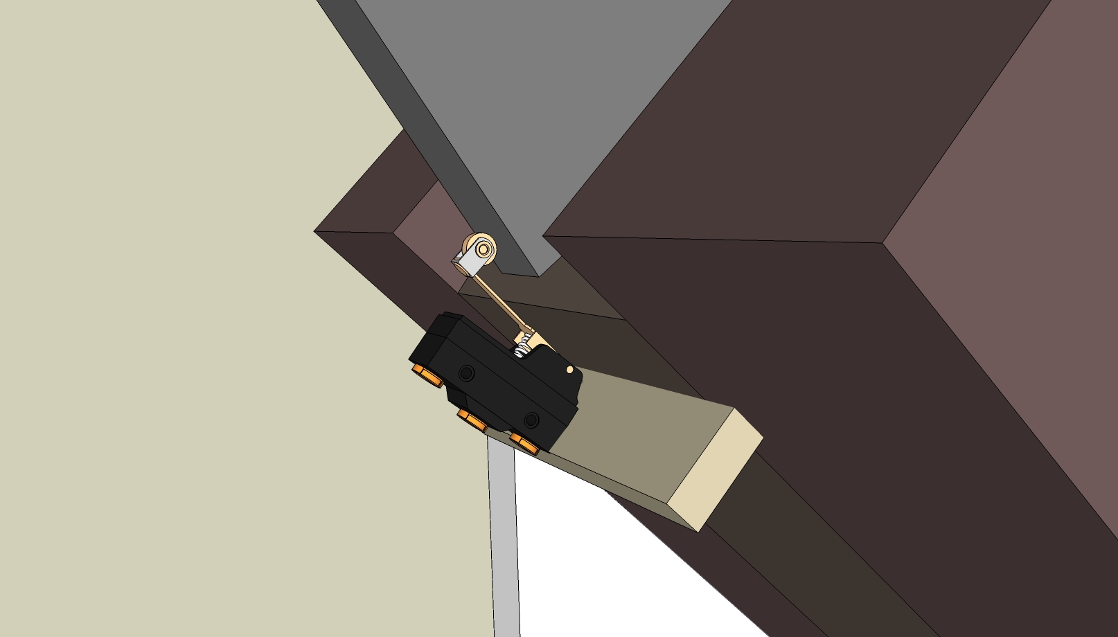

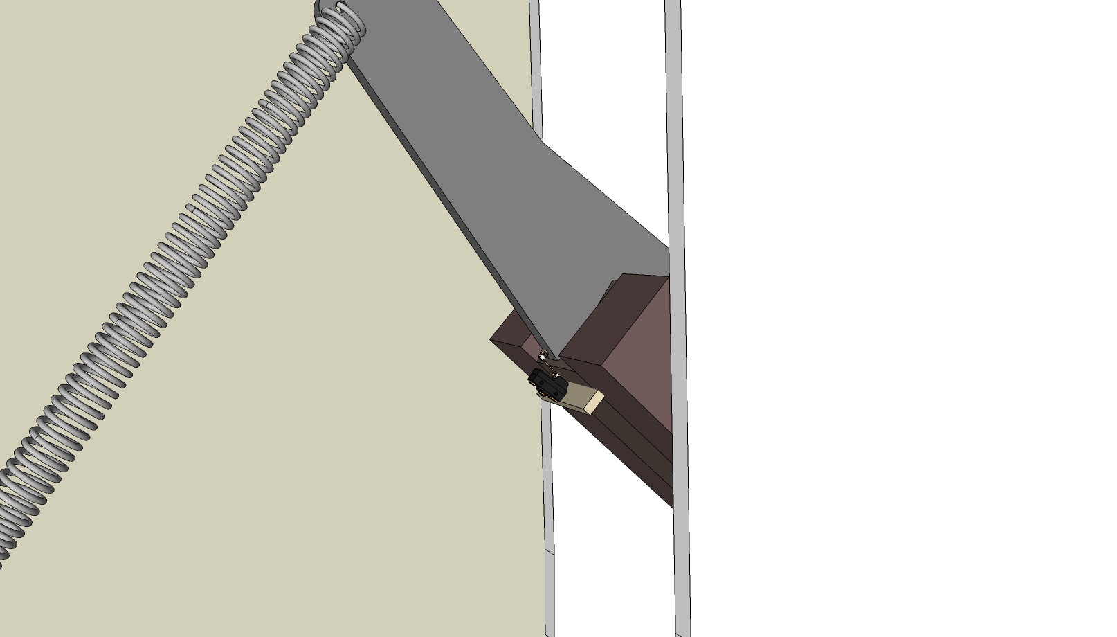

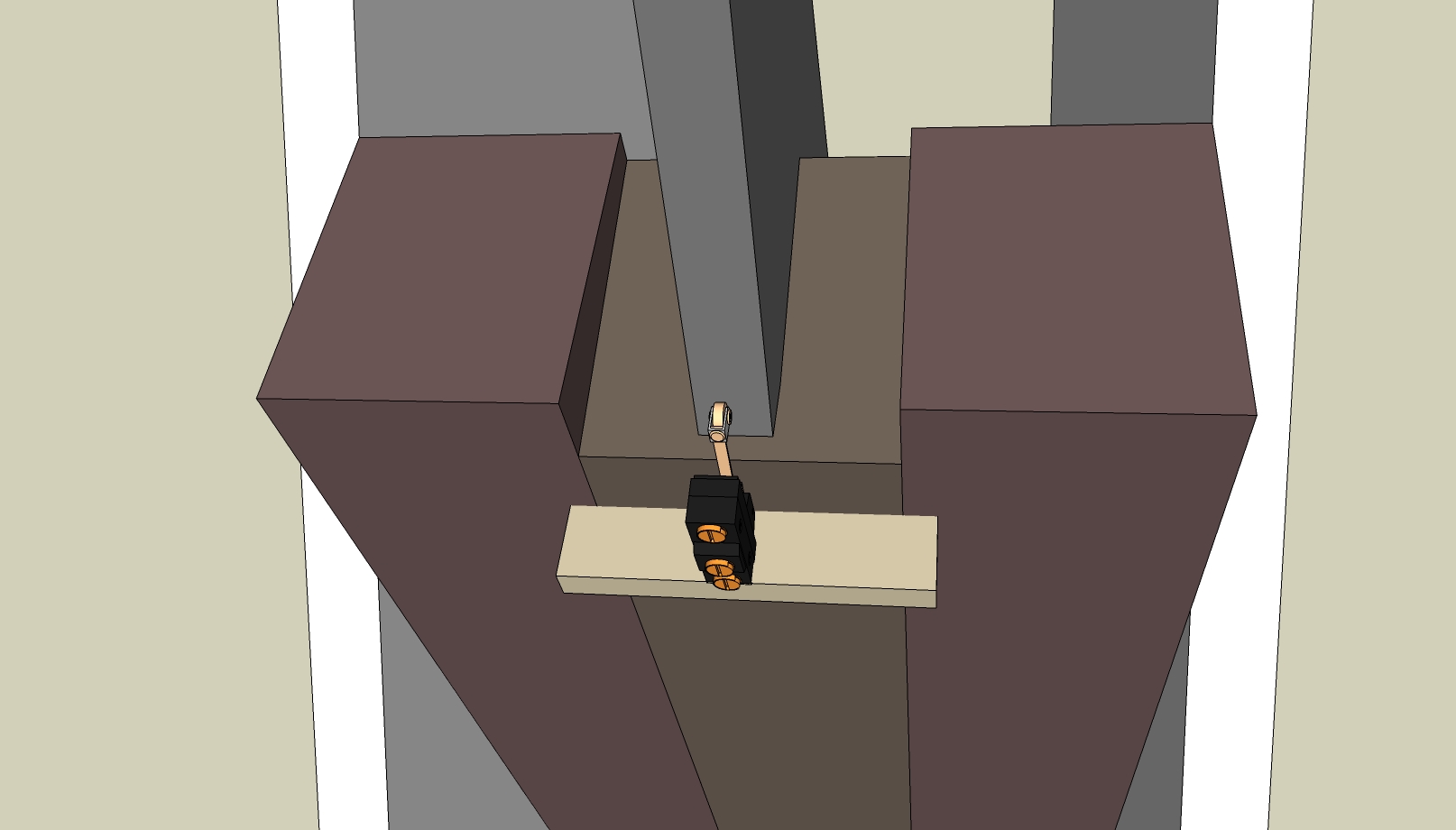

asarangan(at)gmail.com
PostPosted: Mon Jul 21, 2008 1:53 pm    Post subject: Unlatched outrigger Reply with quote
Regarding micro switches, it should only close when the outrigger is
'down and locked' and not simply when it is 'down'. I haven't seen
any discussion of the best location for the microswitch, but my belief
is that it should be on the OR7B step, with the switch tab facing OR5
arm. I have not installed it yet, but attached is a couple of diagrams
of what I am planning to do. Please let me know your thoughts.
 Filesize:  181.94 KB
 Viewed:  249 Time(s)
 Filesize:  131.71 KB
 Viewed:  260 Time(s)
 Filesize:  129.07 KB
 Viewed:  249 Time(s)
jrgowing(at)bigpond.net.a
PostPosted: Mon Jul 21, 2008 7:51 pm    Post subject: Unlatched outrigger Reply with quote
Dear Andrew
Great clear photos, and at first read it looks excellent advice.
I am looking forward to further comments but at last I am stating to feel
confident to do it!
Thank you for going to such trouble.
Sincerely
JR (Bob) Gowing UK Kit 327 Australia
nwcmc(at)tiscali.co.uk
PostPosted: Tue Jul 22, 2008 3:01 am    Post subject: Unlatched outrigger Reply with quote
There are probably at least two or more positions where the microswitch
can be placed to sense the down and latched position. Which you choose
is up to you. I found that by attaching it directly to the OR4 no extra
mounting plate was required. It was a relatively simple matter to route
the wiring so that the movement of the OR4 was not an issue. To keep
the wiring compact I used 20 gauge single coaxial aircraft quality
wire.
