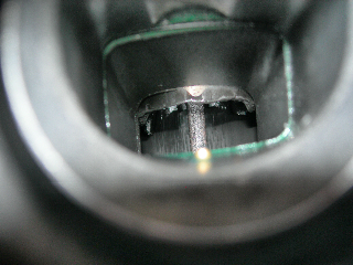

Some of the local guys in my flying club think the wrist pin failed or
the "circlip" came loose, causing the #1piston to get damaged. The
piston skirt was broken off all the way around and the engine was full
of ground up aluminum. The 503 had 205 hrs. on it at the time of it's
demise and was running perfectly up until about 1 second before it
quit. I've been busy doing other things, but one day I'll get around
to looking inside and let you know what we found. I'm attaching a
photo of the front cylinder looking thru the intake manifold.
