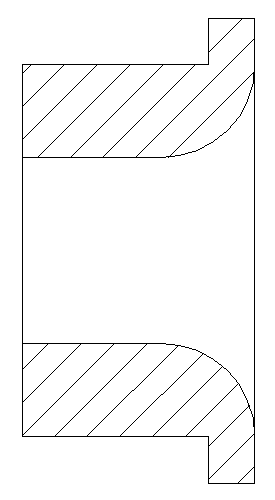

Totally non aviation related but if the part I am looking for exists,
I'm sure someone here knows where to get it.
I have this mechanism (details not important) that is actuated with a
rope, probably 3/16" parachute cord. The rope will exit out of a wood
cabinet through a round hole. The problem is the pull on the rope will
be almost at 90 degrees from the axis of the hole causing it to rub on
the edge of the hole which will make the rope wear out and cause lots of
friction. What I am looking for is some kind of metal insert I can put
in the hole that will have a large inside radius to give the rope a
smooth surface to ride on. I know a pulley would be the ideal solution
but that would make the cabinet unattractive and the force on the rope
will be less than 20 lbs so I think it should work fine with just some
kind of bushing in the hole. The larger the radius the better this
should work. I'm hoping to find something made out of either Stainless
steel or Brass. I guess a plastic would be ok too but I would rather it
be metal.
What I had in mind was something with a similar cross section to the
attached drawing. I could just have a machine shop put a radius on a
brass bushing but I would rather not have to do that, and I haven't
found a bushing with a thick enough wall to get as large of a radius as
I would like, 1/4" or larger.
Chris W
KE5GIX

How about a cable fairlead from Aircraft Spruce?
http://www.aircraftspruce.com/pdf/2008Individual/Cat08139.pdf

Those types of blocks are common in the sailing world and are called turning
blocks. They are typically mounted inside masts, booms or other hardware. You
might try this piece for starters:
http://discountmarinesource.com/detail.aspx?ID=823
They come in many sizes and rated for small to very large loads and there are
models for standard rope, wire-rope, wire and aramids.
Good luck,
Jack Hilditch

Sailboat hardware manufacturer's make something called an exit block which
has a pulley in it, or an exit plate that doesn't have the pulley that works
in a situation like you are describing. They probably won't work if you want
to be able to pull the line from any angle since they are directional.
Here's a link to an exit plate by one manufacturer. From the prices for this
stuff, you would think they were for airplanes.
http://www.fawcettboat.com/iwwidb.pvx?;multi_item_submit
Terry

Also in the sailing world, they make deck bushings for just such a perpose. Go on line to search them out. How big a hole do have in the cabinet.
Paul

It is to assist the folding up of a Murphy bed. The gas springs aren't
quite enough to balance out the weight of the bed is with the the rope I
can pull instead of push. Also the tight fit makes it very hard to get
at the foot of the bed to push where there is the most leverage.
So for it looks like the cable fairleads form aircraft Spruce look like
the best option. The catalog doesn't say how large the inside hole is
though.

I have a lathe in my basement as well as a mill. Send me exact dimensions on a drawing and I can turn that out for you for the cost of shipping. I have lots of scrap aluminum rod that I can use.

As you titled the email, it's just a bushing that anyone with a lathe can
easily make for you in a few minutes

I meant to say "as you titled the picture" - an di see someone else has
offered to turn one out for you - should be quick & easy, based on your pic

If you have a quick change tool post on your lathe and a holder with a drill chuck, you can use a corner rounding end mil to make the radius. Would take maybe five minutes to setup and cut.

You might consider using an aluminum flange for ducting. The smallest size hole
is 1". Just a thought...
http://www.aircraftspruce.com/catalog/appages/ductflanges.php
be metal.
Chris W

Here is a link for the parts from Wicks and they list the sizes that ACS
did not:
http://www.wicksaircraft.com/catalog/product_cat.php/subid=520/index.html
aren't quite enough to balance out the weight of the bed is with the
the rope I can pull instead of push. Also the tight fit makes it very
hard to get at the foot of the bed to push where there is the most
leverage.
like the best option. The catalog doesn't say how large the inside
hole is though.
