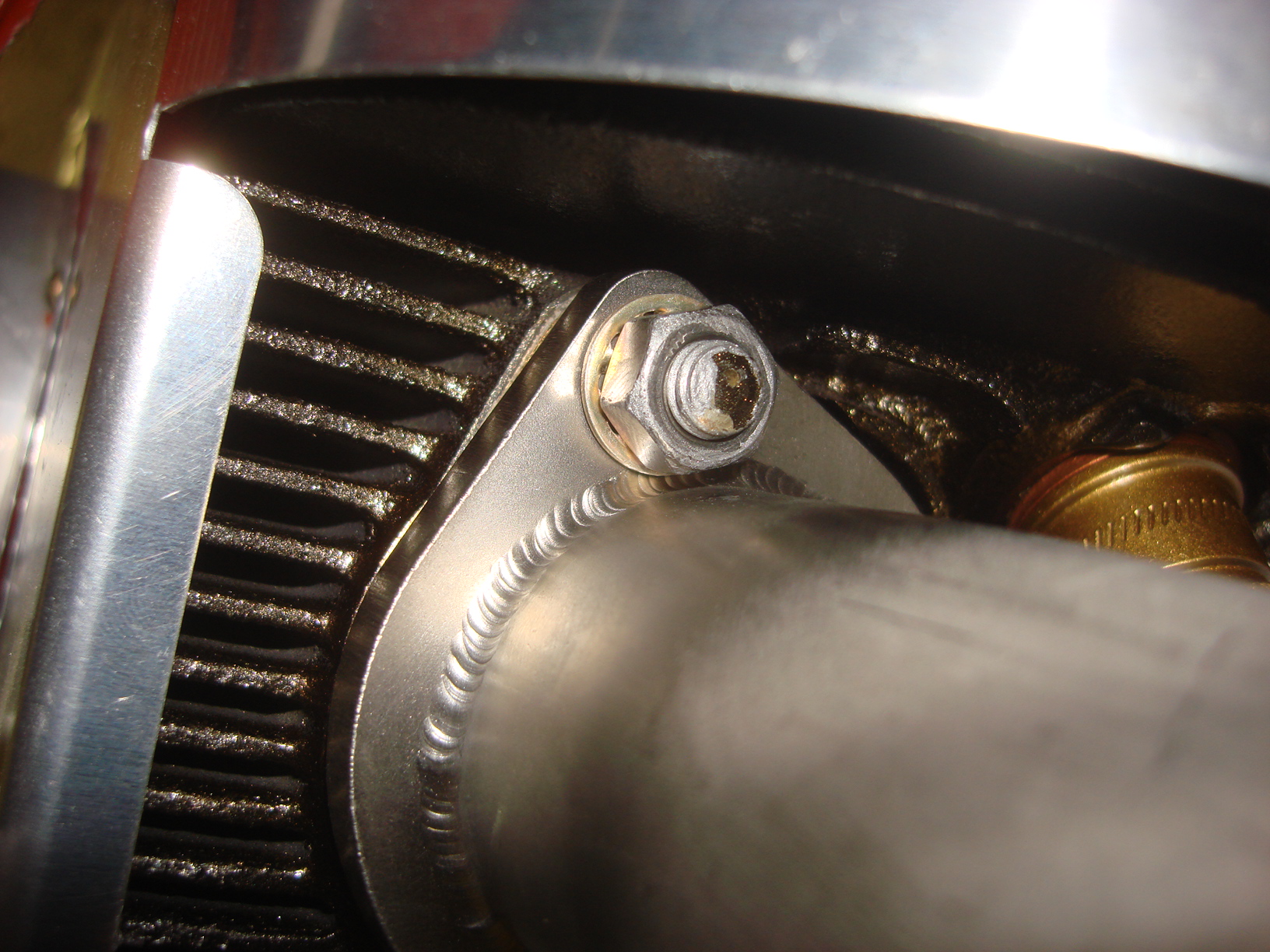

Hello There,
it looks as if this hole was drilled too close the exhaust pipe. I can not reach it with a ratchet nut or an jaw wrench. Any idea ho tow to go about it in order to achieve the requested torque (140)
Michael

PostPosted: Sun Jun 22, 2008 2:11 pm    Post subject: How to fasten this exhaust nut? Reply with quote
1/4 inch drive with extention. I had the same and with the thinner socket i
was anle to do it

PostPosted: Sun Jun 22, 2008 2:27 pm    Post subject: How to fasten this exhaust nut? Reply with quote
Wow! Challenging picture:
Four ideas. 1)A 1/4" drive "thinwall" deep socket on an extension. 2)A
Torque Adapter(Snap-On makes them). Or 3)a sacrificial crows foot -
modified with your die-grinder and 4)remove the studs and use Hex driven
bolts into the head. Automotive racing headers use the Hex ones all the
time for such close interference.
Note: I have always found value in using S.Steel exhaust nuts as once
regular nuts corrode, the removal technique down the road is 3X as
challenging for non S.S. This nut and the related internal star washer
appear 'standard cadmium' plated.

PostPosted: Sun Jun 22, 2008 2:32 pm    Post subject: Re: How to fasten this exhaust nut? Reply with quote
1/4" drive "wobble sockets" work great too. I've found them locally at Sears.

PostPosted: Sun Jun 22, 2008 4:16 pm    Post subject: How to fasten this exhaust nut? Reply with quote
#1 or # 2. Loosen the nut just enough to be able to move the pipe a
little. Place socket on each nut to ensure the pipe is centered
between the studs.
Every Lycoming exhaust port is just like this.

PostPosted: Sun Jun 22, 2008 4:28 pm    Post subject: How to fasten this exhaust nut? Reply with quote
Forgot to mention...my Mooney calls for an AN-310-3 nut there. Key is
to replace those nuts every few hundred hours, as soon as they show
any signs of corrosion.

PostPosted: Sun Jun 22, 2008 5:10 pm    Post subject: How to fasten this exhaust nut? Reply with quote
snip
Brass nuts also work well without 'bonding' to the stud.

PostPosted: Mon Jun 23, 2008 12:11 pm    Post subject: Re: How to fasten this exhaust nut? Reply with quote
[quote="Kelly McMullen"]#1 or # 2. Loosen the nut just enough to be able to move the pipe a
between the studs.
Thanks for the advice this one worked very well Smile
Michael

PostPosted: Mon Jun 23, 2008 1:26 pm    Post subject: How to fasten this exhaust nut? Reply with quote
Take a very old socket that size and start grinding it down to size to make
it fit then you will always have the socket that will fit.
I have a tool box full of modified tools.
