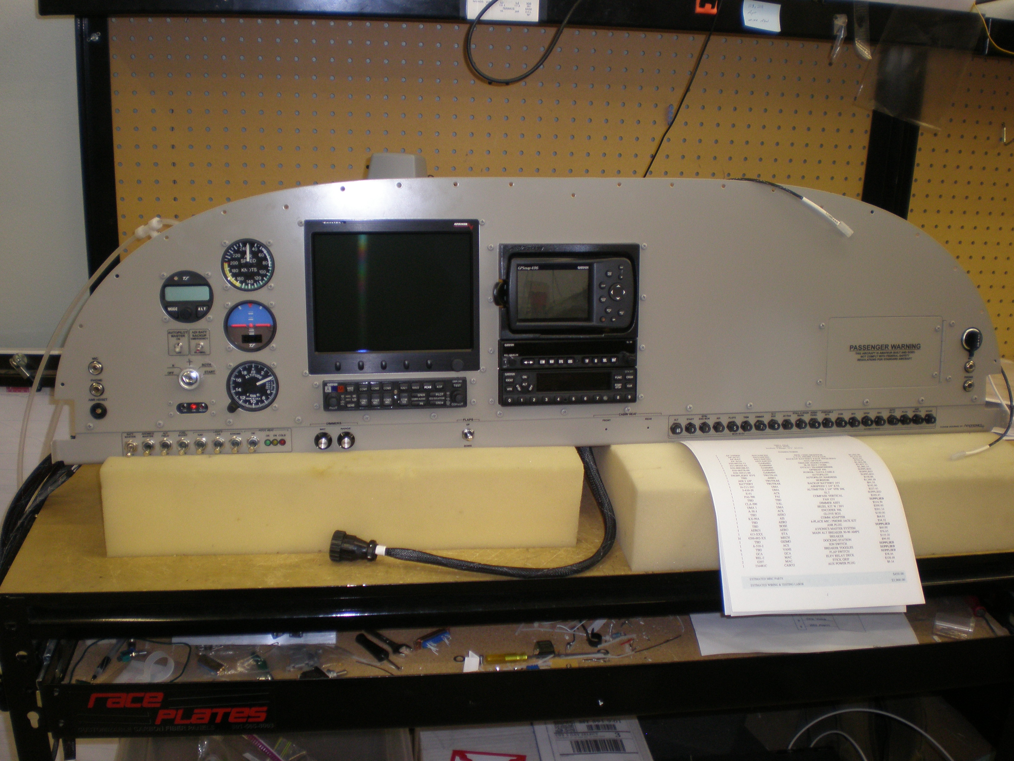

PostPosted: Tue May 20, 2008 6:04 pm    Post subject: Aerotronics RV-10 Panel Reply with quote
They did my panel for me - awesome. See my post previously put on this site under "Aerotronics - Blatant plug for - Plug & Play panel".
They are very complete. You do need to do a lot of finish wiring, but I went to Billings (They are also at OSH) to pick it up. They gave me three hours of training in finish wiring. Basically they give you a bunch of connectors to just conjoin with their connectors already on the panel. Very simple and the directions are excellent (diagrams).
I figure that they saved me about 400 hours of build time and infinite aggravation. Plus it looks really professional. Their pricing is not cheap, but for what you get it is a bargain. If you need support or have questions, it is included - no extra charge for the 1st year.
