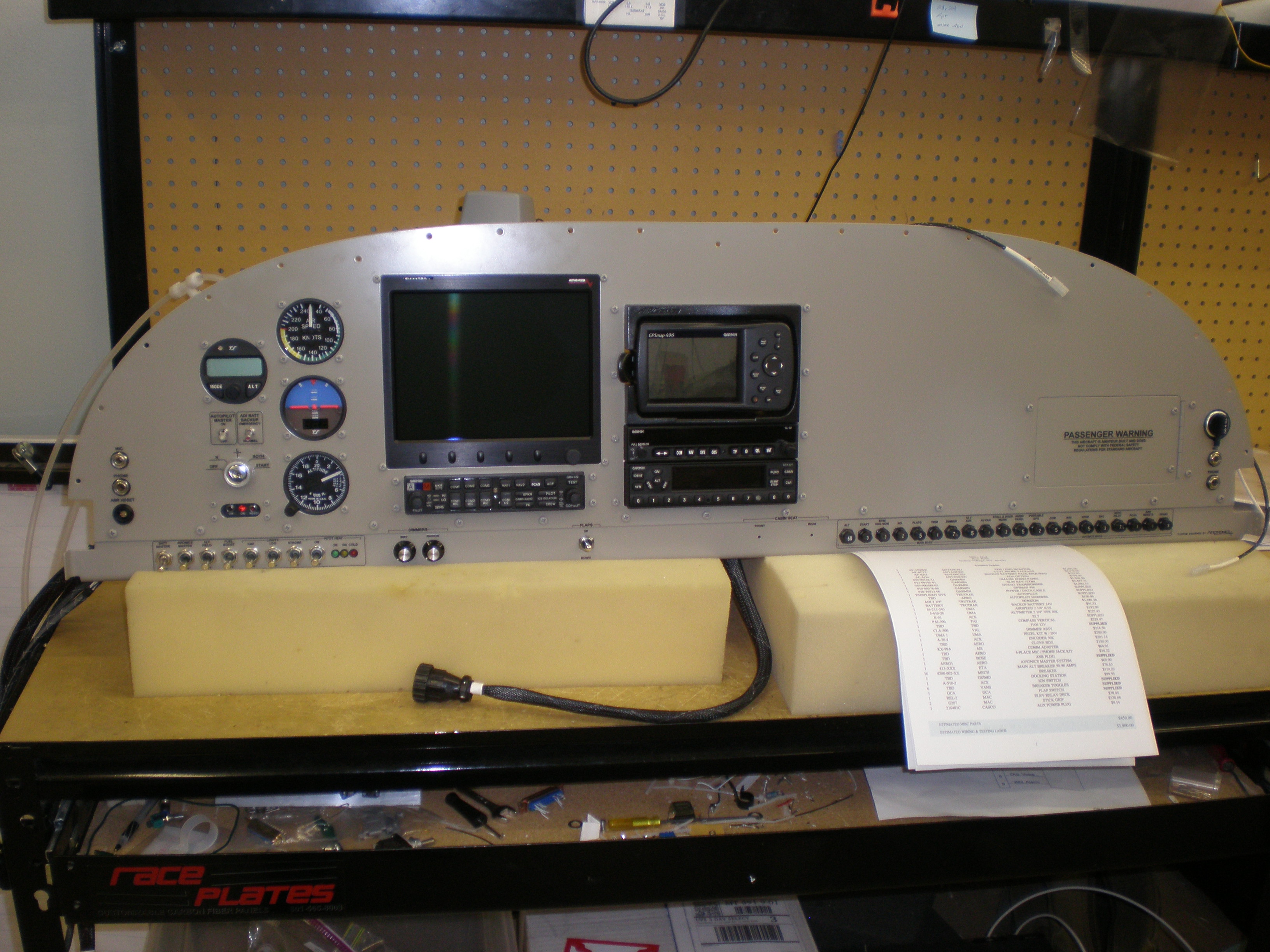

Thank you for the information Carl. I also received a call which advised me that the MB in wingtip would work with a 18"x 6" wide base plate on which the MB antenna (Comant CI-102) would be mounted as close to the bottom of the wing tip as possible. This would give me a mounting plate as well as the "ground plane". I am not that knowledgeable in this area so any help is appreciated.
I am essentially a VFR pilot but I wanted my plane certified as Day/Nite VFR/IFR so I have an SL30 Nav/Com and a Garmin 340 audio panel. My GPS is a Garmin 496. I figure that I saved about 6K on my panel over having a GNS430 plus on the 496 I get weather and Zaon traffic avoidance. Seems to me the best bang for the buck. My AFS3500 apparently displays the GS but not the MB.
Any further comments appreciated.
