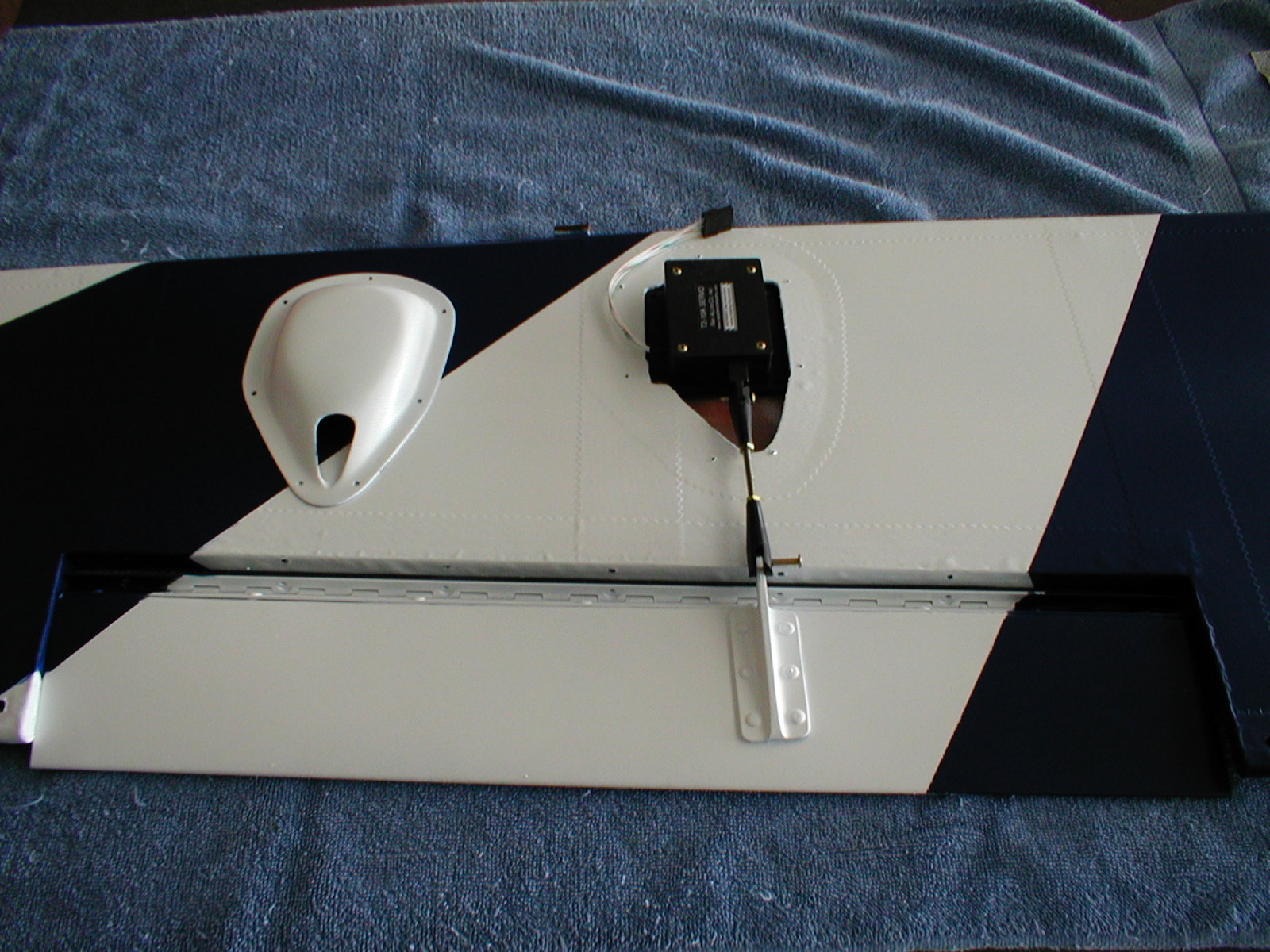

Well, as I mentioned earlier, I am now reporting on my new elevator trim installation. In a word it is fantastic! It makes my Kitfox a new airplane! I have the classic version and it was really bugging me to hold back pressure throughout the landing phase. I have had a trim system in every aircraft I have owned except my Kitfox.
I sent the elevator off to Lowell at http://Highwingllc.com . He stripped the fabric and did the necessary modifications to the elevator,recovered,painted to silver and sent it back. Turnaround was about two weeks. He and Mark plan to have a modified elevator on hand so that you could send yours and he will return a completed modified elevator. I couldn't wait so he agreed to modify mine.
I cannot explain in words how happy I am with this mod. The workmanship is great! I installed a "witches hat' trim on the stick and have a LED trim position indicator on the panel. Now just a "blip" or two on final will trim the aircraft hands off in pitch. Also, I no longer need to extend the flaps a little for cruise trim

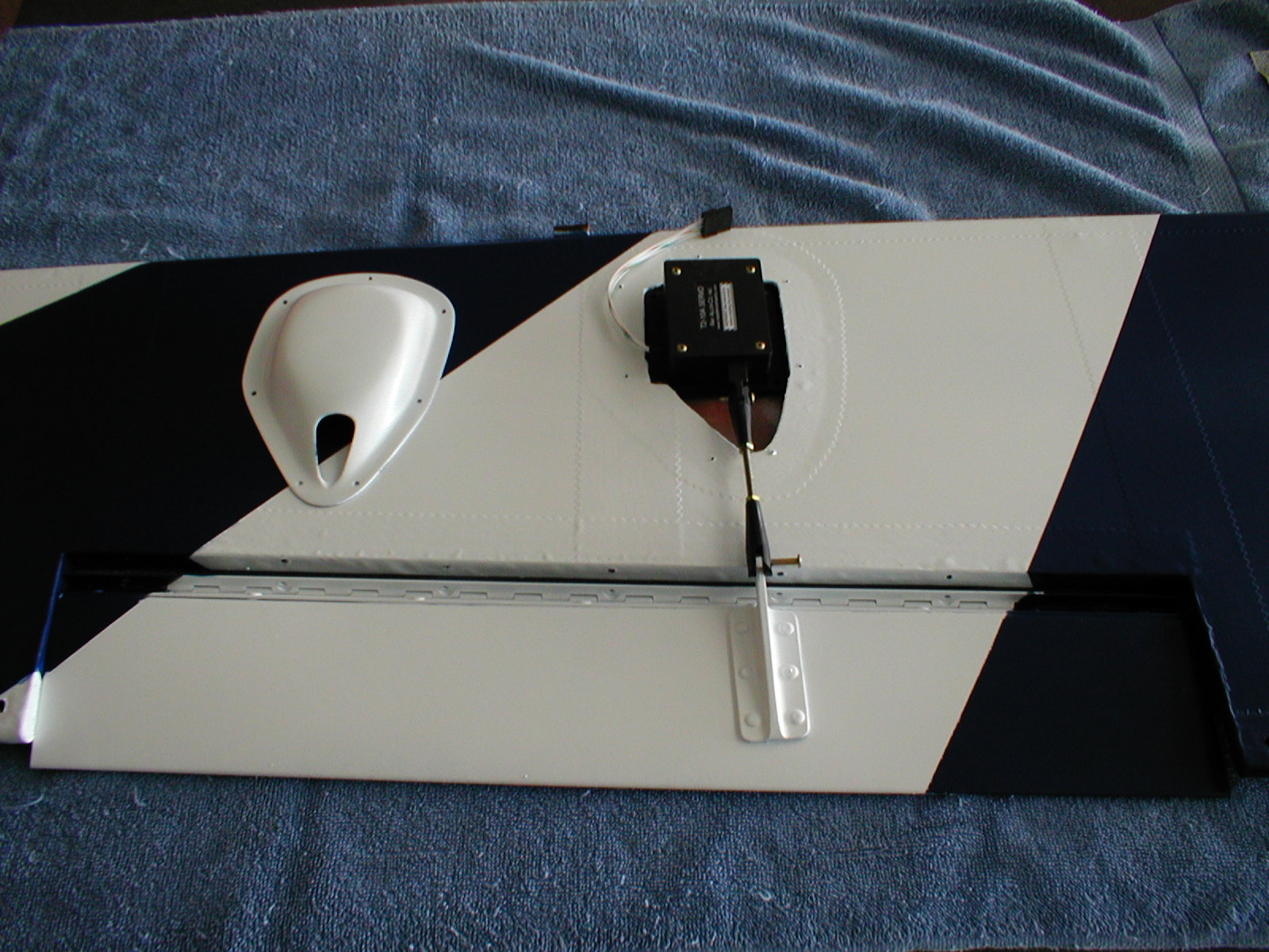

Paul, thanks for the info on the tailwheel. I found it in the archives. I will try your suggestion on my weak brakes by installing new pucks although my old ones are fine. I will probably have to get new brakes. I have the original setup with Douglas wheels,single piston Matco brakes and plastic brake lines. (maybe I don't have enough pressure)
Here is a picture of my new elevator trim for my classic I purchased from Highwing LLc

PostPosted: Mon Apr 28, 2008 5:38 am    Post subject: Re: Elevator trim and Kingfox tires Reply with quote
Dick,
Glad to hear you are back in the air! Elevator with trim looks good. Hope to fly with you soon!
