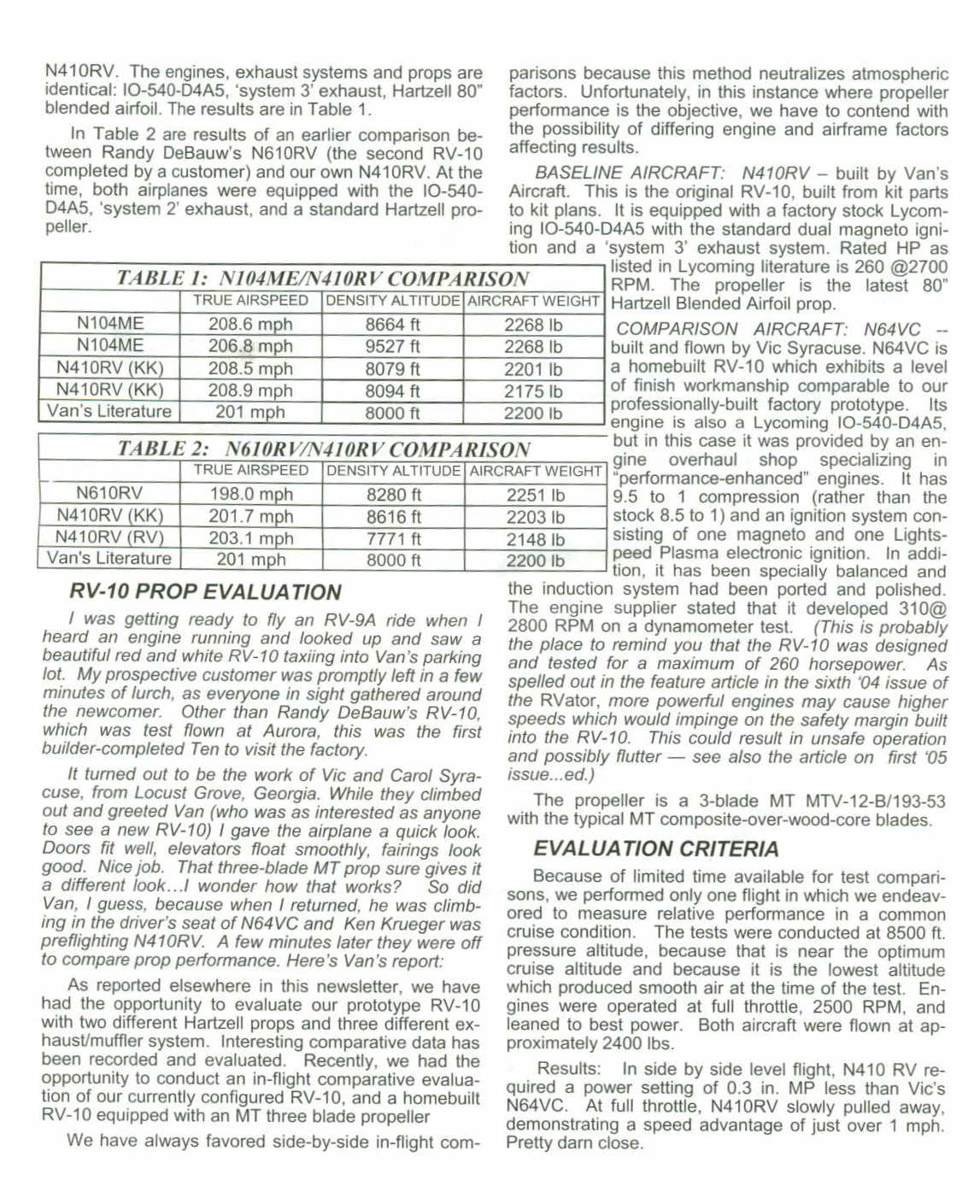

Comparison published in the RVator - 5th issue 2005. I've attached the
relevant pages.

I can't site the source but it is from a report done by NASA that
determined that a perfect 3 blade is "slightly" less efficient than a
perfect 2 blade. However in practice, other variables, such as engine,
airframe, altitude, cruise speed, etc, will have more of an effect than
the theoretical difference in efficiency between a 2 and 3 blade prop.
With all the variables beyond our control it is very difficult to
determine what prop would work the best for any given situation by
comparing various reports from various builders. What I would really
like to see is Van's (or anybody else for that matter) build 2 identical
planes. Do side by side flight tests to see how close they are in the
air for a base line. Then start testing various changes in side by side
tests. Seems to me that is the best way to get data that is very useful.
