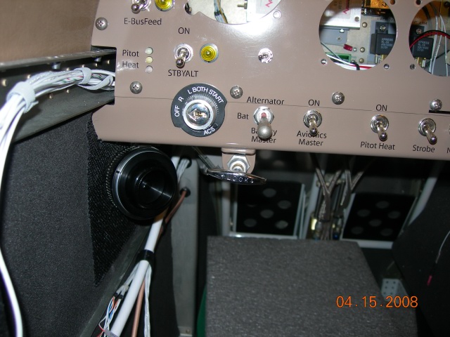

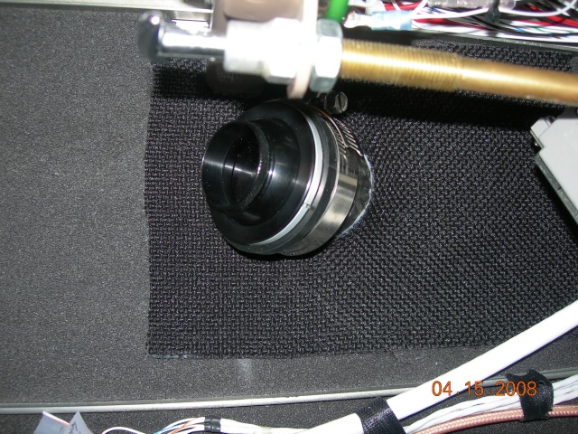

PostPosted: Thu Apr 17, 2008 1:54 pm    Post subject: Recommendations for front air vents Reply with quote
No secret, I just didn't know if anyone cared to hear. But glad to share.
Here goes; Go to lowes or H.D and B-line it for the plumbing department,
then look for the rubber fittings to attach PVC, in line, 1 1/2". Get a
coupling for 1 1/2" pipe, it will be about 4" long and have two hose clamps
on each end. You will need to cut the two ends off with a band saw, or your
weapon of choice. Cut just inside of the groove where the clamp sets. You
will now have two couplings for each vent.
Then you can use a dremal to cut the big flange off the NACA inlets, about
1/4 inch from the seam, or so you have 1 1/2" diameter left. Then with the
nut ring still on the eyeball vent insert it into the rubber coupling and
place the whole unit over the NACA vent, and tighten the hose clamp.
Sound complicated but take around 30 minutes.
Let me know if you have questions. I also have a pic of the end product,
looks real clean, is easy to remove, and eliminates the ugly white flange,
and requires no hardware or glue.
Thane
803-396-8865
Working on finish kit: I hate fiberglass!!

PostPosted: Fri Apr 18, 2008 5:42 pm    Post subject: Recommendations for front air vents Reply with quote
Here are a few pics of my eyeball vent install as promised. Hope these are
OK.
Thane
 Filesize:  112.7 KB
 Viewed:  753 Time(s)
 Filesize:  172.28 KB
 Viewed:  637 Time(s)

PostPosted: Sun Apr 20, 2008 5:29 pm    Post subject: Recommendations for front air vents Reply with quote
Rick, the coupling I used had the hose clamps already on each end, so I just
used them. It holds very tight and you can barely see the clamp once it is
installed.
Good luck, I am very pleased with the final look and function.
Thane
