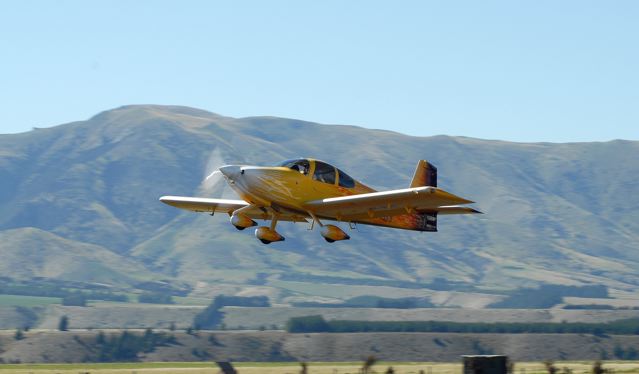

ps- Take off with Sarah PIC at Warbirds over Wanaka a couple of weeks
back. Osh may be bigger, but Wanaka surely has the best setting
anywhere for an airshow.

The Warbirds acts as breathtaking as the setting at Wanaka. See you for
OSH '08.
