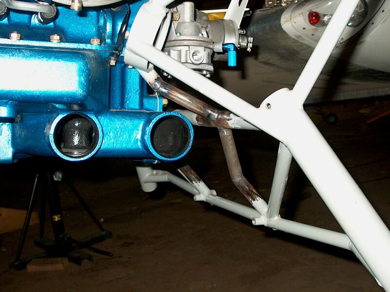

PostPosted: Mon Mar 31, 2008 7:07 pm    Post subject: Q on sump fit on O- & IO-360's Reply with quote
Charlie,
Mine is a -6 taildragger. I've attached a picture that shows the mod that I
had to make on the engine mount. The IO-360-C sump has the intake tubes much
further aft than most of the others and there was virtually no clearance
without the mod. If you compare your sump to the picture the difference is
very apparent. The C sump is also magnesium. The IO-360-A1A sump is the most
common forward facing. That's what I got from AERO/Superflight. It gives you
the equivalent of the IO-360-M1B forward facing parallel engine and you can
use exhausts made for it. I got the 4 into 1 from Aerospace Welding. I
haven't fit it to the engine yet but it is beautifully built.
http://www.awi-ami.com/4%20into%201%20exhaust.htm
