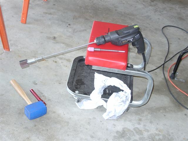

I used a stone with extensions and a flapper wheel. See picture.
I bought the extensions through the mail from McMaster-Carr.
Rex Rodebush
