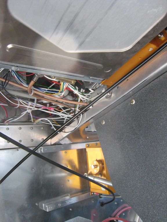

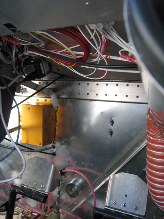

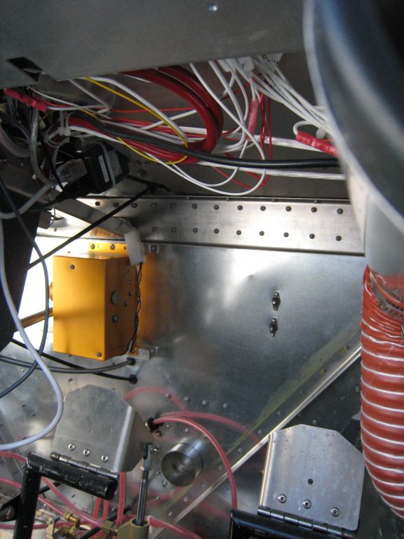

Actually I was told by an owner of an XL with *hinged* ailerons that his
Trio Avionics servo slipped. But since he had a two axis system I don't know
which servo was slipping. The installation of the altitude hold servo was a
little unusual on this plane. It was mounted on the firewall (pictures
attached).
