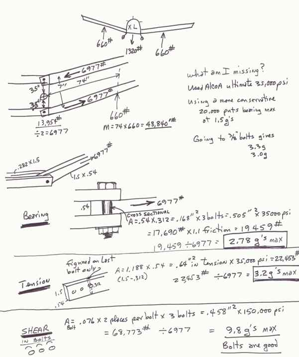

I ran some figures on the XL wing attachments and do not get good answers.
Can someone who has done statics calculations more recently than my 48 years ago check my work and tell me where I went wrong?
Not trying to revive last weeks discussions on the list - just want to talk to an engineer before I go flying.

There are six bolts in there. I think you'd need to redo the analysis using the six bolts. I was going to get my Statics textbook out for this one myself, but I don't think this is a problem, albeit, I'd be damn sure to make sure those bolts were drilled right on the money AND reamed which it of course does call for. Even so, the NTSB never mentioned that joint failing. In fact, the folding occurred further outboard. I think that joint is fine, albeit pretty hairy looking at first glance.
A rough calculation around that fixed center virtual pivot would give about 13,577lbs on one bolt, divided by 6 bolts is 2,262lbs, times 6Gs is still only 13,577lbs per bolt.
That joint is fine.

| ashontz wrote: | There are six bolts in there. I think you'd need to redo the analysis using the six bolts. I was going to get my Statics textbook out for this one myself, but I don't think this is a problem, albeit, I'd be damn sure to make sure those bolts were drilled right on the money AND reamed which it of course does call for. Even so, the NTSB never mentioned that joint failing. In fact, the folding occurred further outboard. I think that joint is fine, albeit pretty hairy looking at first glance.
You're leverage around those bolts with the virtual pivot in the center is roughly 20:1 = 74 inches /3.5 inches.
A rough calculation around that fixed center virtual pivot would give about 13,577lbs on one bolt, divided by 6 bolts is 2,262lbs at 1G, 6Gs is still only 13,577lbs per bolt.
That joint is fine.

Does anything in the calculation speak to the tolerances of the six bolt
holes in the spars? I think that the ones in my QBK kit are too sloppy but
ZAC says that the tolerance is 12/1000". Since it is the outside two holes
on each side that are the worse (about 8/1000") it seems to me that those
two bolts won't be supporting a load at all. I'm looking for a tolerance
spec from an independent source.

That's pretty damn sloppy, 12 thou. Isn't a human hair like 1 or 2 thousands?
12 thou is almost the thickness of the aileron skin. 12 thou clearance under the fourth leg of a chair on a solid floor is noticable even.
I reamed my own holes and that reamer is the EXACT same size as the Aircraft Spruce bolt I put in there. The difference isn't even measureable with my dial caliper and that's accurate to 1/1000th. The hardest hole to drill and ream is the second one because it's only clamps and one bolt keeping things in alignment. Once you've got two, the rest are easy.

The thing here not mentioned is torque compression values that provide
surface friction. This friction offers more load-capability than simple
bolt-to-hole contact-loading and should eliminate your concern for
having less than a perfect fit at the spar holes. It's a best reason
for multiple bolts in this type of assembly.

I'm sure the clamping action provides quite a bit of friction, but I can't imagine the friction being the main shear resistance, nor the intended main shear resistance.

You should also remember that the lift is not distributed evenly over
the length of the wing. The wing is tapered so the lift distribution
also tapers off as you approach the tip. In fact, a tapered wing like
this produces a fair approximation of an elliptical lift distribution.
This puts the centroid of the lift closer to the root than the mid span
point and reduces the lever arm and, therefore, the torque at the root.
I suspect the centroid of lift is closer to one third the span than one
half, say 50 inches instead of 74. It's been a long time since I used my
aero engineering training, so this is just a rough estimate off the top
of my head.
I'm not worried about that joint failing.
That joint is fine.

If I'm not mistaken, the rear attach bolt is a single bolt and provides no upward resistance, it merely holds the rear of the wing in line with the front of the wing, no? The rear bolt only keeps the spar in line to take all of the bending moment.
There is no center spar on the rear because there is no bending force being acted upon on the rear of the spar. The main spar carries the load. Any bending moments on the the rear spar are transmitted to the main spar. Considering the center of lift of the wing is near the main spar, it shouldn't be a problem.

Uh, we're talking about the forces in the spar and how the spar connects and the loads transmitted through them. As far as I'm concerned this part of this thread has nothing to do with accidents. The spar connect looks fine to me, plus, it's never been indicated in a NTSB report as a failure point.
I think, even without being an aeronautical engineer, pretty much anyone can calculate a rough estimate of the leveraged force through a beam with a force applied at distance x and a counteracting force or forces at distance y. And it's not too far of a stretch of the imagination to see that the spar will do just that, provided that the ribs and skins keep it in line. So, we've got ribs, spars and skins defining the shape of the wing as well as holding the main spar in line so that it can ultimately transmit that moment to the airframe to lift it. Not too complicated once you get down to the business end of the wing spar fitting in the center spar via 6 bolts and the rear bolt on the back of the wing keeping the wing from changing it's pitch relative to the fuselage. Sounds about right to me.
Now where I'd like to see the 3rd party analysis is on some of the internal structures in the wing itself.

Another point to remember is that the wings and included fuel make up a
significant fraction of the gross weight of the airplane. The weight of
the wings is not transmitted through the main spar attachment in flight.
The swings support their own weight plus half the weight of the
fuselage, instead of each wing supporting 660 lbs at the wing root, it's
more like 500 lbs. This further improves the load situation at the wing
root.
