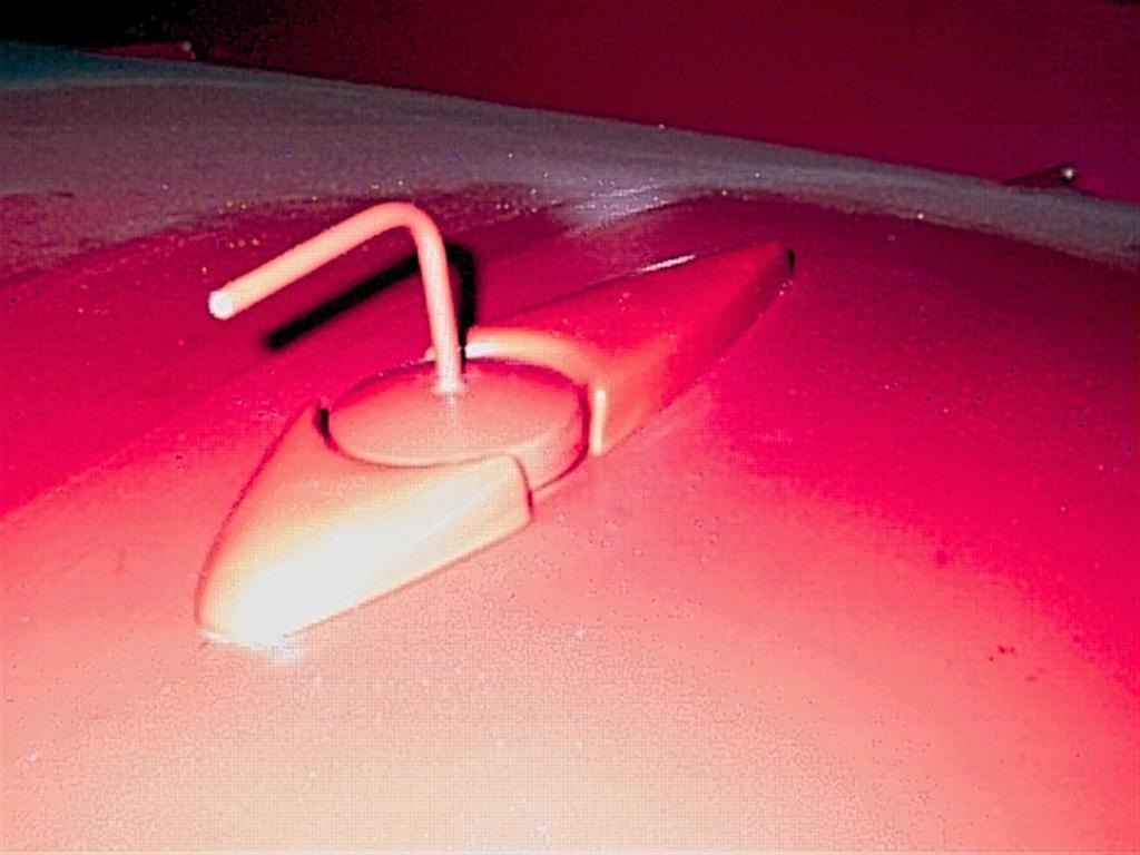

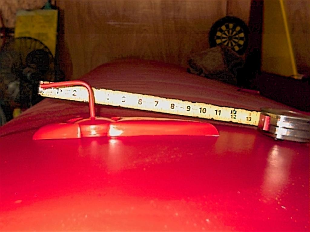

I made my own. It was fairly simple. Just used 3/4" blue foam carved to
shape, sanded, covered with a thin layer of glass/epoxy, paint to match,
then epoxied to the wing. Photos attached. Sorry about the photo quality.
They were taken a long time ago when digital cams were infantile.
Deke Morisse
Mikado Michigan
S5/Subaru/CAP 355+ TT

As for my reason for the fairings, it wasn't so much as to reduce drag, but
to clean up the top surface of the wing. A long time ago, one of our list
members did a oil drop test to see how much the air was disturbed behind the
gas caps. Oil drop is where you take a thick oil and put a bunch of drops
on top of the wing all around the spot you want to test. Then you go fly
and when you get on the ground, jump out and take a quick photo of what you
see. What he found was that immediately behind the gas cap the air was
stalled and it widened out to a point about 18" at the trailing edge of the
wing. In my opinion, when you add both wings together, that was a pretty
big chunk of lifting surface not providing any lift. So, since it was a
long winter, and nothing much else was going on, I decided to kill two birds
with one fairing, well two. Regarding the gas caps, most of the parasitic
drag and loss of lift were resolved. I can't quantify in numbers what it
adds up to, but the weight was probably less than 2oz total and they sure
don't hurt anything. The benefits are increased speed with less throttle
meaning better efficiency which translates to fuel saved. Seems like a no
brainer to me.

the mission. When it comes to buying gas, I'm a real cheapskate and if I
can get a few more miles per gallon without adding much weight, that's what
I'll do. Like you said, it's a hobby, a quest, a mission, or perhaps even
an obsession.
Antagonized in Mikado, MI
Sunny, warming up and spring is springing
Whaoo!
Deke Morisse
Mikado Michigan
- Joseph Joubert
Hey Deke -
You are correct, that every little bit helps. Also it is a hobby, so
nothing
wrong with it in the least.
My points more come from - That in he world of basic aerodynamics,
regardless of what you do, the basic design itself IS the REAL issue. No
matter how much you tweak a Kitfox, you will only ever make minor
improvements.
I think some times from the list, you get the impression that people
think they will get a 40 mph gain from all these enhancements. You
simply can't.
The higher horsepower IO-240B really brings this to light. I have a good
bit of power however it becomes clear when I fly that the drag is very
much increasing exponentially and it hits a wall at about 120-140 mph
where you either need another 200 or so horsepower, or some pretty
significant drag reductions to go faster.
When I say significant, I mean like an entirely different wing and
fuselage.
Anyway, that's the only real point.
Jeff
P.S. I really posted it to - antagonize Deke. But that's another story ...
Smile
http://forums.matronics.com/viewtopic.php?p=169283#169283

Deke, I see your gas cap fairings have a piece in front as well as behind the cap. I think the ones you buy have only a piece behind the cap. Being an old canoe builder I know that the increased lineal length to part and return the air is more efficient. Was there any "testing" done in your design or was it an eyeballed design?

Ahhh, Jeff, my old draggy friend. Skepticism is good. Nothing wrong with
that. In the past you have made it well known how you feel about fairings,
which is fine, but we all have our opinions here. The vast majority of us
don't have 125hp to play with. Most have 100hp or less. I'm a firm
believer that every little bit counts when it comes to cleaning up the
airplane. It's probably not linear, but it all adds up, no matter how small
each item is. Some things are more effective than others, depending on what
part of the airplane is causing the drag.
brainer to me.
As for a drag chute, I can recall a couple landings when I wish I'd had one.
Would have saved a go round.
Slick is good. Smile
