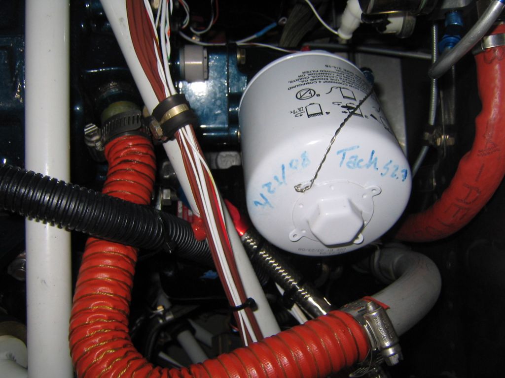

Dave(at)AirCraftersLLC.co Guest
Posted: Tue Mar 11, 2008 9:44 am Post subject: 90 Degree Oil Filter Housing |
I'm not sure if Casper Labs is different but here is a B&C adapter with a
1.5" spacer on my -10.
Dave Saylor
AirCrafters LLC
140 Aviation Way
Watsonville, CA
831-722-9141
831-750-0284 CL
www.AirCraftersLLC.com

flysrv10(at)gmail.com Guest
Posted: Wed Mar 12, 2008 4:03 am Post subject: 90 Degree Oil Filter Housing |
I have one on mine with 310 hrs on the plane. What do you need to know?
The breather tube has to be talked to in order to clear the filter. Otherwise, nothing else to worry about.
I drain my oil overnight and have zero drip when I remove the filter the next day.
Rob.

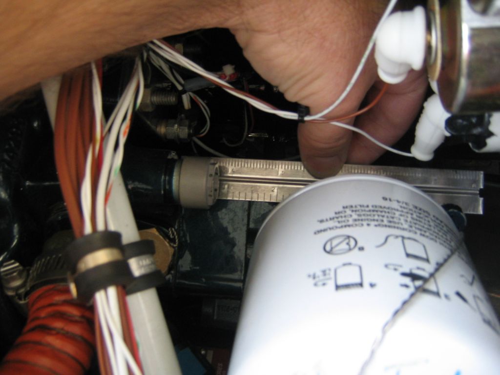

apilot2(at)gmail.com Guest
Posted: Wed Mar 12, 2008 6:02 am Post subject: 90 Degree Oil Filter Housing |
Great. Exactly what I wanted to know. Looks like the tach drive might
be a bit tight. I gather there is no issue with the engine mount or
cowling clearance.
Posted: Wed Mar 12, 2008 7:48 am Post subject: 90 Degree Oil Filter Housing |
The tach drive is indeed very close but I can't tell you how close,
based on my memory. Of course, if you are using any kind of glass
panel, you will not need the tach cable.
If you need to know how close they are, I will have to look when I
take the cowl off. Let me know.
There are no issues with the mount or cowl. You will need the 1.5
inch spacer for the adopter.
Rob
