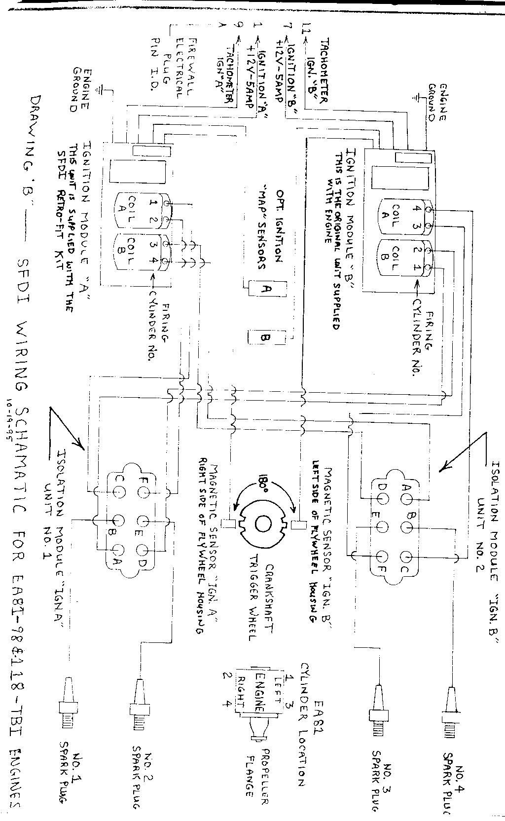

Rick/Jeff, I've attached the instructions for the trigger wheel mounting and also the schematic for the entire ignition system. Hopefully this will help. Also, take a close look at your ignition wires as it's possible you may have one or more of them installed incorrectly.
Deke Morisse
