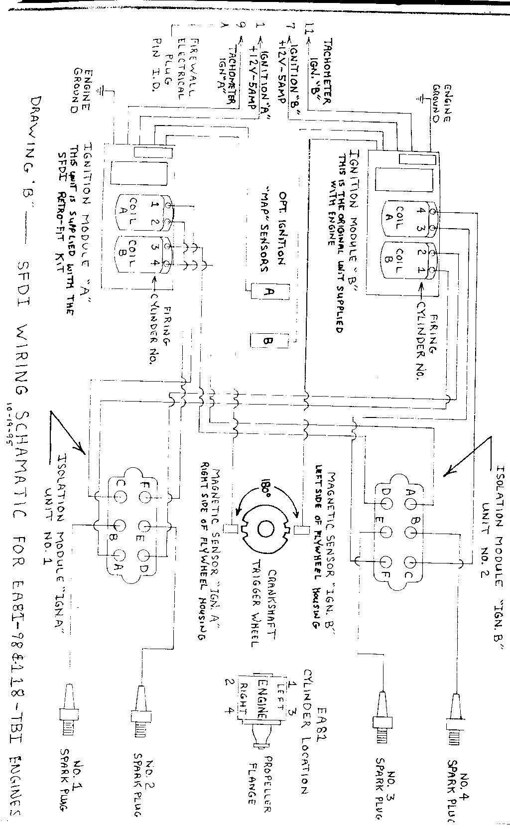

Rick/Jeff, I've attached the instructions for the trigger wheel mounting and also the schematic for the entire ignition system. Hopefully this will help. Also, take a close look at your ignition wires as it's possible you may have one or more of them installed incorrectly.

I saw the emails from the others. I think Rick is right, the flywheel only mounts one way. One thing to try first is to switch the wires coming from the pickups. I had the same symptoms you write about and I had the two ignitions switched. It sounds strange since it is supposed to be 180 degrees out from each other but it worked for me.
