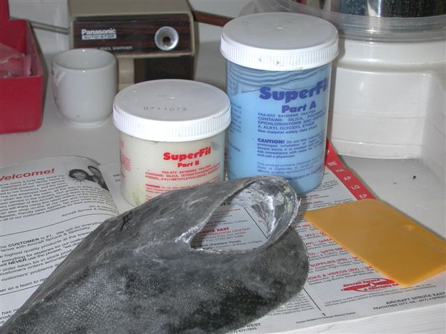

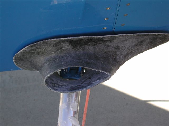

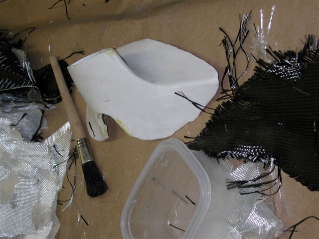

<<DSCN1907.JPG>> <<DSCN1893.JPG>> <<DSCN1894.JPG>>
<<DSCN1900.JPG>> <<DSCN1902.JPG>> <<DSCN1904.JPG>>
<<DSCN1906.JPG>>

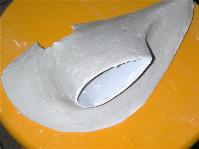

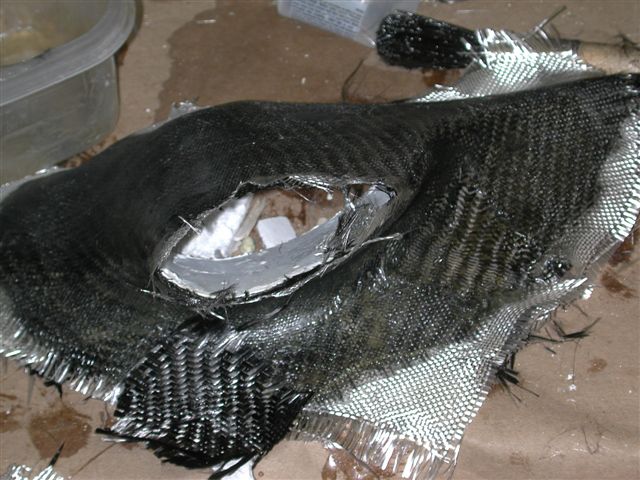

I do use dry wall plaster in making lost mold techniques along with
paper..on this mold I used gauze and it worked out very well.. I also
use clay to do little fixes-- after the plaster is shaped to the final
contours and ready for composite I seal the surface with a dental
separator used to make dentures and then the residual plaster can easily
be rinsed away with water. After the part is removed from the plaster
and trimmed the surface is smoothed and prepared for paint.
Uncle craig

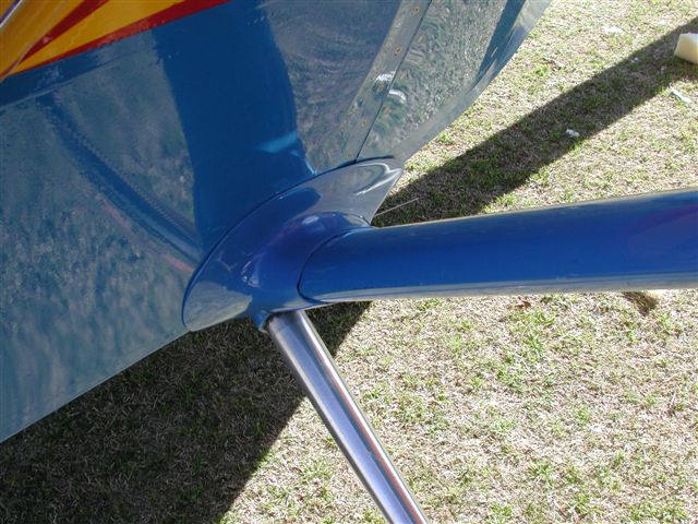

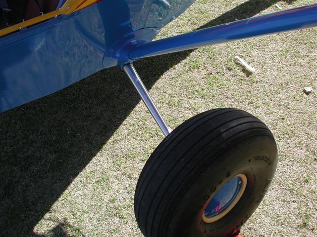

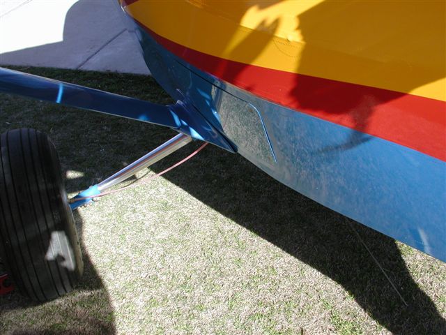

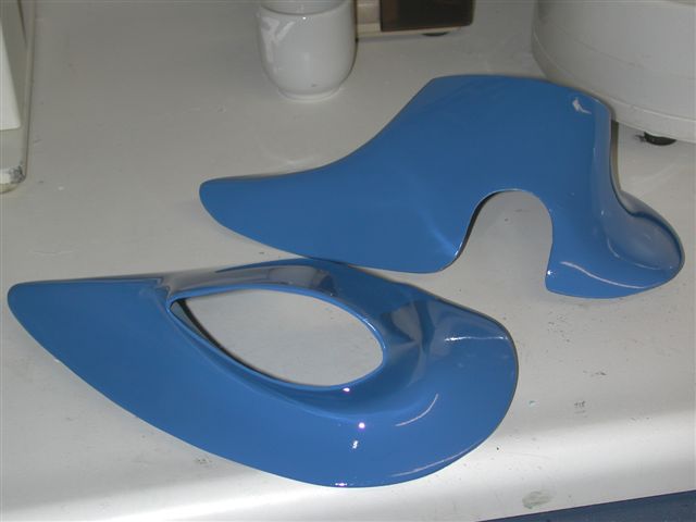

<<DSCN1909.JPG>> In a few hours from start to finish custom farings
Uncle craig

I can shape the piece with plaster make the contours perfect. The
plaster sometimes gets up to 1 inch thick. The part ends up one layer of
s glass one layer of carbon and one layer of s glass extremely light and
not much filler to smooth it out.

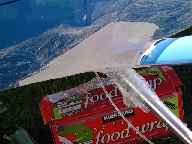

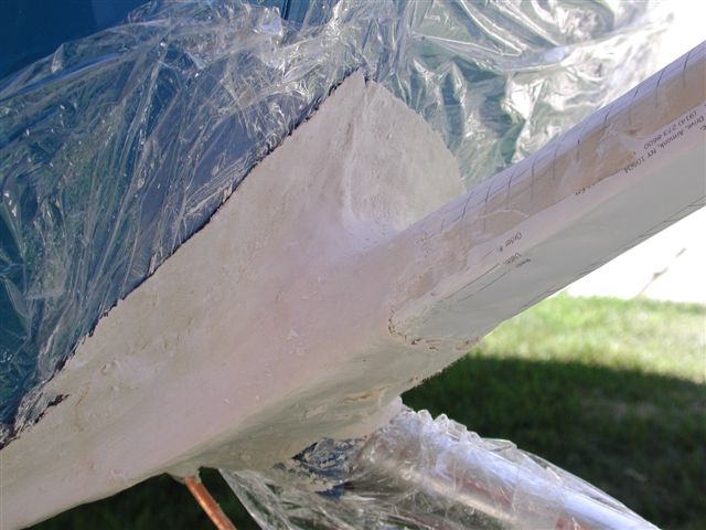

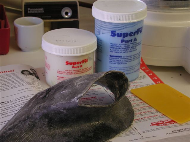

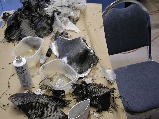

PostPosted: Thu Mar 06, 2008 11:32 am    Post subject: Lost mold Reply with quote
<<DSCN1915.JPG>> <<DSCN1890.JPG>> <<DSCN1891.JPG>>
<<DSCN1892.JPG>> <<DSCN1913.JPG>> <<DSCN1914.JPG>>

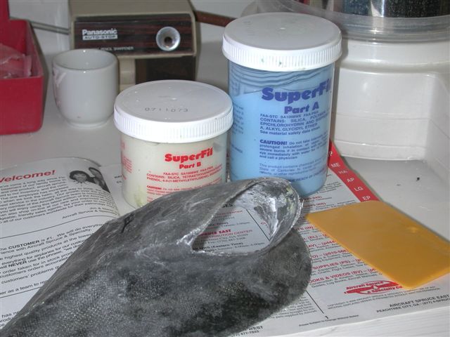

.Lost mold means just that. The mold is lost when the part is made. I
make a positive mold out of tape to get the basic shape then the plaster
is used to make the mold strong enough to remove from the plane.. More
plaster is used to get the proper contour of the part .. Then I apply
separator to the plaster called Aislar a dental denture material in
dentistry it is call tin foil substitute used to fill the pours plaster
so acrylic does not stick to it. Then I wax the plaster form and apply
the layers of glass and resin, when this sets up I remove the part from
the mold. The plaster brakes up on removal because it is not strong
enough to stay in one piece when removing the part.( lost mold it is
only good for one part) Then I fill the weave of the cloth with filler
and paint it
Uncle craig
