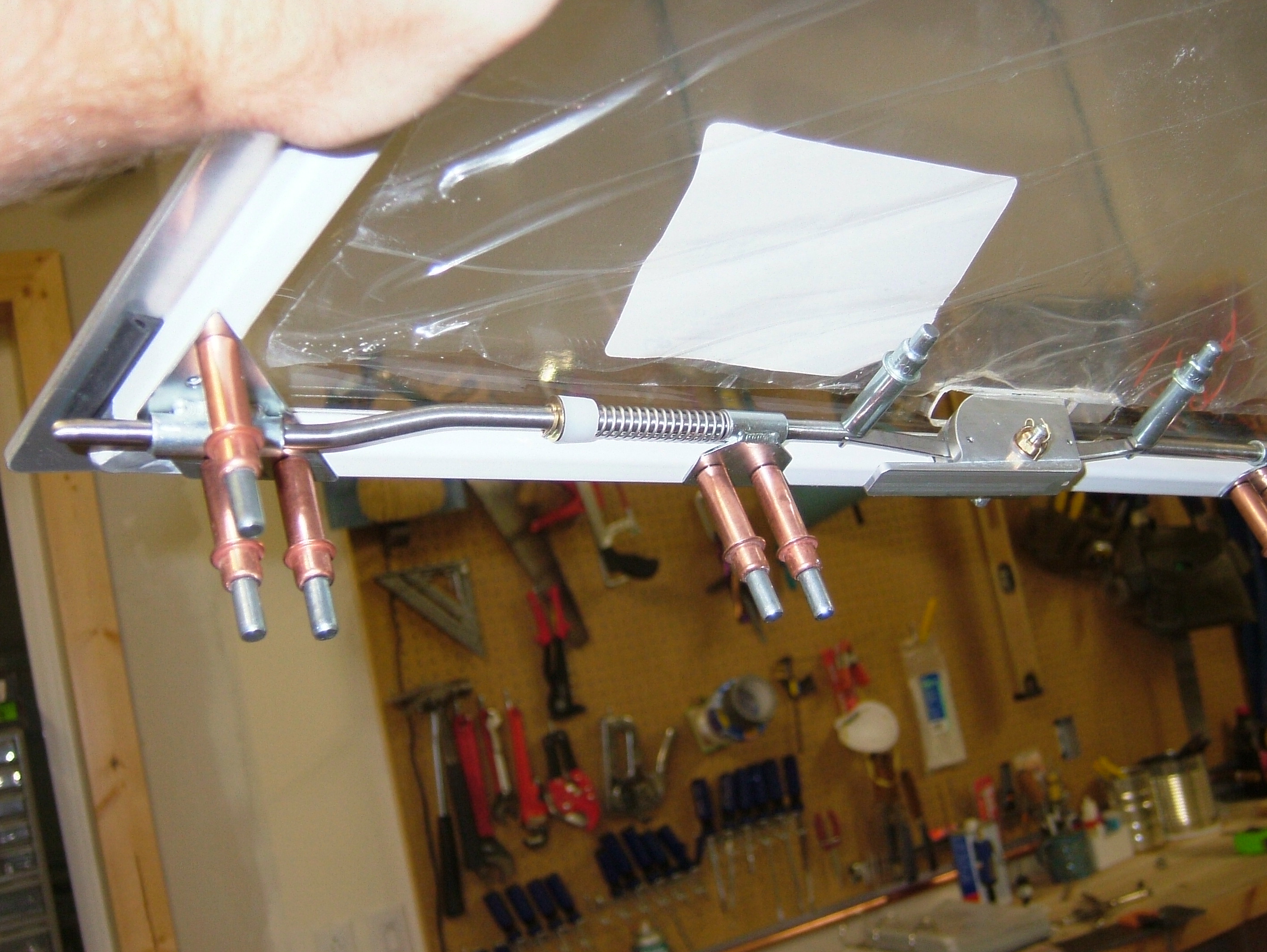

Lee,
Here is how my Series 7 latches are done. Don't know what model you have but something like this could be fitted to any door with some thought. These are the optional door latches that Skystar supplied with the kits...I would assume John McBean is still using this same setup and so you could get them from him.
 Filesize:  1.28 MB

Hi Lee,
Please put your aircraft type / status in your signature, it
helps with the answers. (I also like to see full names and locations, too.)
If you have a IV or earlier, then Lynn just posted a very
neat installation last week. It uses two pins fore and aft with a
center crank. I went for a simple latch down low. Murle Williams
makes one that I couldn't get to work so I fabricated one out of
aluminum. (Pictures tomorrow.)
