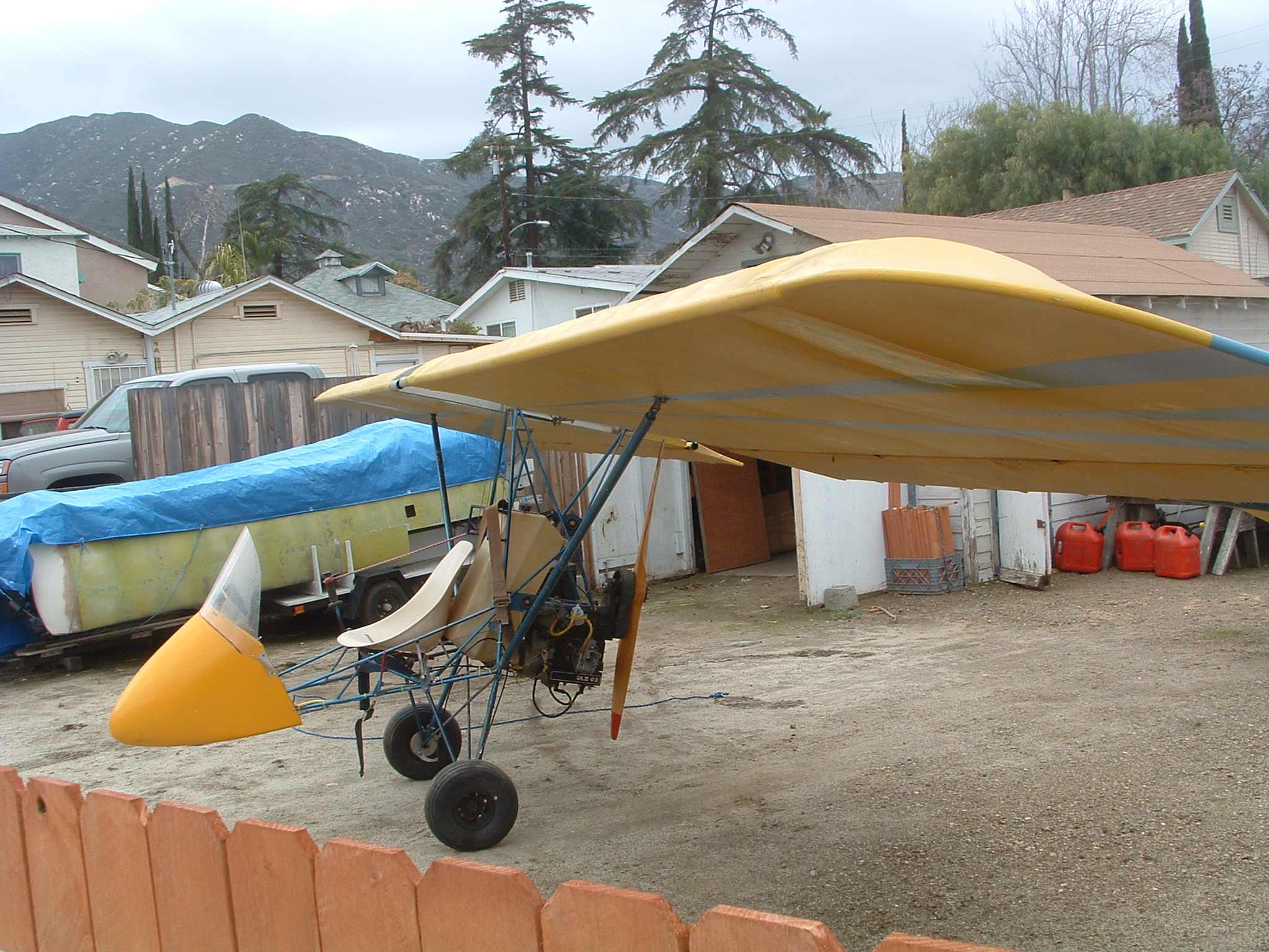

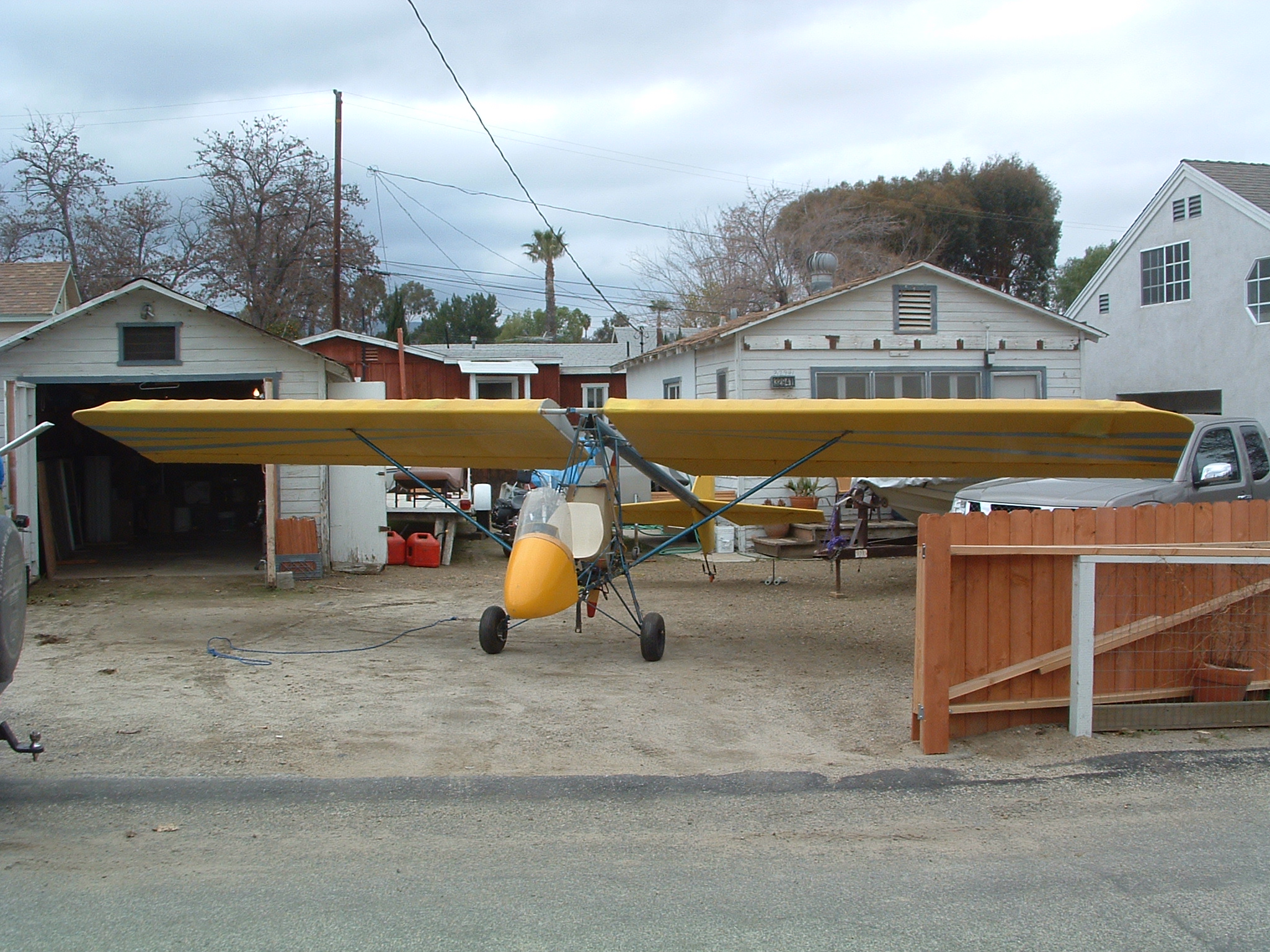

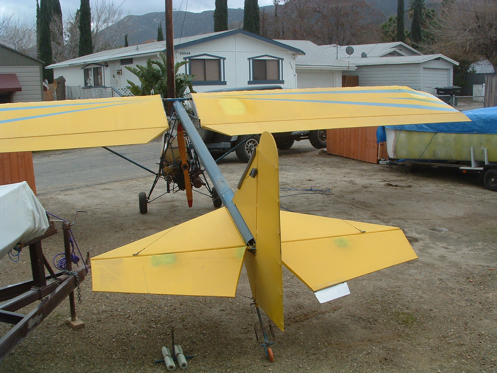

Put my UltraStar together in the driveway on Saturday and made a list of the AN- nuts and bolts I still require to replace all the important assembly bits and pieces.
No point in trusting my life to old hardware for the sake of 20 bucks.
I also fired up the Cuyuna UL-202 and warmed it up....then took it gradually to full power with the wheels chocked, and me standing there holding the thing back while playing the throttle......crikey!!!
This thing puts out a LOT more thrust than I ever imagined.
Blew the surface of my sand/gravel driveway back about 30'.
I'm sure I won't be disappointed with the take off performance!
I did however notice that it sounded more "Synced" when backed off a bit from full throttle....is that normal?
I need to get the 2nd CHT installed so I can see what is going on with that.
Ran it at full throttle for a few minutes and observed about 1425 EGT and 420 CHT. Not sure what normal would be....any ideas?
I also noticed that my patches are glossier and a different yellow in broad daylight than the original.....oh well...its just an ugly duck now I guess, but at least the patches are good and solid.
I'll fire of some pics tommorow...unfortunately my battery died while making a movie of this beast roaring away at full throttle.
Also found out that my fiber glass fuel tank holds 15 gallons....ooops...not cool for a part 103....I plan on permanentley installing a down pipe in the tank filler cap that will effectively limit my fuel capacity to 5 Gallons.
Need to recalibrate my fuel sender as well for the new limited fuel level range.
As soon as it warms and dries up a bit here I'll be taking to out to El Mirage dry Lake for some test flights....perhaps a month from now.
Looking forward to getting in the air with her finally. Hope they don't test those Predator RPV's on weekends as the dry lake is about a mile from the Predator testing base near Edwards AFB.....uh....maybe I wasn't supose to tell that part... Wink

In the meantime, here are some pics.
Ray,
Looks like your Ultrastar has negative dihedral.
Should make it a fun aircraft to fly.

I'll double check the dihedral with my laser level once I get the proper bolts, but if there is any, its probably because I used undersized temporary non AN bolts to assemble so I could take an inventory of what I needed to buy.
Thats what resulted in a slight negative dihedral.
Same thing on the elevator hookup as they were noticeably mis-aligned with my temporary undersized bolts.
Actually, having a slight bit of negative dihedral is not a bad thing, just makes the aircraft more neutrally stable in the roll axis......makes turning more effortless as it will resist rolling out better....no big deal really, and it helps considerably in crosswinds to resist weather-vaning.
