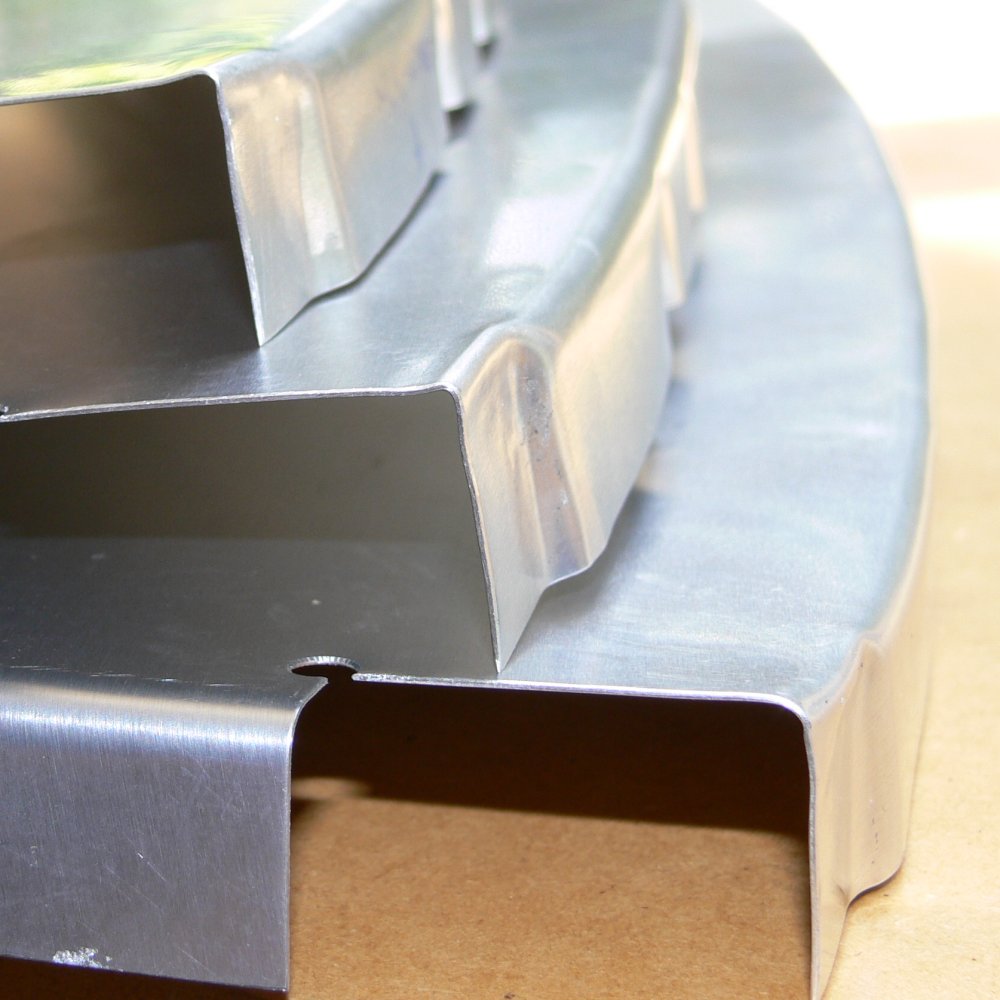

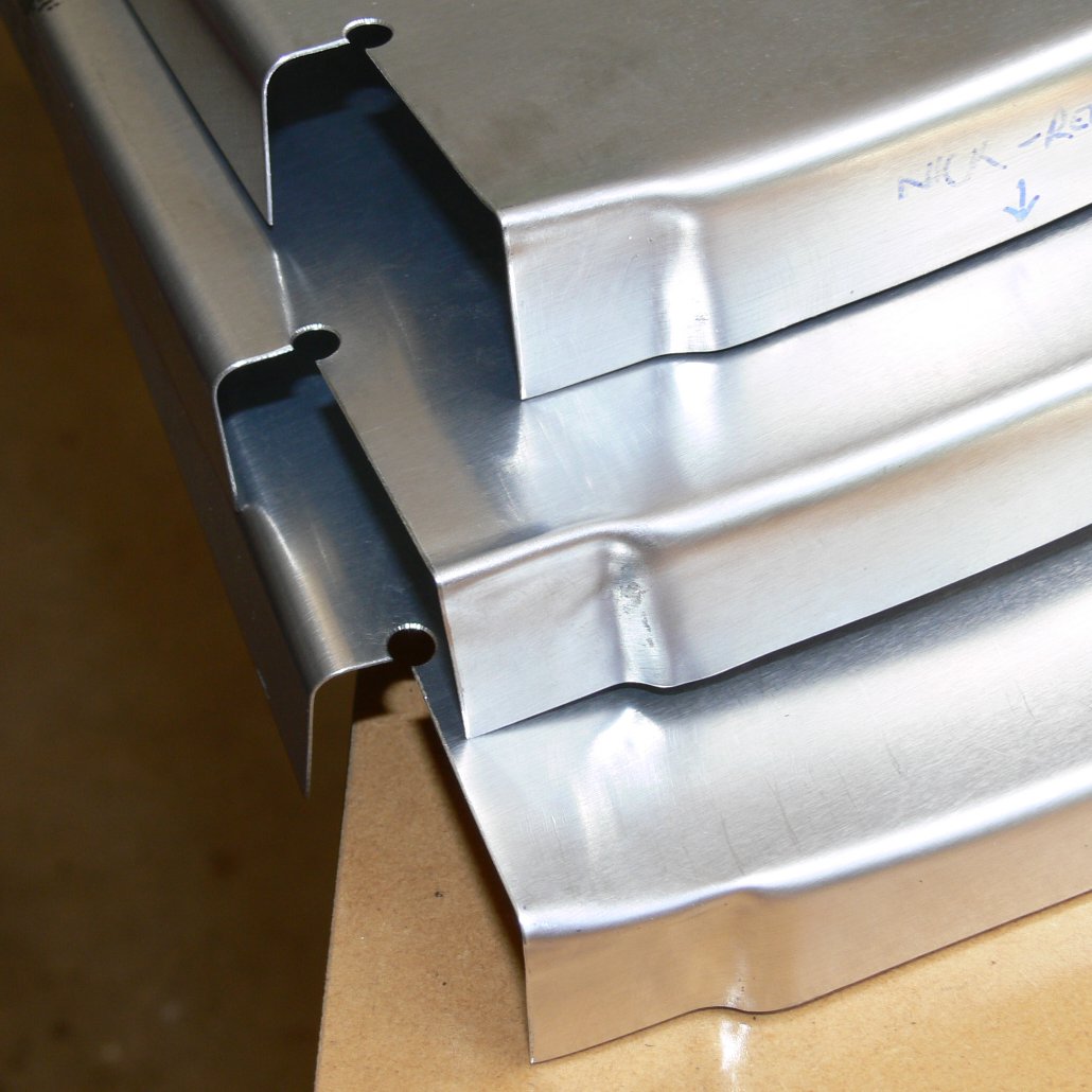

Hope you scratch builders out there can help.
Firstly, those joggles again... I have cutouts in the form blocks for them, but if I hammer them down while in the form blocks, the step created by the joggle tends to push material outwards, thus flattening and reducing the radius of the flange in that area. Please see attached images.
The Construction Standards say no radius smaller than 1.5mm, so I may be okay here, what do you think?
Also, one joggle I made was too long. Is it acceptable to flatten it out and re-do it, or is this too much panel beating for 6061-T6? Do I need to make the rib again?

The roll-out at your joggle doesn't appear to be bad at all. In the future,
you might consider a tighter clamp at that exact area when you form the
joggle.
The length of the joggle is not critical if it does not interfere with the
placement of a rivet. If it does interfere with a rivet, there may be
options, but re-bending the aluminum is not preferred. Too much bending
'work hardens' the aluminum, creating a possible crack.

I am sorta scratch building my second 701. Wings and tail are kit, the rest
I will scratch build. I did have to build a few ribs to make my long wing
extension. I used a friends forming blocks and found the same problem you
are having. I don't think it really mattered but I didn't like it. Then I
remembered that on the PegaStol ribs, they had drilled a hole where the bend
would be at every dimple. I did it on my new ribs and it fixed the problem.
You can sorta see the holes on one of the pictures on this page on my site.
http://www.skyhawg.com/ribs.html It might be worth trying.

Thanks for those of you who responded to this post. I contacted Zenith and showed them photos, Nick confirmed all is okay.
Gary, your idea of using the dowell is a good one and thanks for your other tips.
Glenn
