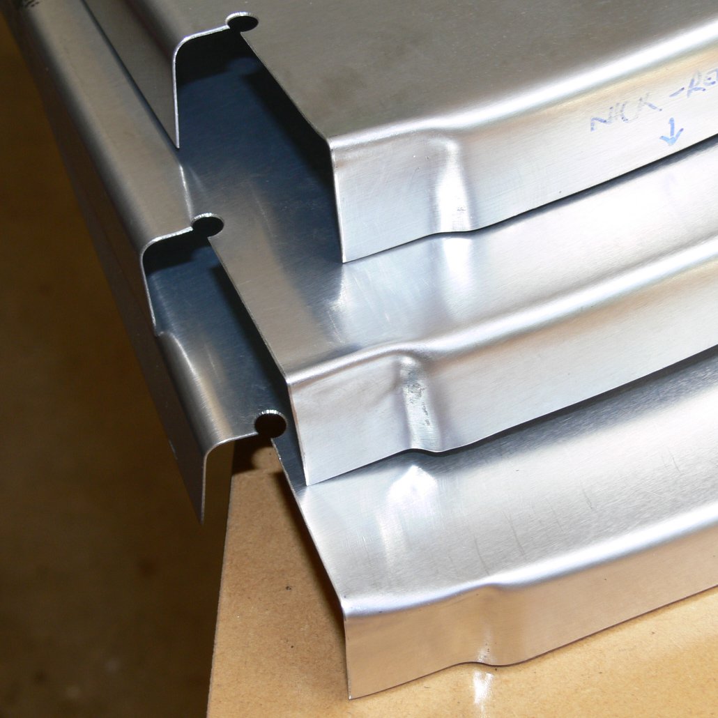

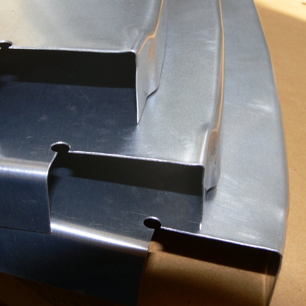

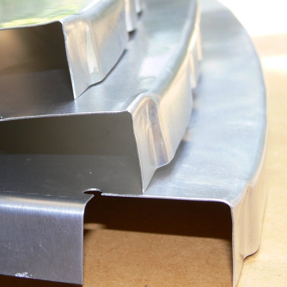

Firstly, those joggles again... I have cutouts in the form blocks for them, but if I hammer them down while in the form blocks, the step created by the joggle tends to push material outwards, thus flattening and reducing the radius of the flange in that area. Please see attached images.
The Construction Standards say no radius smaller than 1.5mm, so I may be okay here, what do you think?
Also, one joggle I made was too long. Is it acceptable to flatten it out and re-do it, or is this too much panel beating for 6061-T6? Do I need to make the rib again?

The roll-out at your joggle doesn't appear to be bad at all. In the future,
you might consider a tighter clamp at that exact area when you form the
joggle.
The length of the joggle is not critical if it does not interfere with the
placement of a rivet. If it does interfere with a rivet, there may be
options, but re-bending the aluminum is not preferred. Too much bending
'work hardens' the aluminum, creating a possible crack.

Thanks for those of you who responded to this post. I contacted Zenith and showed them photos, Nick confirmed all is okay.
