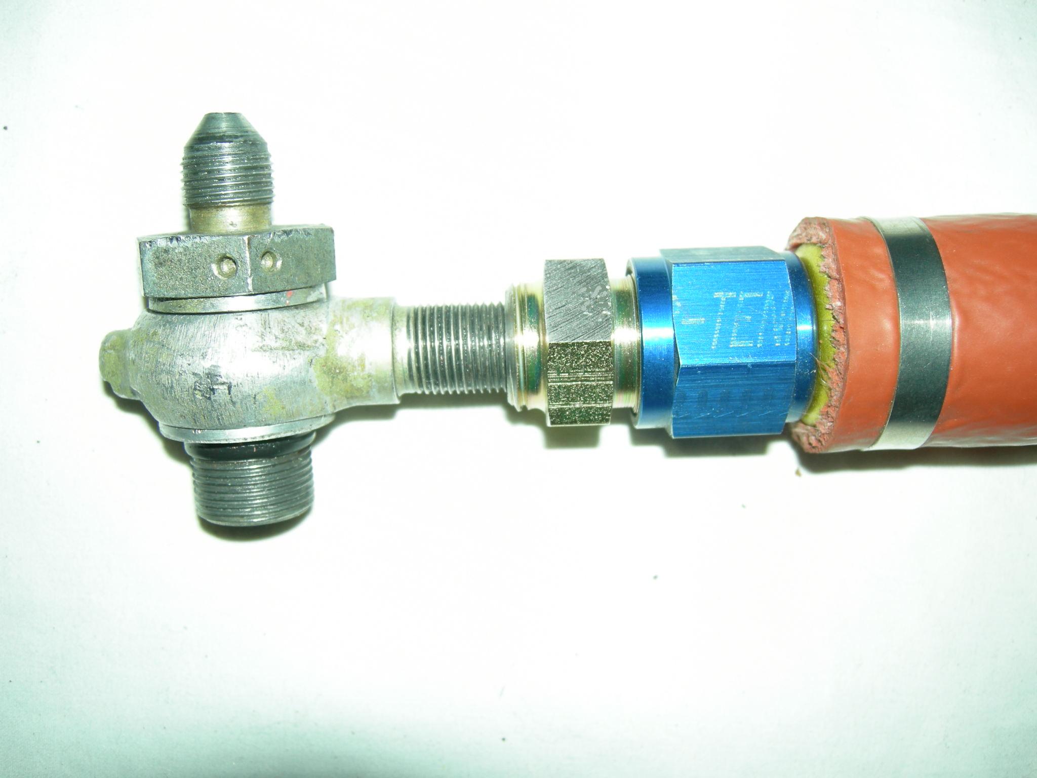

Recently I added fuel flow to a Yak 50 and a 52. Converting or upgrading the Russian hose to a US hose, 306 aeroquip or 111 stratoflex from the banjo fitting can be a pain. So, I had a machine shop make some fittings to adapt the banjo fitting to a -8 hose fitting that simply remove the hose and screw on the adapter to make the change to a -8 hose.
Check this out
