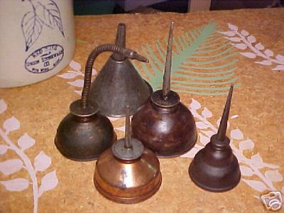

To add to Joe's experience;
Oil cans containing lubricating oil used to be made as shown in the photo. They had no pump. Their bottoms were convex (bulged to the outside). To use, one tipped the spount to the area to be lubed, and with your thumb in the center of the convex bottom, you pushed that metal which flexed from convex to concave shape. This action forced oil out the spout. When you released pressure with your thumb, the metal bottom popped back to the convex shape, ready for another push. When the can bottom was pushed in and released in this manner, it made the "dink, donk" sound described by Joe. This motion of metal flexing, along with it's associated noise, is know as "oil-canning" as it sounds like the everyday use of a old time oil can.
In the movie "The Wizard of Oz", while traveling along the Yellow Brick Road, the charectors come upon the Tin Woodsman rusted in place. Through rusted jaws, he directs them to a such a oil can which they then used to lube and free him up, with plenty of "dink,donk" sound. Ask your Kids or Grandkids!
Time for another drink,
Randy, Las Vegas
