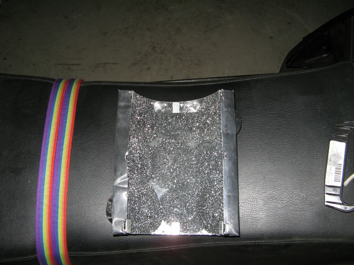

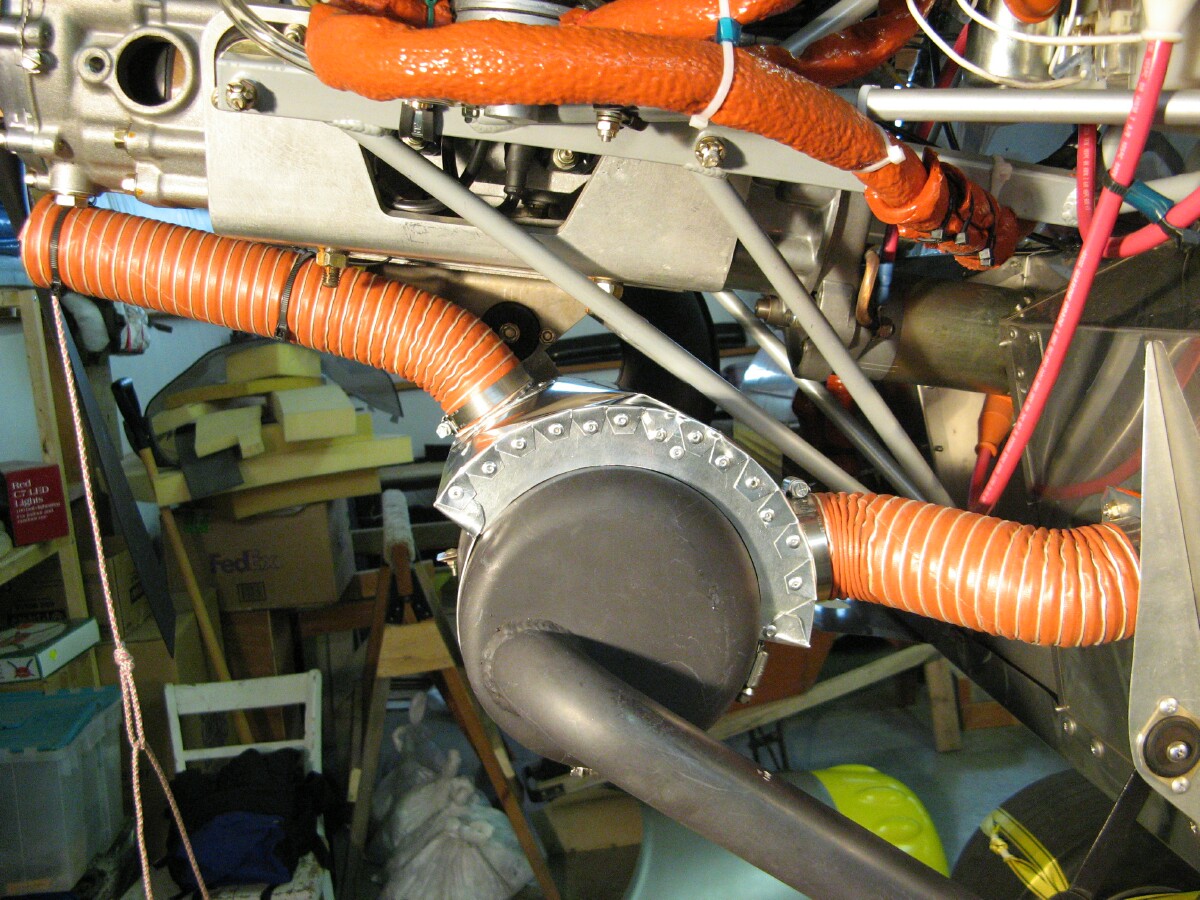

I flight tested my Cabin Heater today. It didn't hardly put out any heat at all. It is an exhaust muff on a 503 Rotax. Size of the muff is 9" X 10". There are nine pot scrubbers in the muff. 2" scat duct ram air and same size ducting to between the rudder pedals. Any suggestions to try on this one to make it work better or should I return to the drawing board? Pictures attached.

PostPosted: Sat Dec 08, 2007 5:35 pm    Post subject: kitfox heater Reply with quote
Tom sez:
heat at all.
How would you described the air flow through your tubing, Tom? Was
it blowing like a tornado or was it more like a gentle breeze?
Assuming that your muffler got nice and hot, my first suspicion is
that the air is spending too little time in contact with the heat
source.
Mike G.
N728KF
Phoenix, AZ
Lynn Matteson
Posts: 2778
PostPosted: Sat Dec 08, 2007 6:17 pm    Post subject: kitfox heater Reply with quote
I'm the furthest from real knowledgeable on heaters...I'm still
working on mine...but from what I've seen and learned, you should
have a larger outlet than an inlet. Also, with your setup, it would
be possible to put some baffles inside the muff so that the air has
to make some turns, like a labyrinth, which will make the air slow
and thereby picking up heat. If you look at your setup, the air can
flow from inlet to outlet passing through only 3 pot scrubbers. You
could install two divider baffles which would force the air to pass
through 3 scrubbers, make a 180° turn, go through 3 more scrubbers,
make another 180° turn, and go through the final 3 scrubbers, then
through the outlet. By this time the air will be heated and therefore
expanded, hence the need for making the outlet larger. I made the
mistake of making my ins and outs the same size, and this was pointed
out to me.
I made two small 3" x ~6" muffs that wrap around my Jabiru exhaust
pipes (~1400° F) and I still don't have sufficient heat. It's a
matter of slowing down the air to allow for heat transfer, yet enough
flow to do some good. I figured my exhaust pipes would be the best
source, but I'm starting to think that the muffler, with it's larger
area, would be a better, even if cooler, source of heat. Can you make
your muff larger, like build it so it wraps completely around the
muffler, or do you have cowl clearance problems?
Lynn Matteson (flying cool in Michigan) : )
Grass Lake, Michigan
flying w/440+ hrs
Tom Jones
Classic IV, Phase one
Ellensburg, WA
Lynn
Kitfox IV-Jabiru 2200
N369LM
thesupe(at)hotmail.com

PostPosted: Sat Dec 08, 2007 8:16 pm    Post subject: kitfox heater Reply with quote
Thoughts:
1. Though the inside (muffler skin) is hot, the outside is not, so
you'll only get air 1/2 as hot as you expect. Note that there's more
"cold" skin area than "hot" skin area since the cold has a larger diameter.
2. The "most direct" path from intake to exit requires very little
contact, "percentage wise" with the hot surface.
3. Virtually any air exchange at the edges will "cool" the muff.
Suggestions:
1. Coat the inside of the muff with the stick-on fiberglass/ foil
insulation. (ACS - "Heat Barrier - Adhesive Backed" PN 08-00630.) The
stuff's about 3/32" thick. This will insulate the outer skin,
preventing cooling of the pot scrubbers.
2. Install an angle to baffle flow. I think one running parallel the
muffler just "downstream" of the intake, forcing the incoming flow to
turn laterally to the outboard 2/3 of the muff would help a lot. This
angle MUST seal against the muffler.
3. Speaking of seal, figure out some kind of high temp seal for the
edges and angle baffle. I don't think you need RTV, I'm betting
there's a nice rubberish seal for metal edges that can handle the
800F or so the muffler sees. (Worst case you could figure out how to
use the spam can cowl baffle seal material.) (I checked McMaster and
they have some edge trim, (page 3619,) but it's silicone and good to
only 450F. You could try it, though.)
Guy Buchanan

Tom,
I think part of the problem is that you need a larger air inlet. My old one which I had on Rotax muffler same as yours was about 3/4 inch height and the total length of the muffer ( about 15 " maybe ) I have the round Kitfox cowl and it allows more than plenty of air into the cowl. Number of pot scrubbers 9? Well i doubt that i had more thna 4 or 5 in mine and I had a long door spring 16" long attach to each side of heat muff and stuffed inside. This acted as a retainer to hold the pot scrubbbers, yes they are only at the entrance of hte heat muff.
Oops just found this -- i forgot i did this http://www.cfisher.com/heatmuff/
I never ended up making heat muffs this week as I had a Kitfox come in for some work and on the way here the owner had a clevis pin come out on the bar that holds the wing to vertical stab while in motion on a trailer the wing started to swing out and did some damage. Almost done now and I did run it yesterday outside, it has a heater with a fan in the cabin and seem to really blow out the heat.
Here is how mine worked .
http://forums.matronics.com/viewtopic.php?t=21994
Went out for flight a while ago this AM .
OAT -13 C (9F )
Cabin temp flying 10 to 12 C ( 50 to 54 F )
So basically Heating give me approx a boost in cabin temps about 40 to 45F
increase on a overcast day and not bone chilling but still well below
freezing.

PostPosted: Sun Dec 09, 2007 6:07 am    Post subject: Re: kitfox heater Reply with quote
Thanks folks, these all sound like good logical suggestions to improve the heater.
Mike, the air flow is more like a gentle breeze. A cool gentle breeze. OAT air temperature was 29 Degrees F and I estimate inside was about 45 but I think most of that warmth was from the sun.
I'll make some mods and hope I can test again tomorrow. It's supposed to snow today.
Keep the ideas coming if you have some more anyone.

I checked earlier in shop- I had 3 pot scrubbers in heat muff.
will post some pics for you later.
A gentile breeze if all you need but you need it hot not cool and it should get real hot. I would venture to guess that you have slowed the air but you are not collecting the heat. enough. When you finally tune it in you gonna be quite happy.
Remember I have coming in about 6 or more sq inches inlet and you only have one SCAT tube. Although you are getting air fact remains that you still need to get that air hotter.
503 air outlet by plugs is used very successfully by the Challenger guys as well.

Ok I posted a few pics and info on how I made a cabin heat muff from a Rtoax 582 http://www.cfisher.com/heatmuff1/
Mine works well and the heat coming into cabin is HOT not warm.
