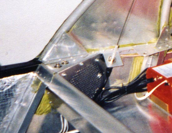

I put mine right at the front outside corners of the baggage shelf in the gusset. They work very well there, the cords are completely out of the way, but I can't easily reach them in flight and I had to cut an opening in my plywood seat back supports to allow room for the plugs to stick up there. If I were doing it again, I would put them a bit further back and maybe at an angle away from the seat back and I would make the seat backs a little narrower there to allow room to reach the cords.
| Quote: | I am getting to the point of wiring, and was interested in hearing if
anyone has tried any "unconventional" locations for the headset jacks.
| | - The Matronics Zenith-List Email Forum - | | | Use the List Feature Navigator to browse the many List utilities available such as the Email Subscriptions page, Archive Search & Download, 7-Day Browse, Chat, FAQ, Photoshare, and much more:
| Description: |
| Here's a photo, that's a speaker below the gusset. |
