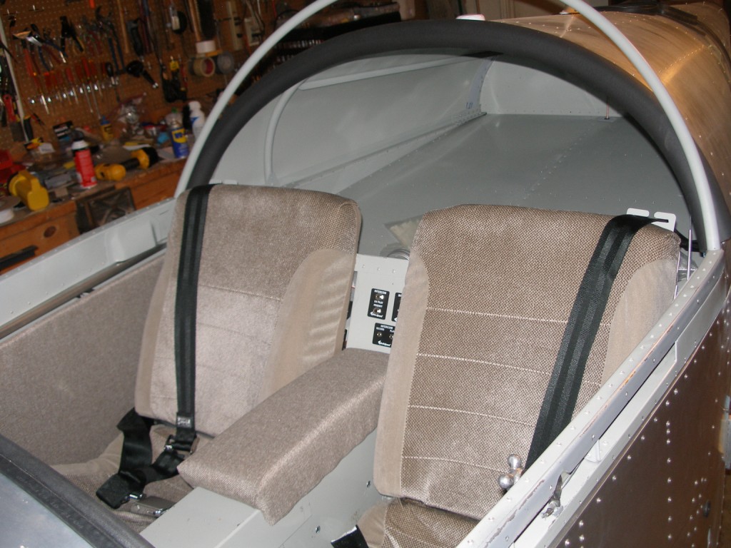

Jaybannist(at)cs.com Guest
Posted: Fri Nov 02, 2007 2:03 pm Post subject: Locations for headset jacks? |
Andy,
I installed my phone jacks where shown on the attached photo. I have not flown with this setup as yet, so I can't comment on "how it worked out." i have caught some flack from some who think that elbows will damage the plugs when they are in place. If that actually happens, I guess I will install some sort of guard around them.
Jay in Dallas 601XL N2630N
