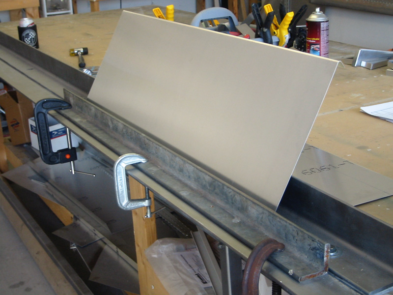

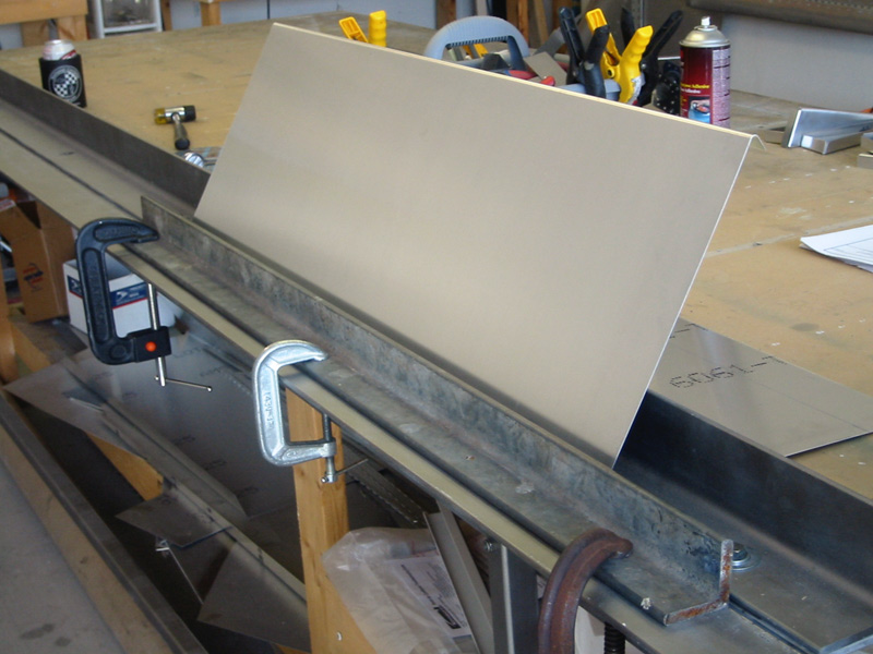

I have an 8' wooden bending brake of my own design and like Dave's brake, I couldn't do deep skins. My solution was to add a reinforced steel clamp that I think can also work on Dave's brake. Here is a picture of my brake with the steel clamp:
http://williamdominguez.myphotoalbum.com/view_photo.php?set_albumName=album10&id=115_1531_IMG_Large
I use C clamps on each side (not shown on the picture) of the skin, this limits the length to 7', but enough for skins. Here is another picture of the brake but this time it is bending a skin flange without using the steel clamps, in this one I use C clamps all along the brake:
http://williamdominguez.myphotoalbum.com/view_photo.php?set_albumName=album06&id=115_1511_IMG_Large
I made the aileron and flap middle of the skin bends using the steel clamp and it worked well. For flanges I still use the method shown in the second picture. A clamp like this would not be difficult to adapt to a steel brake like Dave's

It's all about machanics. Even though it's a wooden bending brake, with that reinforcing bar, it actually looks like it would work well.

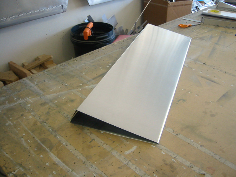

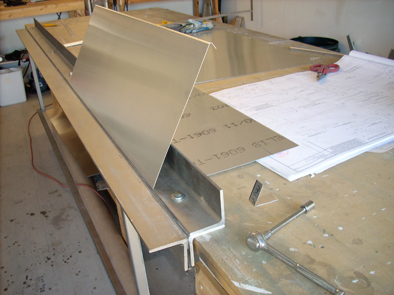

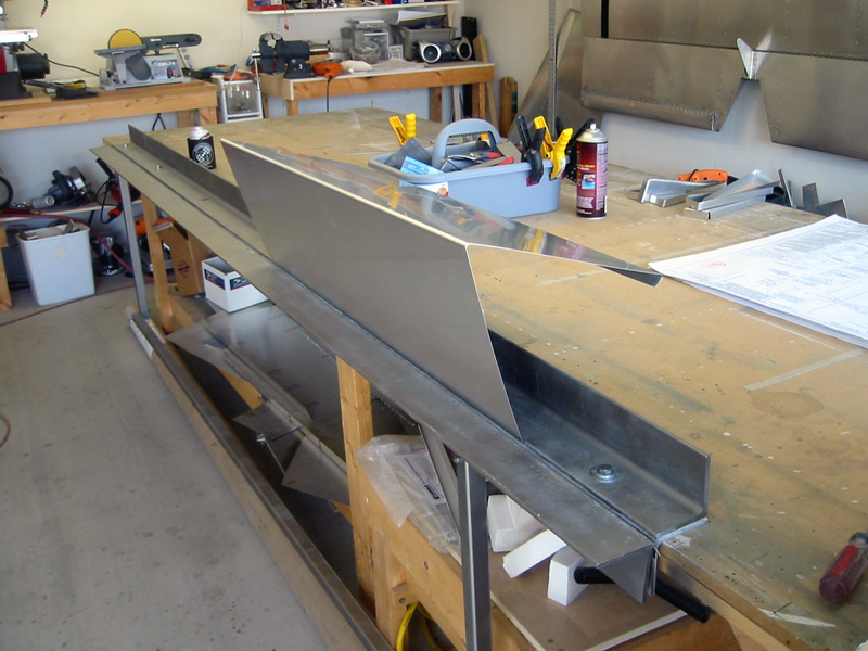

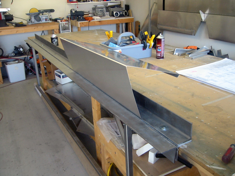

Excuse me. If you use a little of the gray matter God put between your ears, you can bend ANYTHING you'll need for the 601XL with my brake.
"Deep skins"??? I'm guessing that means control surface skins like flaps and ailerons. They are not a problem (see attached photos).
Folks...if you have any questions about the free brake plans I have been happily providing for over a year now, just ask me. Don't rely on someone else's assumptions.
Dave Clay

Hey, sorry, looks like it works well then. All I know is my brake. even made out of the same heavy steel, would not make a straight enough bend for my tastes until I put the tensioner bar on the top clamp piece. Obviously you can bend a deep wide skin and that's good. I'm just surprised it can do it without the tensioner. Without the tensioner on mine, I noticed a slight banana shape to the part. If you can get away without the tensioner for some reason that's great, I'm honestly surprised it doesn't need one considering the distance between the clamp bolts.

Dave, how do you keep the clamp from deflecting on a deep skin that's rather wide? I'm using the same type of angle iron (1/4" thick by 3.5" by 3.5") and without my tensioner in the middle, the clamp nose (is that what it's called) deflects a bit. Maybe the way you have it laying flat versus mine inverted with the two edges down like an upside down V tends to deflect more? I don't know? I'm just curious. As beefy as those angle irons are, over an 8' span between clamp points is still a lot of pressure pushing in. Granted, the largest full width skin is the elevator, and in general the skins are .025 and less. Even so, it only takes a millimeter difference in the middle vs the ends to eff up your day. Smile
For bending brakes that really only require hand tools to make though, I think they're both good.

PostPosted: Mon Oct 29, 2007 9:19 pm    Post subject: Re: Larger Brake Reply with quote

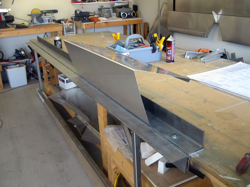

Hey Andy,
The top piece of angle (I call it the top plate) is flat against the aluminum. I have pretty large bolts running through my table and a 1x4 board attached under my table for strength. I'm no engineer...so I don't have a technical explanation. It just works, that's all I know.
Dave

As I see it, your brake is excellent for spars for sure. The really difficult part is when you have to have clamp points for the bolts only at the ends of the top plate (like when doing a wide deep skin). No different than my brake when doing a piece like that. You really have to keep that top plate from flexing. As far as the bottom plate (the bender), your brake has an advanage there in that it's supported along the entire length where as mine is designed like Larry's brake, pivots on the ends. That being the case I need a tensioner on the bottom as well as the top, but it works well. I'm just wondering about the mechanics of the top plate on yours and why it manages to stay put even though for a wide deep skin it's only bolts at the ends with a good 7 foot stretch between clamp points.
In addition to my tensioner bars I've considered going back and adding another welded plate inside of the upside down V as additional support, same with the bending tongue. It works for now, but as I use it I see better ways to design it. A welded plate would add a lot more reinforcing to keep the angles from warping as pressure is applied. A tube (triangular tube in this case) is a lot stronger than an angle. If you put a micrometer on mine when under force you'd probably see the dimension between the two angle legs decrease in the middle by a millimeter or two. Pretty amazing that even steel will flex that much when bending a piece of aluminum, but the process of making a proper bend in aluminum is deceptively more complicated that it would first appear.
