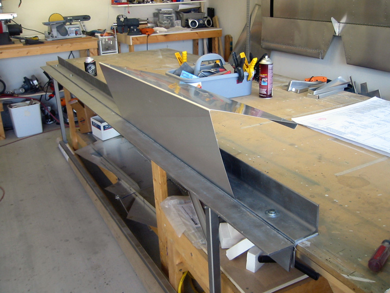

Excuse me. If you use a little of the gray matter God put between your ears, you can bend ANYTHING you'll need for the 601XL with my brake.
"Deep skins"??? I'm guessing that means control surface skins like flaps and ailerons. They are not a problem (see attached photos).
Folks...if you have any questions about the free brake plans I have been happily providing for over a year now, just ask me. Don't rely on someone else's assumptions.
Dave Clay

I'm with Dave on this one. I've bent every piece of metal on my airplane with the simple, effective, inexpensive brake he designed and my standards are pretty high. Granted, sometimes it takes an extra piece of angle or "c" clamp or two, but if you can't get the results you're looking for, you ain't using your noodle enough.
For the scratchbuilder, I really view a cost-effective, functional bending brake as a "deal breaker." If you don't have one, it ain't gonna happen. There are a actually a few good designs out there. Choose the one that works for you. I chose to experiment with Dave's design and have found it to be more than adequate for bending anything on the XL. If you use it in conjunction with Larry Winger's Excel Bend Line Spreadsheet, you're bending like the big boys.
Personally, I'd like to thank both of these guys for sharing their innovative ideas with this list at no charge to any of us. After all, if I could have come up with something better myself, then I wouldn't have needed their ideas in the first place, huh?

Hey, sorry, looks like it works well then. All I know is my brake. even made out of the same heavy steel, would not make a straight enough bend for my tastes until I put the tensioner bar on the top clamp piece. Obviously you can bend a deep wide skin and that's good. I'm just surprised it can do it without the tensioner. Without the tensioner on mine, I noticed a slight banana shape to the part. If you can get away without the tensioner for some reason that's great, I'm honestly surprised it doesn't need one considering the distance between the clamp bolts.

Dave, how do you keep the clamp from deflecting on a deep skin that's rather wide? I'm using the same type of angle iron (1/4" thick by 3.5" by 3.5") and without my tensioner in the middle, the clamp nose (is that what it's called) deflects a bit. Maybe the way you have it laying flat versus mine inverted with the two edges down like an upside down V tends to deflect more? I don't know? I'm just curious. As beefy as those angle irons are, over an 8' span between clamp points is still a lot of pressure pushing in. Granted, the largest full width skin is the elevator, and in general the skins are .025 and less. Even so, it only takes a millimeter difference in the middle vs the ends to eff up your day.
For bending brakes that really only require hand tools to make though, I think they're both good.
| TxDave wrote: | OK, I'll chill out, Bill. Thanks for your concern about my health. I just wanted to make sure folks who might be considering building from plans are getting the straight poop on my brake. Andy's a good guy who frequently takes the time to be an active member of this group. Nothing wrong with stimulating a good discussion.

The top piece of angle (I call it the top plate) is flat against the aluminum. I have pretty large bolts running through my table and a 1x4 board attached under my table for strength. I'm no engineer...so I don't have a technical explanation. It just works, that's all I know.

As I see it, your brake is excellent for spars for sure. The really difficult part is when you have to have clamp points for the bolts only at the ends of the top plate (like when doing a wide deep skin). No different than my brake when doing a piece like that. You really have to keep that top plate from flexing. As far as the bottom plate (the bender), your brake has an advanage there in that it's supported along the entire length where as mine is designed like Larry's brake, pivots on the ends. That being the case I need a tensioner on the bottom as well as the top, but it works well. I'm just wondering about the mechanics of the top plate on yours and why it manages to stay put even though for a wide deep skin it's only bolts at the ends with a good 7 foot stretch between clamp points.
In addition to my tensioner bars I've considered going back and adding another welded plate inside of the upside down V as additional support, same with the bending tongue. It works for now, but as I use it I see better ways to design it. A welded plate would add a lot more reinforcing to keep the angles from warping as pressure is applied. A tube (triangular tube in this case) is a lot stronger than an angle. If you put a micrometer on mine when under force you'd probably see the dimension between the two angle legs decrease in the middle by a millimeter or two. Pretty amazing that even steel will flex that much when bending a piece of aluminum, but the process of making a proper bend in aluminum is deceptively more complicated that it would first appear.
