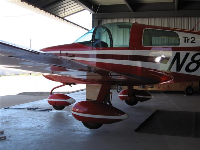

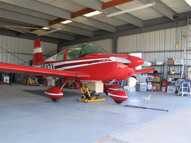

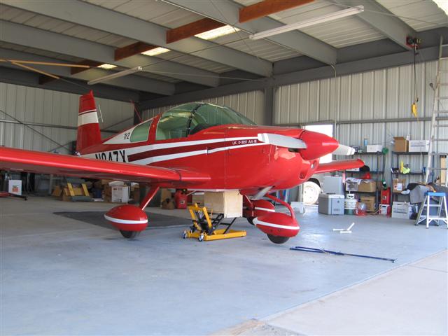

Harbor Freight sells a 1500lb ATV/Motorcycle lift that will pick up the
whole airplane. I am using this on a Grumman Yankee (a.k.a. RV Trainer)
and it works great! I built a box to fit on the rails and topped it with
a piece of plywood and the pink hard foam from Home Depot. Just center
the lift under the CG and service all three wheels at once.

Can you do that to an RV without damaging the bottom of the fuse?

PostPosted: Tue Oct 23, 2007 5:17 pm    Post subject: Gear Legs Reply with quote
Pictures:
The 1 1/2" hard pink foam gets poked by the odd nut sticking out but it
supports the weight of the plane without crushing. On the RV and the
Yankee, the CG is on the flat part of the bottom where the spar is
located. The top of my platform is about 18" x 40" or about 5 square
feet. The pressure on the bottom of the fuselage would be about 1200/5
or 240 lbs/sq.ft.
