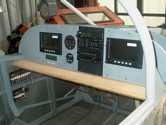

I'm doing just that except on the left side. They will have an access panel
in the sidewall. They are screwed directly to the fuselage skin with dimples
and CS screws. I have added a 12-slot and 2, 6-slot blocks (aux & bat
busses) since the picture was taken. I've got fuses for EVERYTHING.

PostPosted: Sat Oct 06, 2007 1:30 pm    Post subject: Fuse panel location Reply with quote
Eric Newton wrote:
<enewton57(at)cableone.net>
Here is a webpage from my Bearhawk builder's site on how I set up my
Fuse panel which is hinged and can swing out for easy access.
http://mybearhawk.com/finish/electrical2.html
I'll try to get some pictures later tonight, but for everyone using
these fuse blocks...
You can get 90* 1/4" push-on fittings. I (fortunately) have a friend
with the expensive crimper, 'cause he uses bags of them in his
business. These are VERY nice to have when you're trying to fit the
fuse-block in a tight space like Eric is doing.
Mark Phillips in TN

Great job on documenting your work for the Bearhawk Eric. You should be
an instructor. I will borrow your swing out panel idea or build a swing
down panel using a cut-out portion of my avionics shelf on the co-pilots
side.
Question: Where did you get the electronic amp sensor? Great idea. Also,
it looks like you did not use a shunt in front of your ANL?
PostPosted: Wed Oct 10, 2007 4:44 am    Post subject: Fuse panel location Reply with quote
Thanks for the kind words.
The donut AMP pickup device goes with my Grand Rapids EIS system (as an
option you have to purchase). No shunt needed with the amp device.
