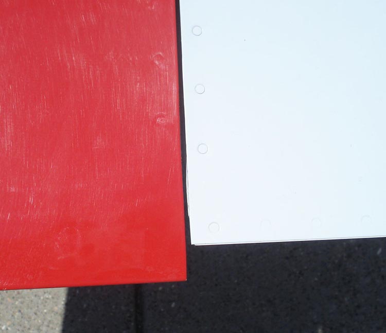

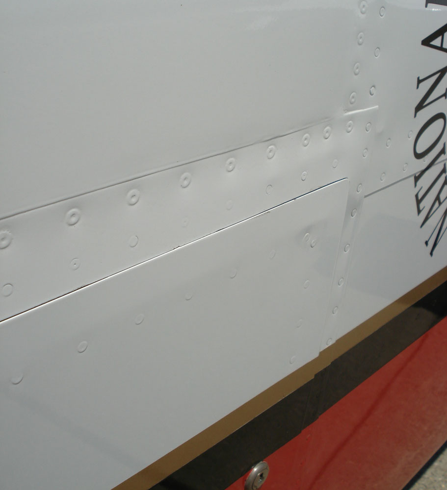

I know nothing about the incident but I actually know something
about this plane.
While at my home airport (SBP) in California I saw an RV-10
parked in our transient restaurant parking. I was very excited to see
one in person and it looked kinda nice from a distance. As I got closer

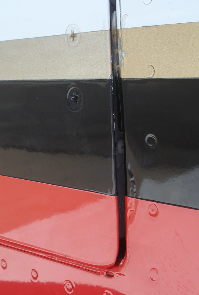

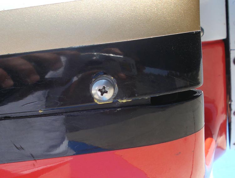

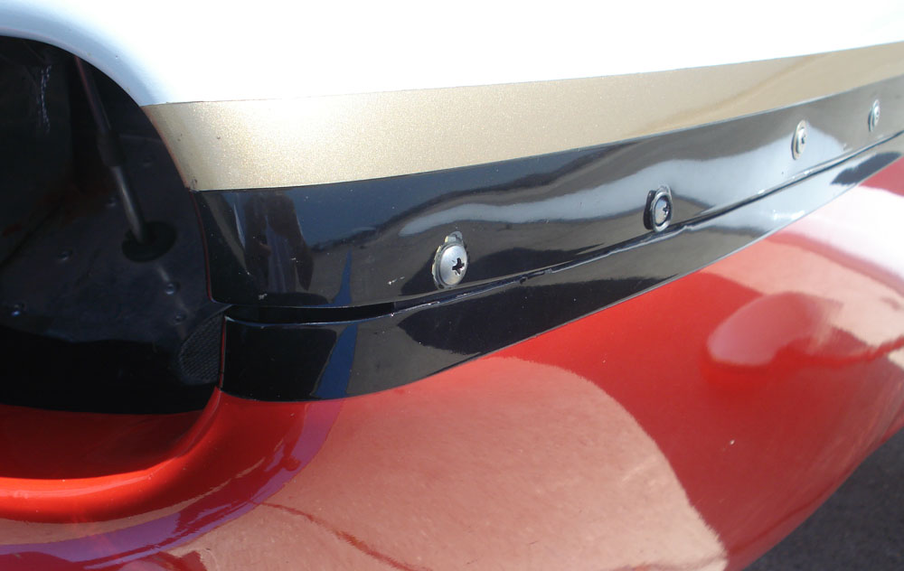

my opinion changed considerably. First the good news... The wheel pants,
gear legs and the panel were very nice. Now the rest of the story...
The fit & finish was about the worst I had ever seen on an RV.
The fit around the cowl was horrendous, with several different type
screws used with different type washers and the cowl screws were not in
a row, some were offset high and low. The baggage door was not aligned
well and there was filler between some metal pieces that was only
partially filled and partially left "mounded" then painted over. It
looked awful!. The wing tips were not cut back to match the trailing
edge of the ailerons. (I have not started that part of the build yet but
I understand they should line up).

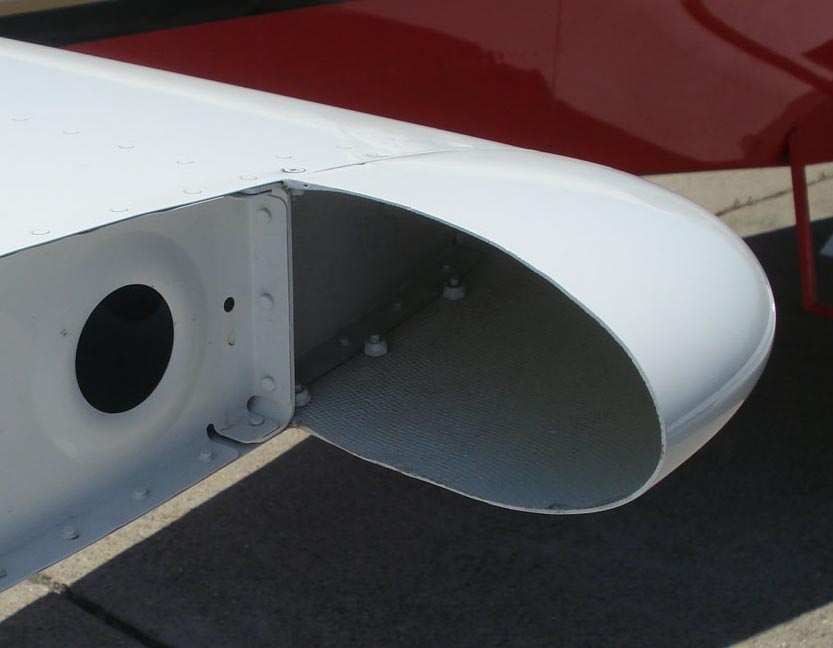

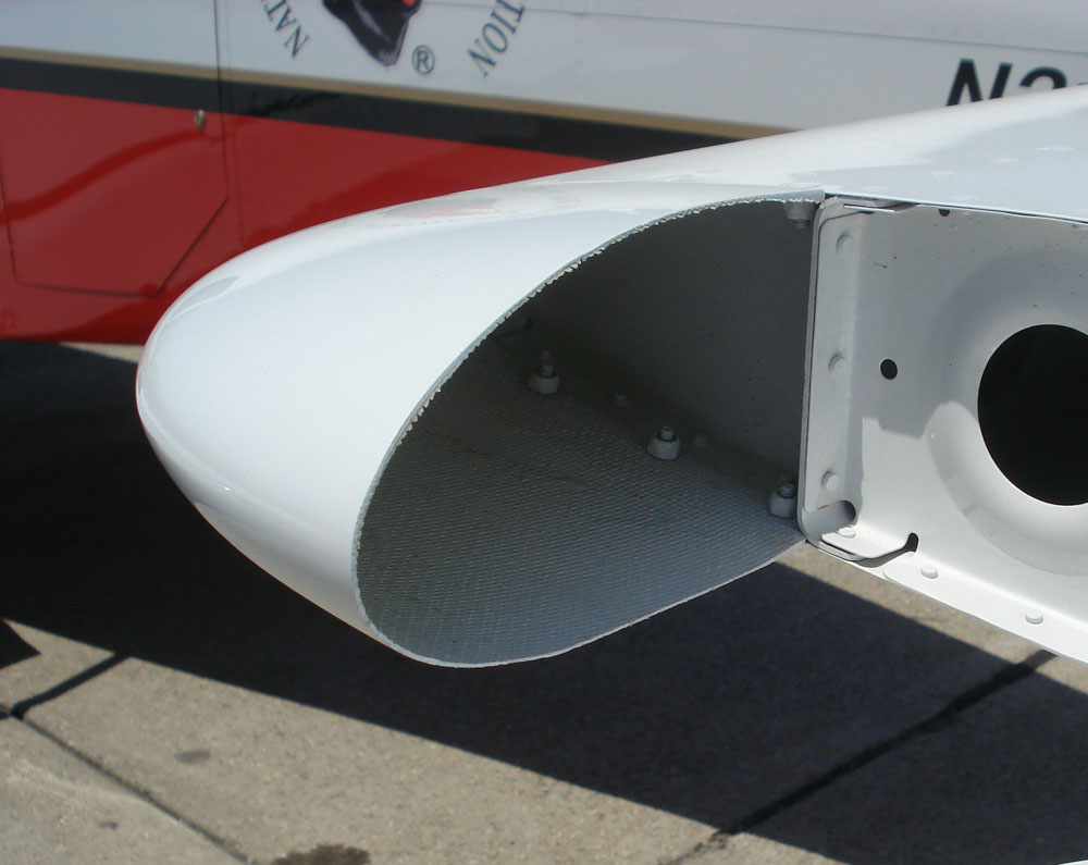

By far the worst part and something I thought was a real danger
were the back sides of the fiberglass tips to the horizontal stabilizer.
They were left hollow, rough cut and very flexible. I was actually
horrified that this portion of the build was not completed. I could not
imagine that that was airworthy. As you can guess the fit of the doors
was not acceptable to me but they were not that far off. And of course
there was complete cracking around each window. I did end up taking some
detailed photos of the plane and keep them filed in my "RV Pictures"
folder under the file name "Ugly RV-10." I don't intend to be cruel but
the attention to detail was completely lacking and all that hard work of
construction was wasted by not spending 200-400 more hours on doing
things right. One of my first thoughts was if the appearance items look
this bad I wonder what it's like in places you don't easily see.
As I was finishing my photo shoot the owner came out from the
restaurant and we had the opportunity to chat. She was an older lady
(~65) that had purchased the plane from Alabama/Mississippi or the like.
She was based at Santa Paula Airport (SZP) about 70 miles south of me.
That day she was giving a hangar neighbor acquaintance of mine a ride to
SZP to pick up his beautiful Cessna 170 from service. I remember
thinking to myself... well at least the plane has two pilots onboard in
case there is an "issue."
Please note I do not wish to be malicious but the plane had
obvious flaws in craftsmanship. Like most incidents it's usually pilot
problems before plane problems.
Attached are some photos from the visit.
Robin

Deems Davis
Joined: 09 Jan 2006 Posts: 925
Posted: Sun Sep 16, 2007 9:36 am Post subject: RV-10 Incident |
This plane was built by John Nys who is in Texas. He has built several
RV-10's and is one of the 'build for hire' gang. He had a couple of his
plane (at) OSH in '06 and they displayed the same workmanship issues noted
in Robins e-mail. He boasted to some that he could build a plane in 3
months. To be fair I understand that he also built/assisted in the
construction of Alex D.'s -10 which is cosmetically better.
Deems Davis # 406
'Its all done....Its just not put together'
http://deemsrv10.com/

Tim Olson
Joined: 25 Jan 2007 Posts: 2882
Posted: Sun Sep 16, 2007 10:32 am Post subject: RV-10 Incident |
I'll always remember looking at that plane unpainted at OSH, with
a wire bundle running from the panel to the tunnel near the brake
lines, with the wires clearly laying on the sheet metal edge
of the tunnel cover....with no wire chafing protection at all.
That was just the start of it, but I just kind of figured some
day it would be an electrical fire that we'd hear about. Especially
since very little of the sheet metal edging had much deburring done
to it.
On the up side, there are many very fine examples of craftsmanship
to look at these days, and many builders are taking the time to
make them far better than any production plane.
to it.

Robin Marks wrote:
> Interesting...
> about this plane.
> Robin
