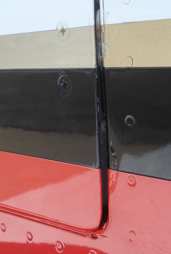

While at my home airport (SBP) in California I saw an RV-10
parked in our transient restaurant parking. I was very excited to see
one in person and it looked kinda nice from a distance. As I got closer

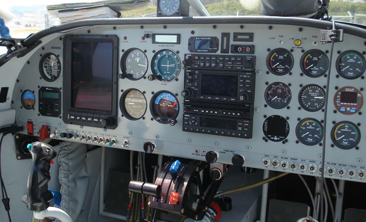

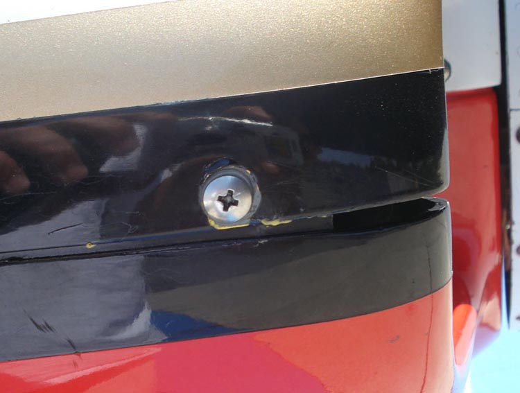

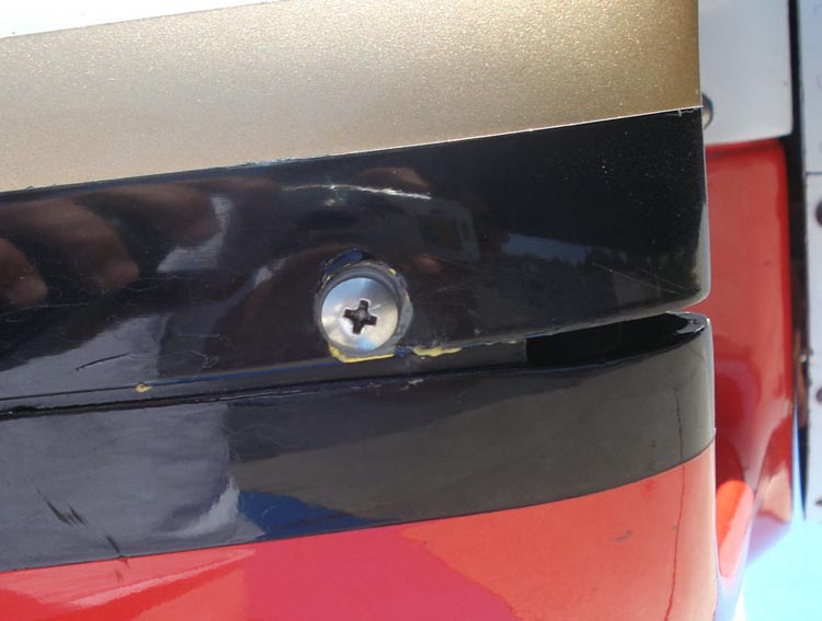

my opinion changed considerably. First the good news... The wheel pants,
gear legs and the panel were very nice. Now the rest of the story...

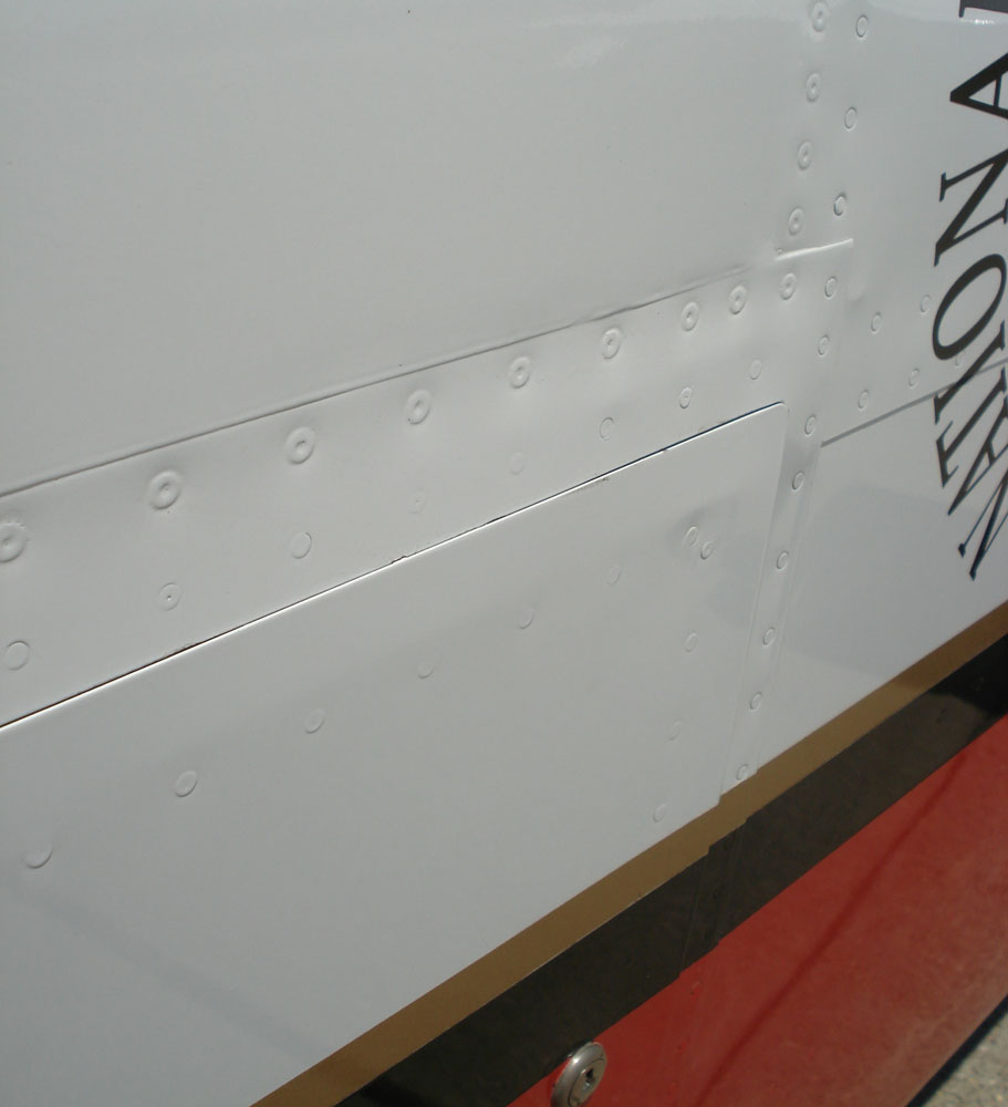

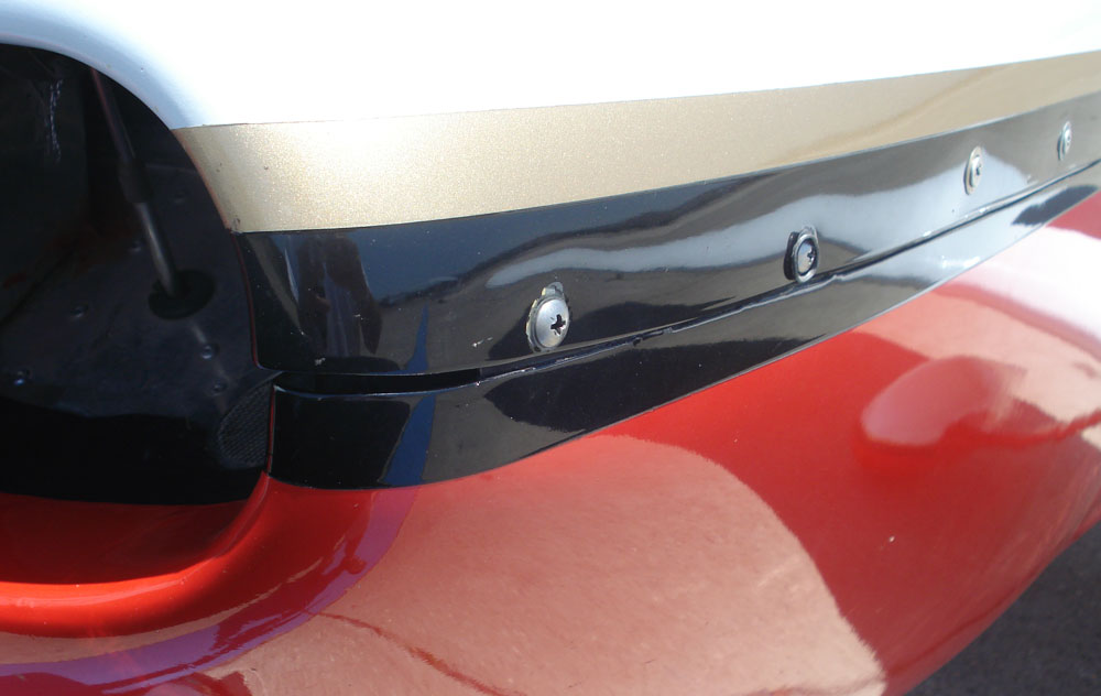

The fit & finish was about the worst I had ever seen on an RV.
The fit around the cowl was horrendous, with several different type
screws used with different type washers and the cowl screws were not in
a row, some were offset high and low. The baggage door was not aligned
well and there was filler between some metal pieces that was only
partially filled and partially left "mounded" then painted over. It

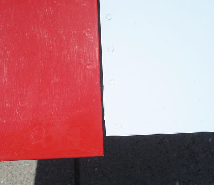

looked awful!. The wing tips were not cut back to match the trailing
edge of the ailerons. (I have not started that part of the build yet but
I understand they should line up).

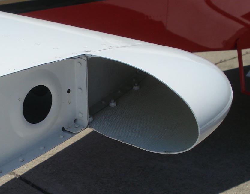

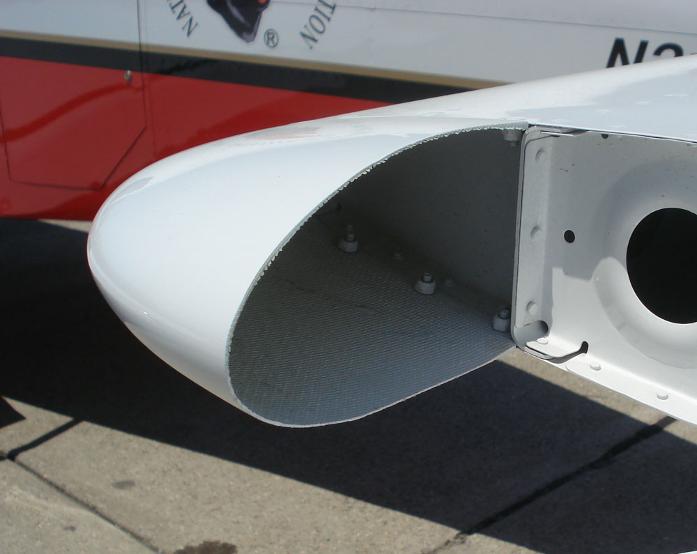

By far the worst part and something I thought was a real danger
were the back sides of the fiberglass tips to the horizontal stabilizer.
They were left hollow, rough cut and very flexible. I was actually
horrified that this portion of the build was not completed. I could not
imagine that that was airworthy. As you can guess the fit of the doors
was not acceptable to me but they were not that far off. And of course
there was complete cracking around each window. I did end up taking some
detailed photos of the plane and keep them filed in my "RV Pictures"
folder under the file name "Ugly RV-10." I don't intend to be cruel but
the attention to detail was completely lacking and all that hard work of
construction was wasted by not spending 200-400 more hours on doing
things right. One of my first thoughts was if the appearance items look
this bad I wonder what it's like in places you don't easily see.

Attached are some photos from the visit.
Robin

I'll always remember looking at that plane unpainted at OSH, with
a wire bundle running from the panel to the tunnel near the brake
lines, with the wires clearly laying on the sheet metal edge
of the tunnel cover....with no wire chafing protection at all.
That was just the start of it, but I just kind of figured some
day it would be an electrical fire that we'd hear about. Especially
since very little of the sheet metal edging had much deburring done
to it.
to it.

Robin Marks wrote:
> Interesting...
> I know nothing about the incident but I actually know something
> about this plane.
> As I was finishing my photo shoot the owner came out from the
> restaurant and we had the opportunity to chat. She was an older lady
> (~65) that had purchased the plane from Alabama/Mississippi or the like.
> She was based at Santa Paula Airport (SZP) about 70 miles south of me.
> That day she was giving a hangar neighbor acquaintance of mine a ride to
> SZP to pick up his beautiful Cessna 170 from service. I remember
> thinking to myself... well at least the plane has two pilots onboard in
> case there is an "issue."
> Please note I do not wish to be malicious but the plane had
> obvious flaws in craftsmanship. Like most incidents it's usually pilot
> problems before plane problems.
> Robin
