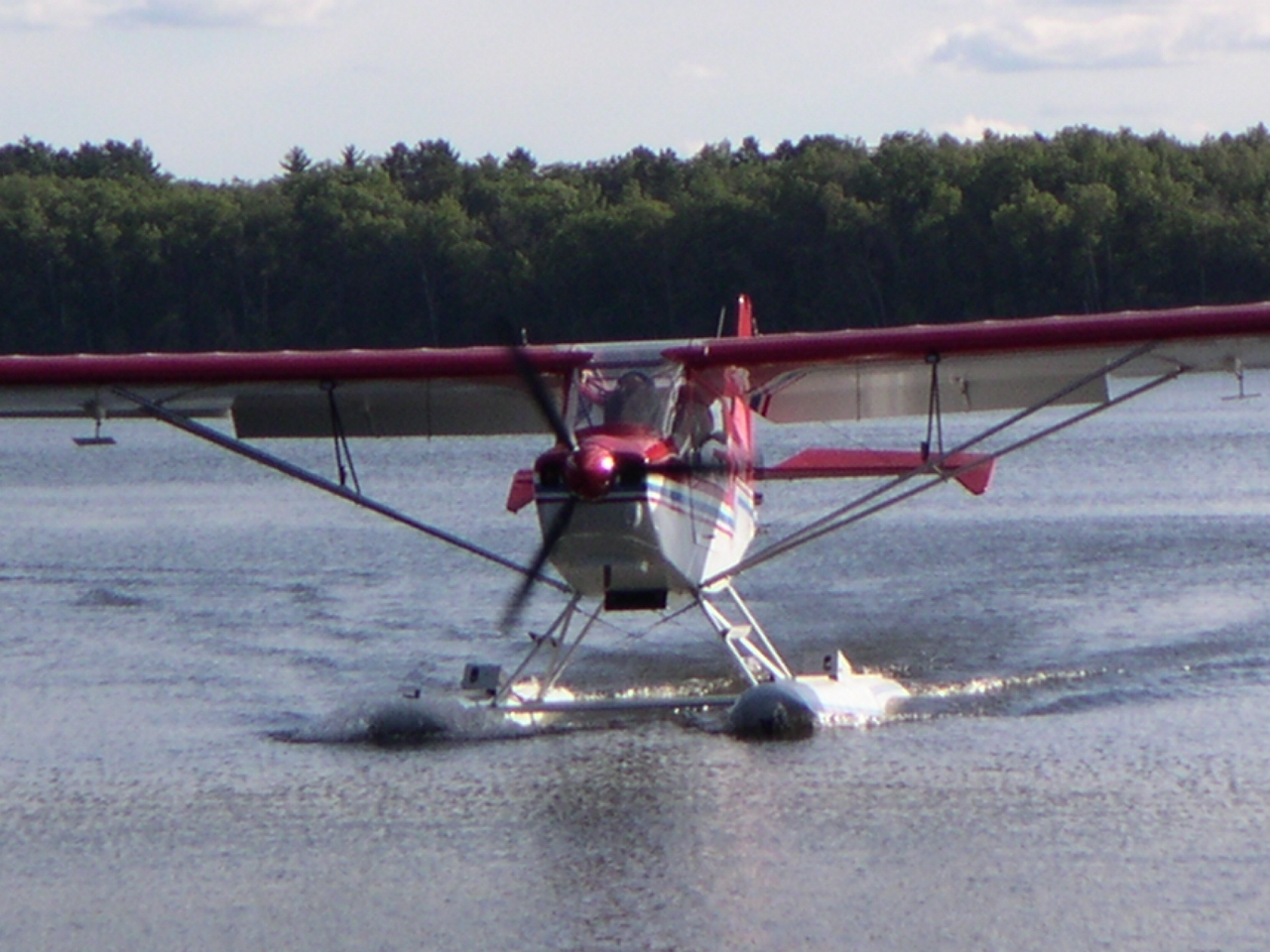

PostPosted: Tue Sep 25, 2007 3:27 pm    Post subject: czech floats Reply with quote
Greg,
I have 25 years of float flying experience, with a total of 2200 hrs in
seaplanes. 1300 hours of that seaplane time has been in various light sport
type aircraft. I have a bit more than 30 hours in an amphibious Czech float
equipped Rans S-7 with a Rotax 100 hp 912s for power. Aircraft empty weight
on wheels around 670 lbs, and right close to 900 on floats. The floats are
the 4 wheel option 1150/1200a amphibs.
The floats work, but lack forward floatation, as well as total floatation
for the Rans (note how low the spreader bars are to the water in the
attached picture. Also, the rear seat passenger weight is actually is
helping keep the front of the floats up. Otherwise the bows would be
plowing water over the top when idling). The landing gear has no
suspension, and while the main gear does have a down lock, the nosegears are
held down purely by hydraulic pressure, consequently causing concerns about
gear collapse in the case of hydraulic failure, The hydraulic cyls also tend
to leak when sitting with the weight of the airplane on them. The other
problem with the floats is that they are approx 15 1/2 ft in length, and
that causes you not to be able to rotate well without dragging the heels
(which will consequently also keep you from leaving the water). This a a
common problem with many older float designs as well. While a long float
offers a nice ride and lots of good tracking and stability, they limit your
ability to take off short because you can't rotate into a steep attitude.
For those reasons I personally would always choose a short float over a long
one if the floatation was similar. Oh yeah, a Rans S-7 is longer than my
Kitfox IV by almost 5 ft, so the Kitfox would really suffer from not being
able to rotate due to the float being so long for the airplane. The Czech
floats on this Rans also only have 2 watertight compartments / pump outs.
That would never pass muster for a certified float, as it puts the airplane
at risk of capsizing if ever one compartment were to leak and fill with
water. The good news there is that the later Czech floats are known for not
leaking much water. But if you ever hit an underwater obstruction and poke
a hole in your float, you have little or no reserve buoyancy with 50% of one
float only left watertight.
Another thing I don't like about the Czech floats is they are
hydrodynamically very draggy. Example, last time I flew this Rans I was
doing a downwind takeoff in a 10 mph wind and no matter what I did I
couldn't get enough forward water speed to lift off. I tried everything,
but finally stopped and turned into the wind and took off no problem. That
whole issue is caused by too much reveted skin area causing excess water
drag and limiting the ability to accelerate on the step. And being that I
fly my Aerocet equipped Kitfox also, I guess I am spoiled as downwind
takeoffs are never a problem, even though I have 20 hp less than the Rans,
and less wing area. The Aerocets having a smooth fluted bottom have let me
acclerate easily for a takeoff at gross weight in a 25+ mph downwind before
(ps - don't try this at home - I've been flying floats for a lot of years...
Go into the wind like our flight instructors tell us to). I also don't like
the fact that there are no storage areas in the czech floats.
Ok, so what do I like about the Czech floats? Ground handling is good, and
brakes work pretty good or an amphib. Water rudders are sufficiently sized,
and the floats will get you off the water relatively quick as they use a
pretty flat bottom. Of course, since nothing is ever free, rough water is
not the Czech floats forte.

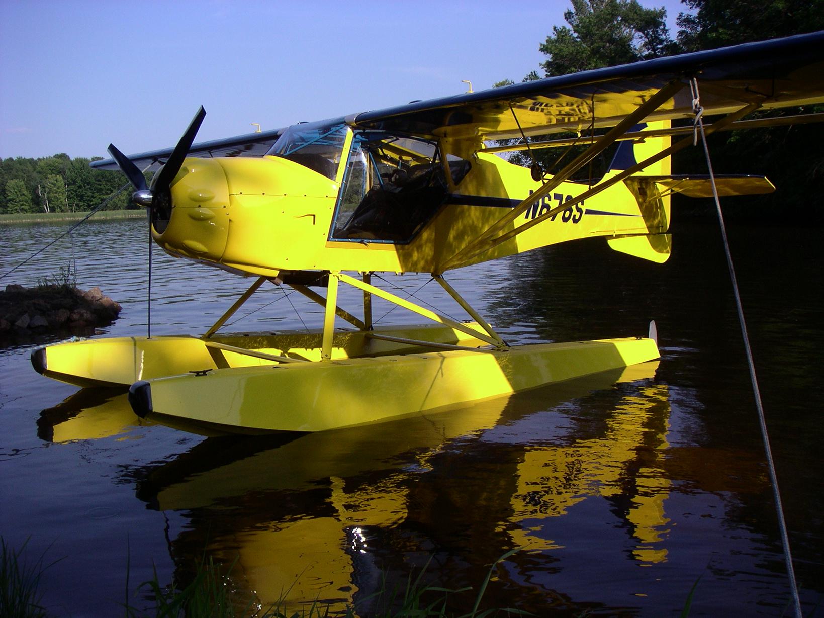

I currently am flying my Kitfox 912ul Model IV on Aerocet 1100 amphibs. It
weighs 630 lbs on wheels and 776 on amphibs. Those floats too have a lot of
issues, with underfloatation being the biggest problem, and a weak landing
gear second. But other than that it is hands down the best handling float
you will ever fly (I can do a 600-800 foot circular one float takeoff!
Yeah, they handle that good...)

I progress with production. The Kitfox is one of my favorite airplanes, so
I hope to set up a Kitfox as one of the first airplanes on my new floats.
Paul Seehafer
ps - did those Avid amphibs not work out for your?

Greg and everybody else; I will be happy to explain more about my new
floats to you when I return. To make a long story short, they will be a
float specifically designed for airplanes like we (me included) like to fly.
So having flown Avids and Kitfoxes (as well as other G.A. aircraft) since
the mid 80's on floats, I know what we need, and what we don't need. And as
I said before, as far as I'm concerned we currently have no good choices out
there (sorry, just my opinion..). But my float will change that. It has
been in development for over a year now, but I'm not just eyeball
engineering things here. I sought out true experts to help me. Running
EAA's AirVenture Seaplane Base, and being around the seaplane crowd for a
quarter century has provided me with many contacts that have an incredible
amount of float operating and building experience, and they were willing to
share their knowledge because we're friends. Combining that expert help
along with my seaplane flying background, and my frustration over not having
a good float choice, I'm convinced will provide guys like us with a
marvelous amphib float. Oh yeah, and I promised myself I'd do all I can to
make it reasonably priced. I remember not too long ago when I had to scrimp
and save to buy my first set of inexpensive floats. So I want to make sure
my float is a real value, and is as affordable as I can make it without
sacrificing quality. Hopefully this will help you all to understand better
where I'm coming from, and why I'm passionate about producing a great float
for our airplanes. (see the pic attached if you want an approximate idea
what my new floats will look like. Will be very similar to that... but
better!)
