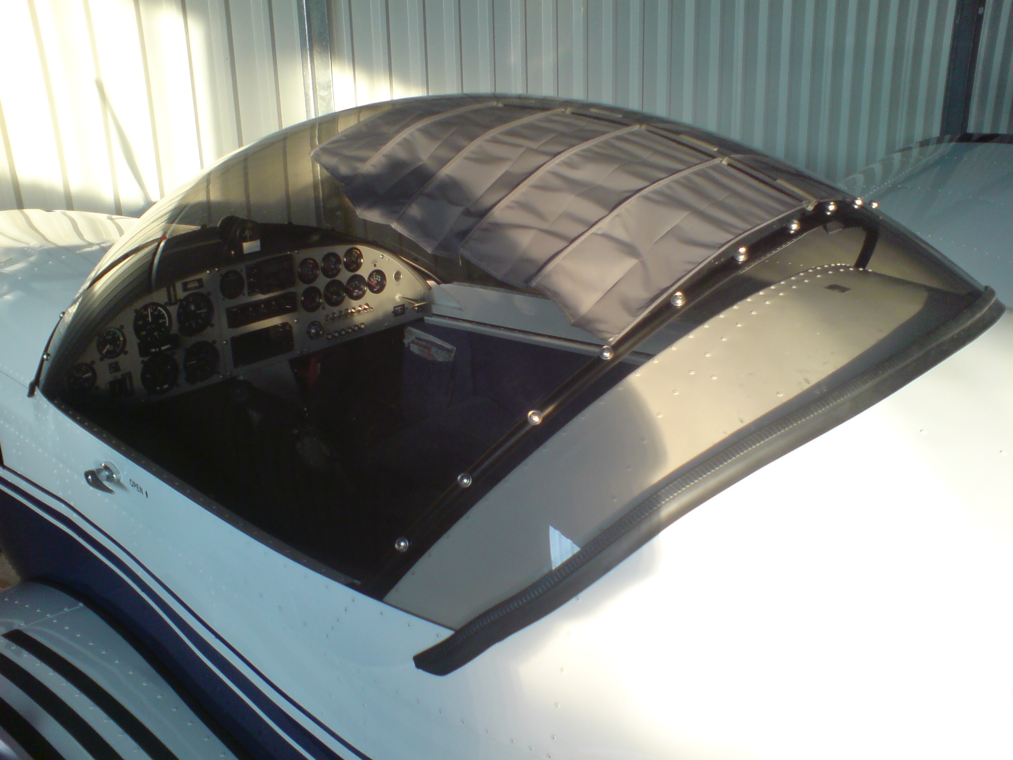

PostPosted: Fri Aug 31, 2007 4:39 am    Post subject: Re: Sunshades revisited Reply with quote
my one is perfect see pic bought from cleveland tools

amyvega2005(at)earthlink.
PostPosted: Fri Aug 31, 2007 7:18 am    Post subject: Sunshades revisited Reply with quote
alex,
how is it stuck on?
alex_01
Joined: 14 Jan 2007
Posts: 33
PostPosted: Fri Aug 31, 2007 9:23 am    Post subject: Re: Sunshades revisited Reply with quote
with a kind of a double side tape short strips (slightl foamy) about 2" long.
was ok but not really strong enought when parked outside in the sun.
i got some more from 3M it is used to stick mirrowglass to the wall on tiles etc.
used over the full lenght and perfect
i bought a 2nd one for my friend here who has my old xl and he had similar problems but now also ok.
